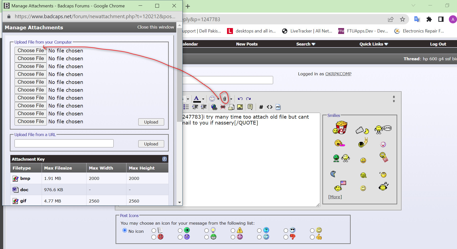

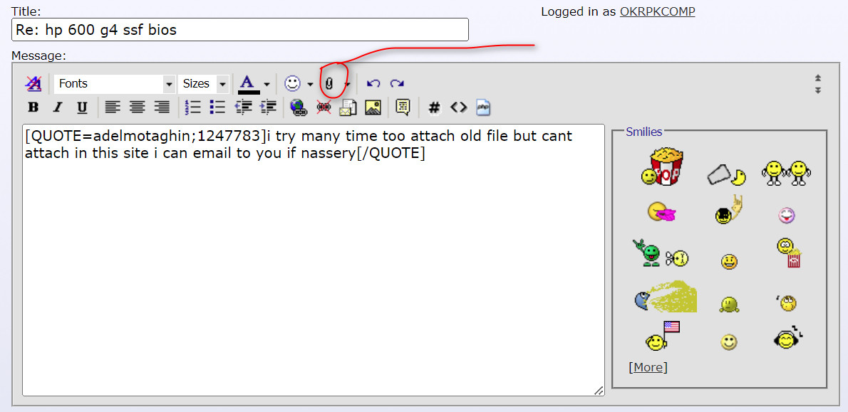

              Re: hp 600 g4 ssf bios
              i try many time too attach old file but cant attach in this site i can email to you if nassery
              • OKRPKCOMP
                • Dec 2020
                • 445
                • PAKISTAN
                • hardware study and study about health
                upload yours old bios from that tab
                  come on man
                  i know how can attach but erorr in every time
                  • hardware1
                    • Sep 2021
                    • 2956
                    • N/A
                    come on man
                    You can't attach the file as .bin file, you must compress it to .RAR or .ZIP file.

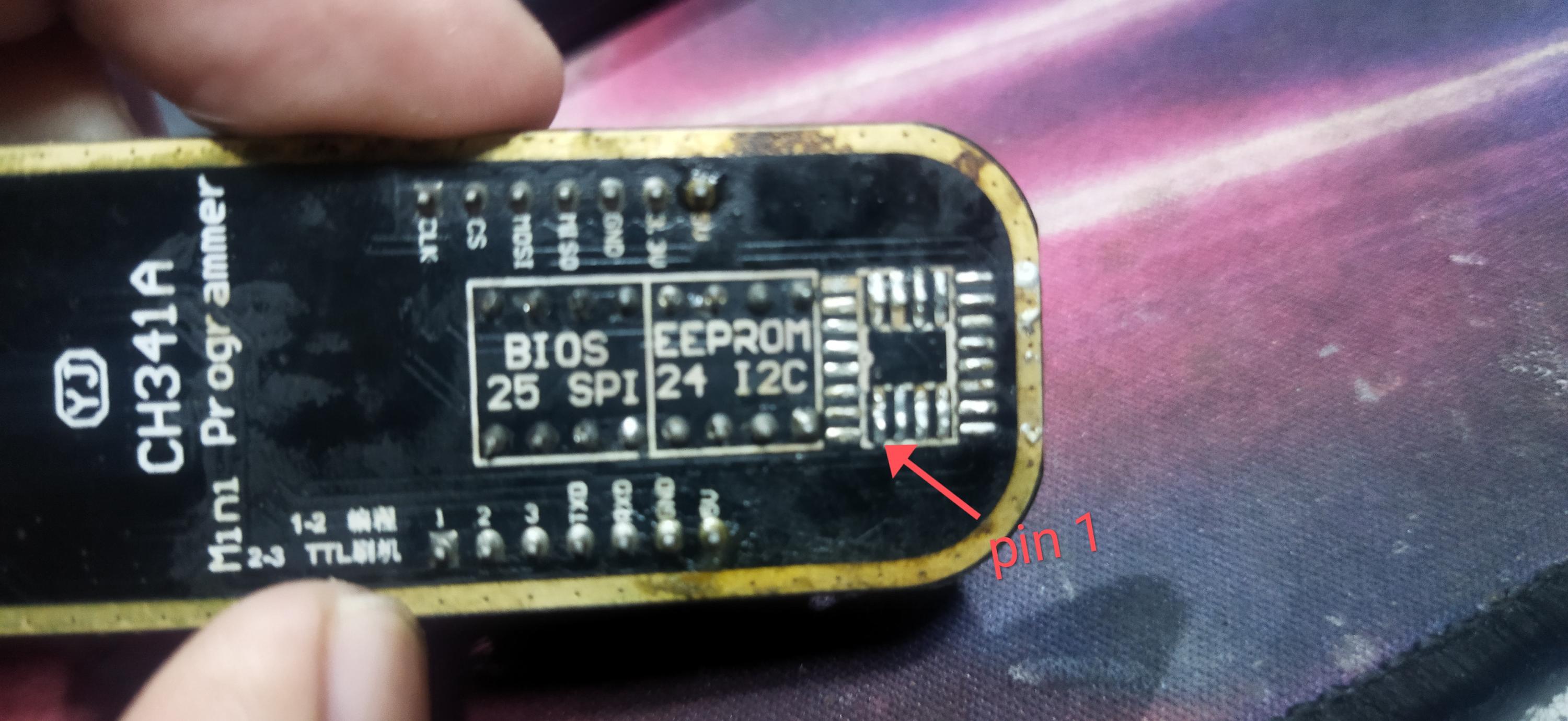

                                  • kulokutoys
                                    • Jun 2010
                                    • 136
                                    • Phillippines
                                    it is better to put the chip underneath the programmer. pic below
