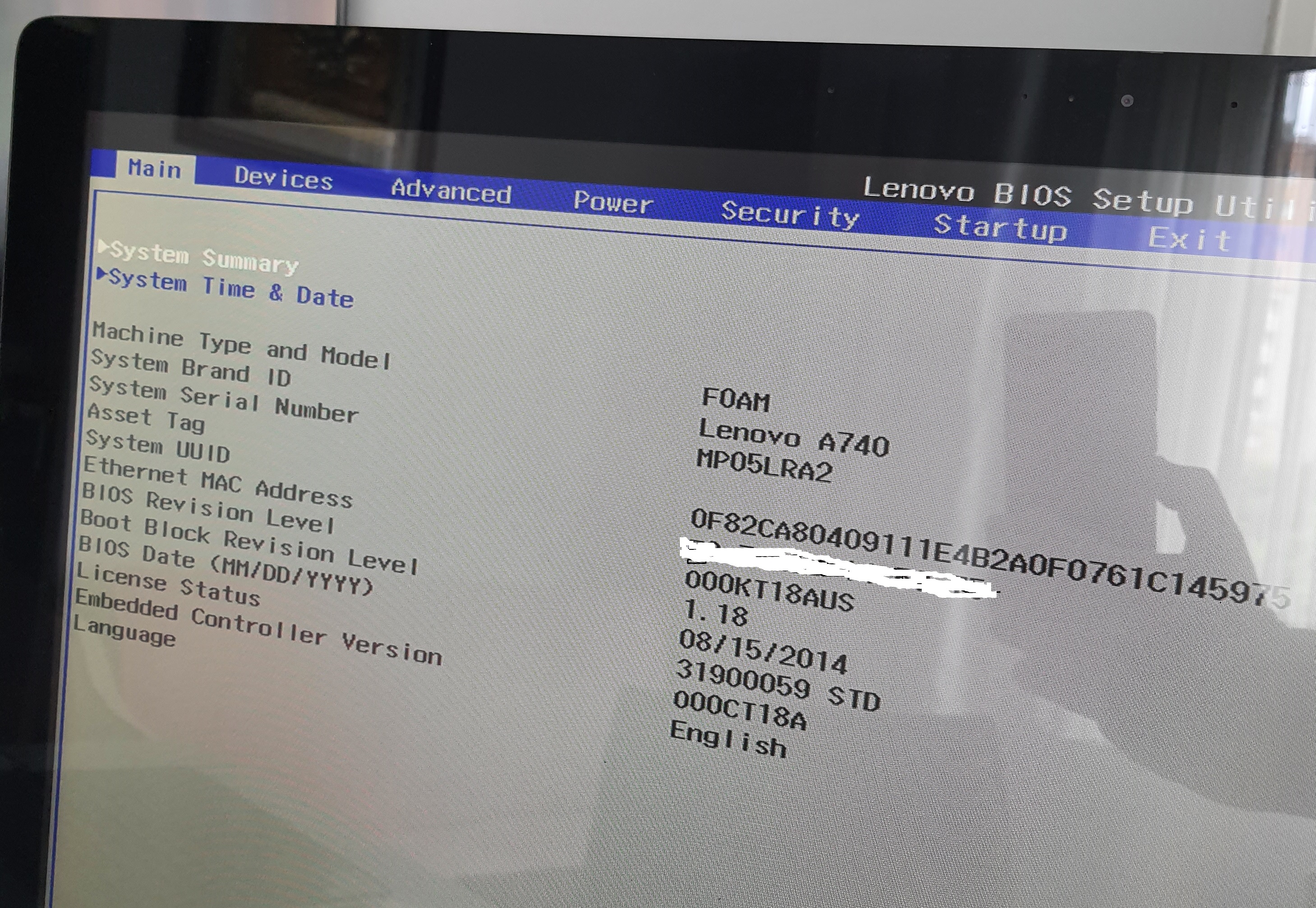

    ZAA50/70 LA-B031P REV 1.0 motherboard has O00KT18AUS bios, I am looking for the bios bin file O00KT20AUS.BIN.
    Thanks in advance

      Re: Lenovo A740 AIO Haswell Motherboard bios
      When I enter the lenovo serial number, it directs me to a bios file that is incompatible with the haswell motherboard, on a bios site there is O00KT20AUS.BIN this bios
          Unfortunately, the label has been removed, all the information is in the bios, only the serial in the bios is written, the machine model appears, there is an explanation in the link
