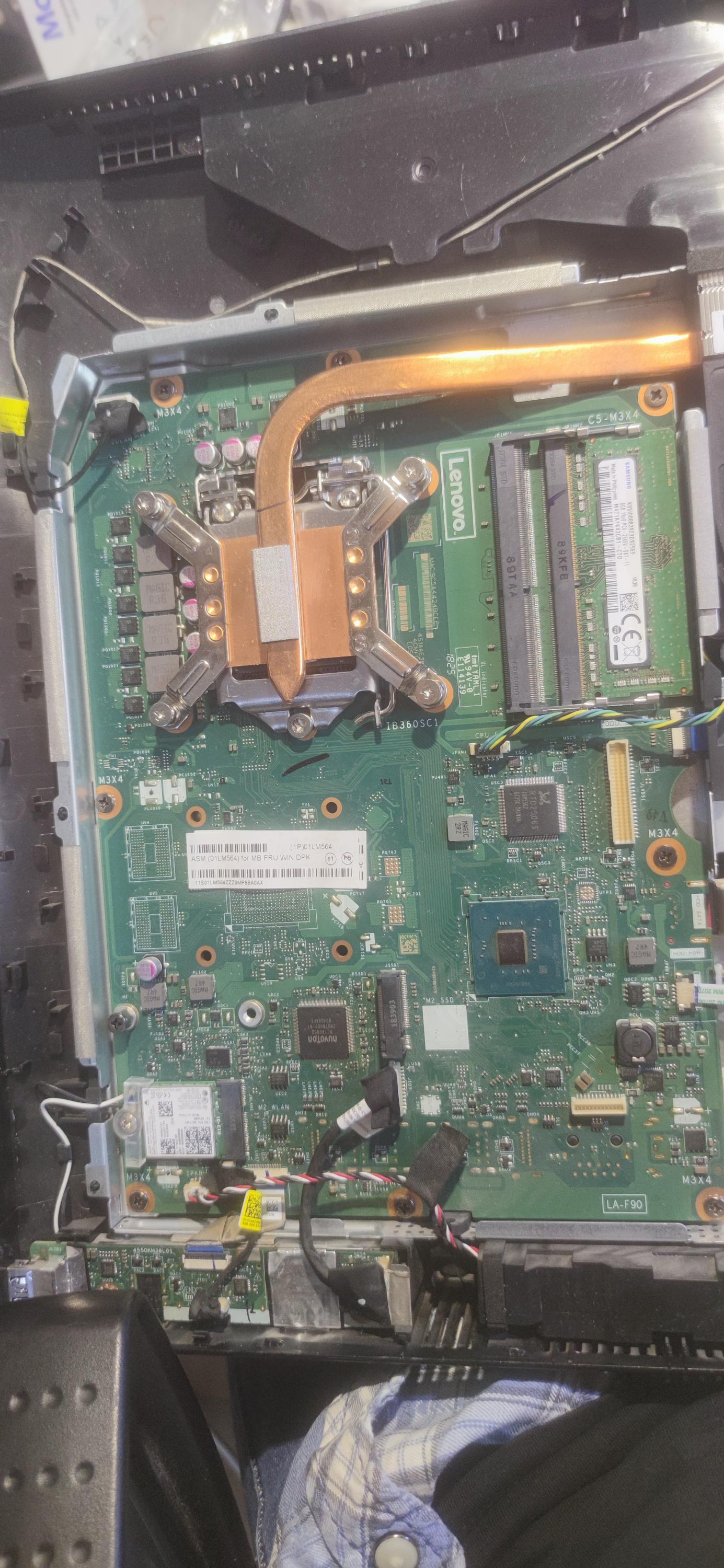

    Hello, Is it possible to have the bios for this machine? v 530-24icb AIO SN: MP1FA1H4 motherboard La-f90 Attached photo, and which one is the bios. Thank you

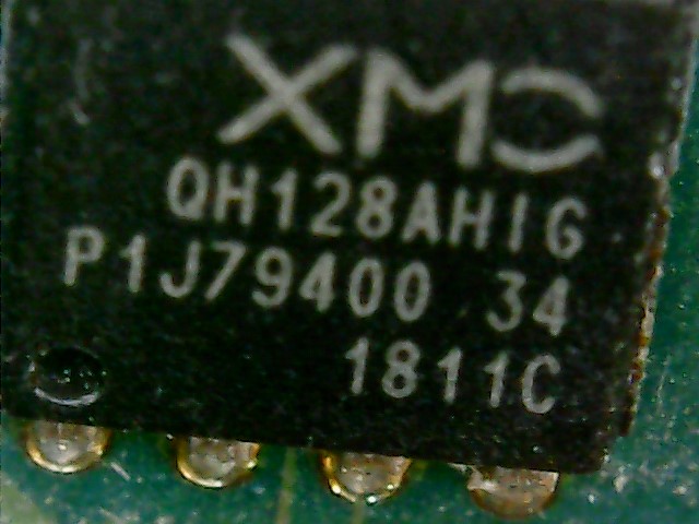

    XMC QH128AH is the BIOS chip. Upload its content here, describe your device problem and someone will try to help you.

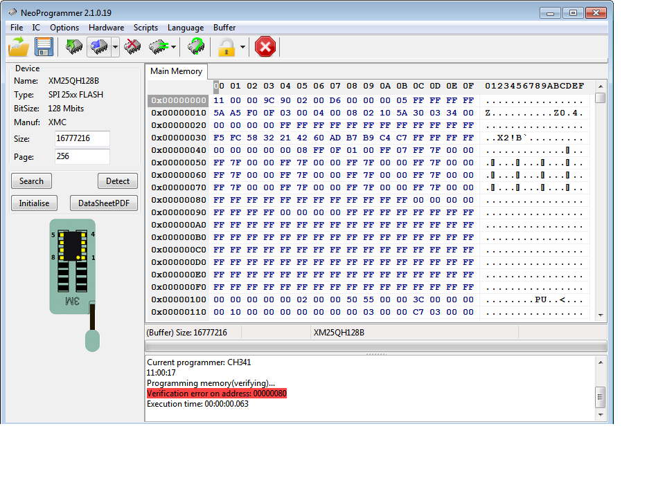

          Re: bios for v530-24icb AIO
          good morning, Thanks for the speed, I tried the file but it gives me this error as in the photo
            deleting the memory, the writing was successful, and the PC starts up correctly. A thousand thanks
