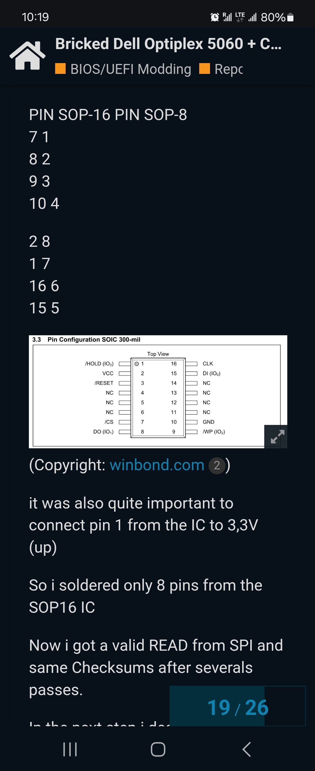

              Finally, I did some research, and it seems I need a programmer to back up my BIOS. The BIOS chip is MX25L25673GHI with 16 pins. I'm not sure which exact programmer and clip I should buy. Can anyone recommend a reliable setup that works well for this chip? And, is it possible to back up the bios just by using Windows OS on the computer directly, because i see various app such as Universal BIOS Backup Toolkit that looks fine. Thanks for your help
                see what programmer your bios chip supports..
                            This chip is shure supported by the RT-809 Programmers. I programmed it with this many times.
                            It seems to be not 100% supported bei the cheap 341-Programmers even with the 3.3V setup. with those programmers i had only problems with this chip.
                            And please check the pinout ! some "standard" 16 to 8 pin adapters delivered with the programmers just not work.
                            i found a post on winraid/levelone which was very helpful.
                            here the mapping 16 to 8 that finally worked for me and those macronix chips.
