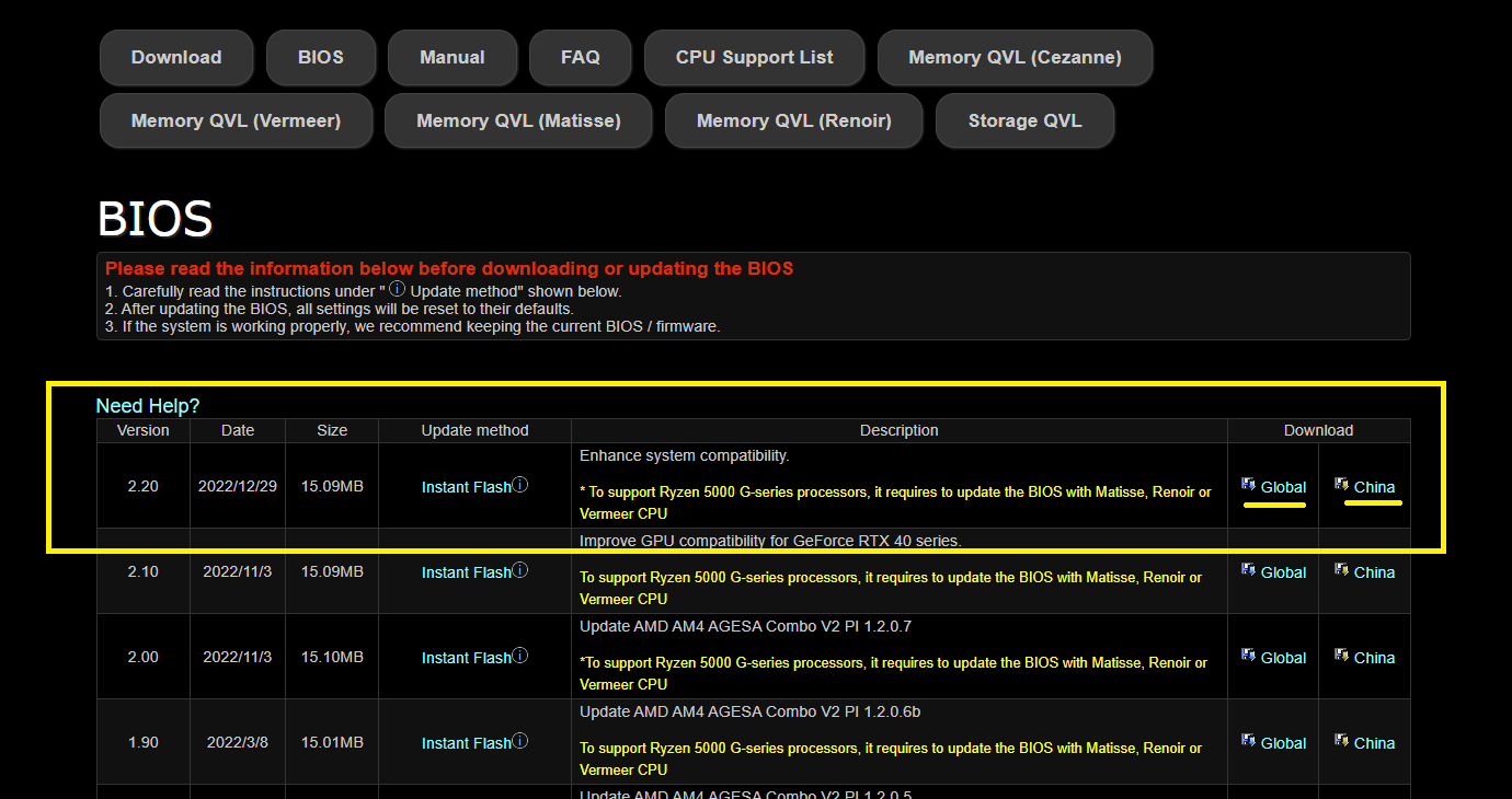

    Re: BIOS NEEDED - ASRock B550M-ITX/AC
    https://www.asrock.com/mb/AMD/B550M-...index.asp#BIOS

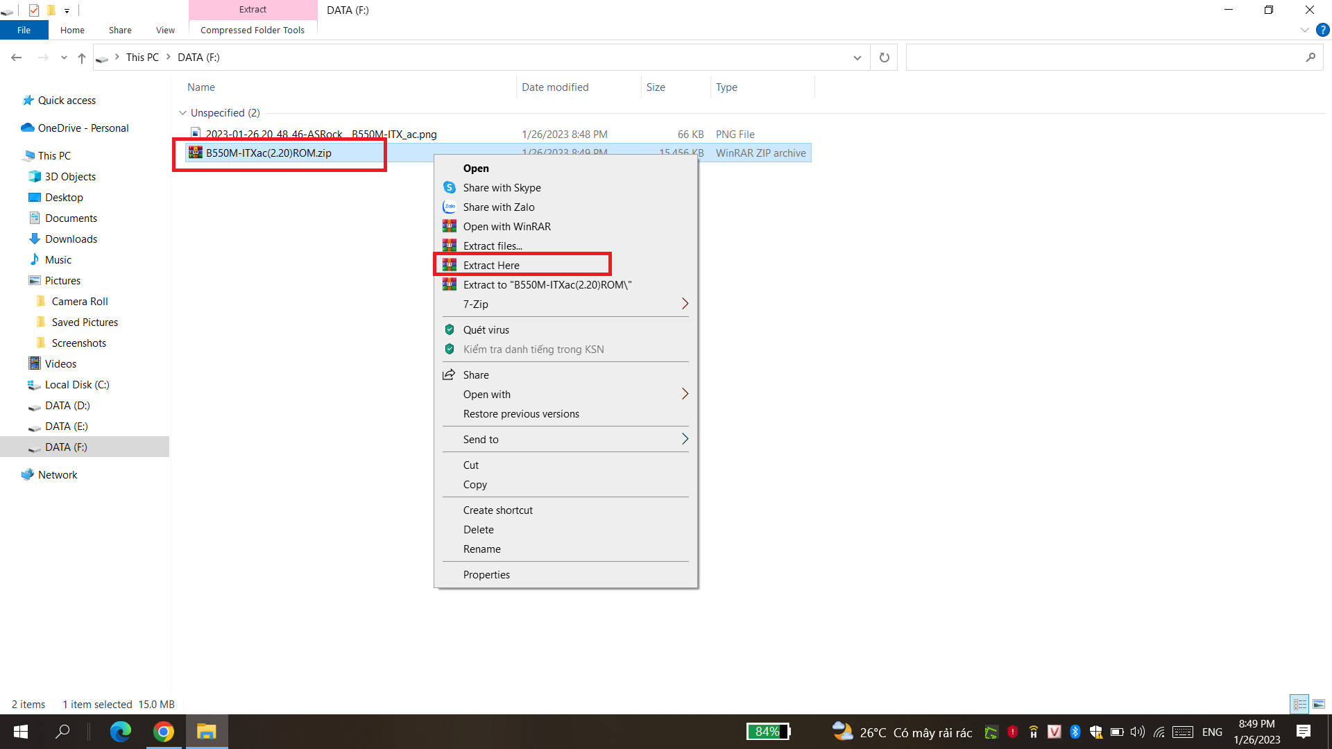

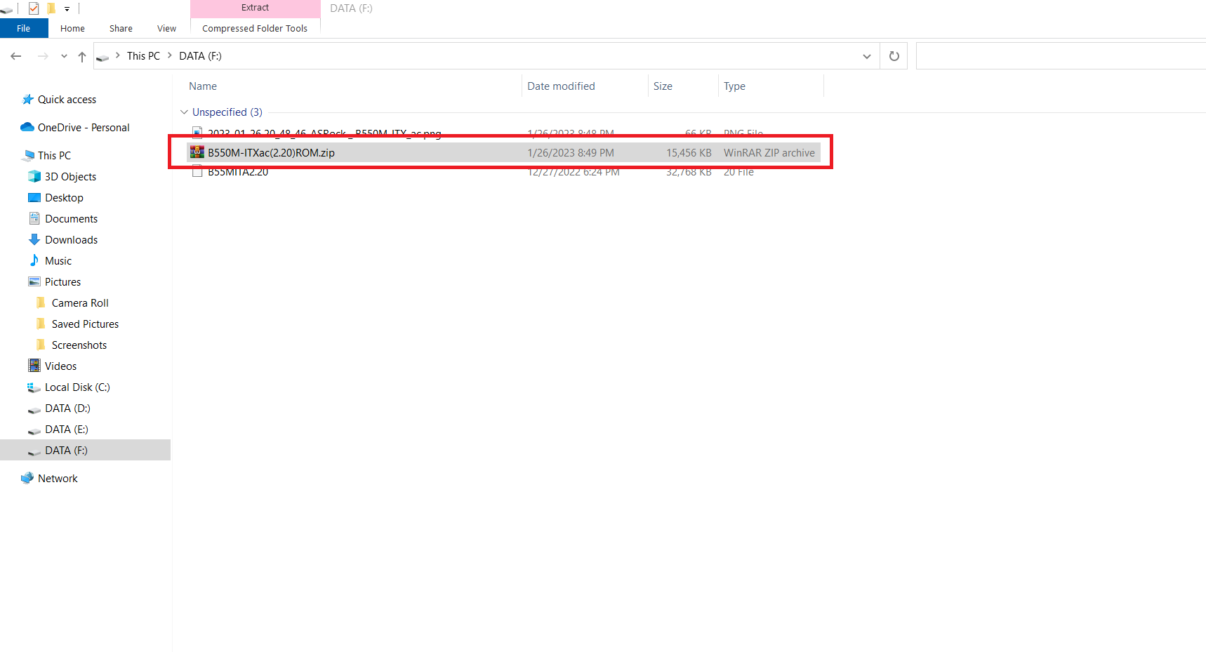

      And then just program it to the Chip ?
      No need to do HexEdit etc etc ?
      • hoaca388
        Badcaps
        • Jan 2022
        • 11225
        • Viet Nam
        Only rename to *.bin.
