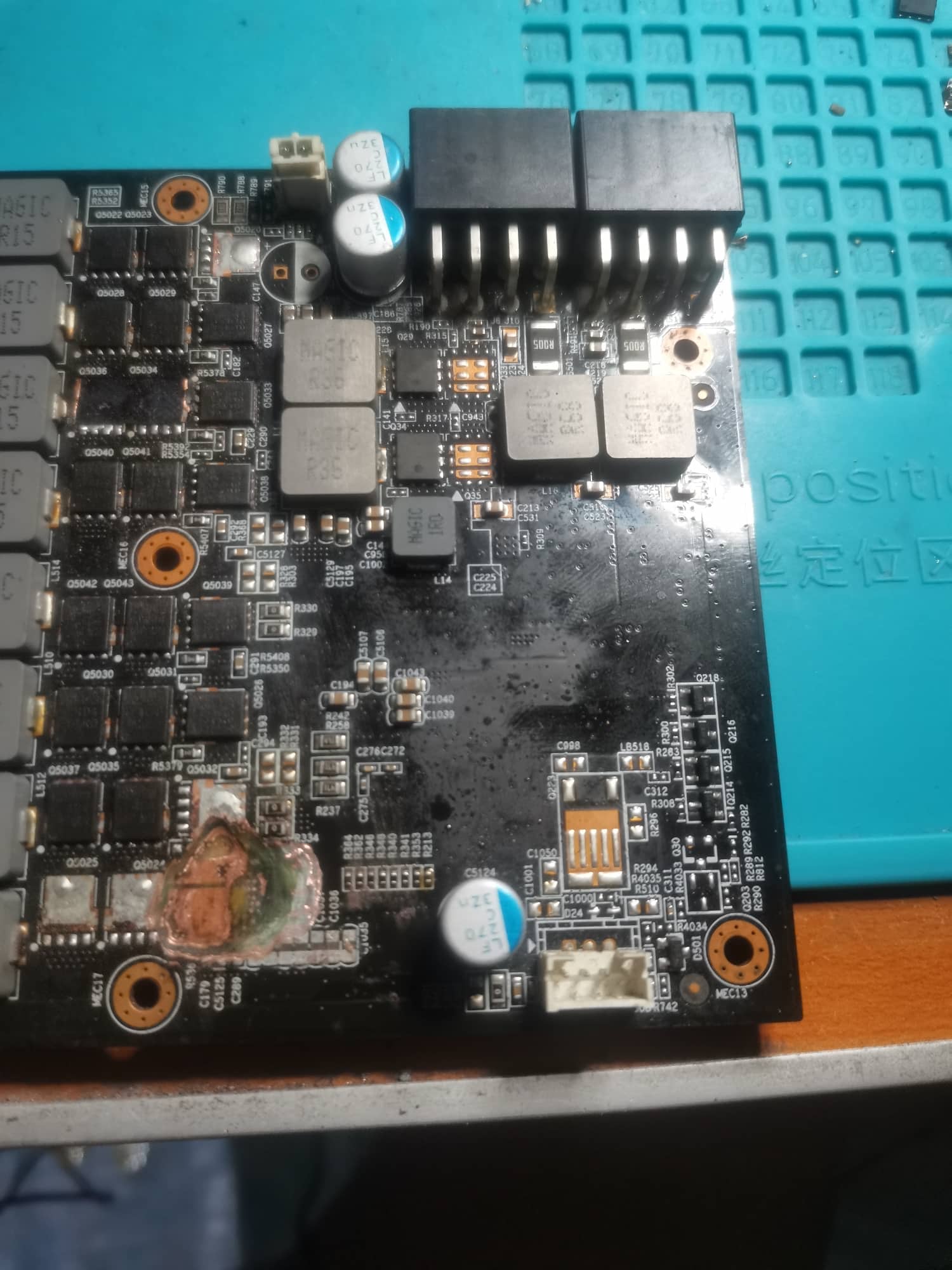

    hi guys can i ask some question.
    i have gtx 980 gigabyte with shorted and burn before on mosfet so i dig it and the short is gone my problem is when i use only 1 8pin connector i got a display and all voltage are present. and the post screen says "PLEASE POWER DOWN AND CONNECT THE PCIe Power cable for this graphic card" and if i use the 2 8pin connector. no display and there is a no voltage on vcore and vram..
    please see this picture
    thanks guys

    still have short. on half of phases. grind further

      boardview?

        remove drivers on the other side
