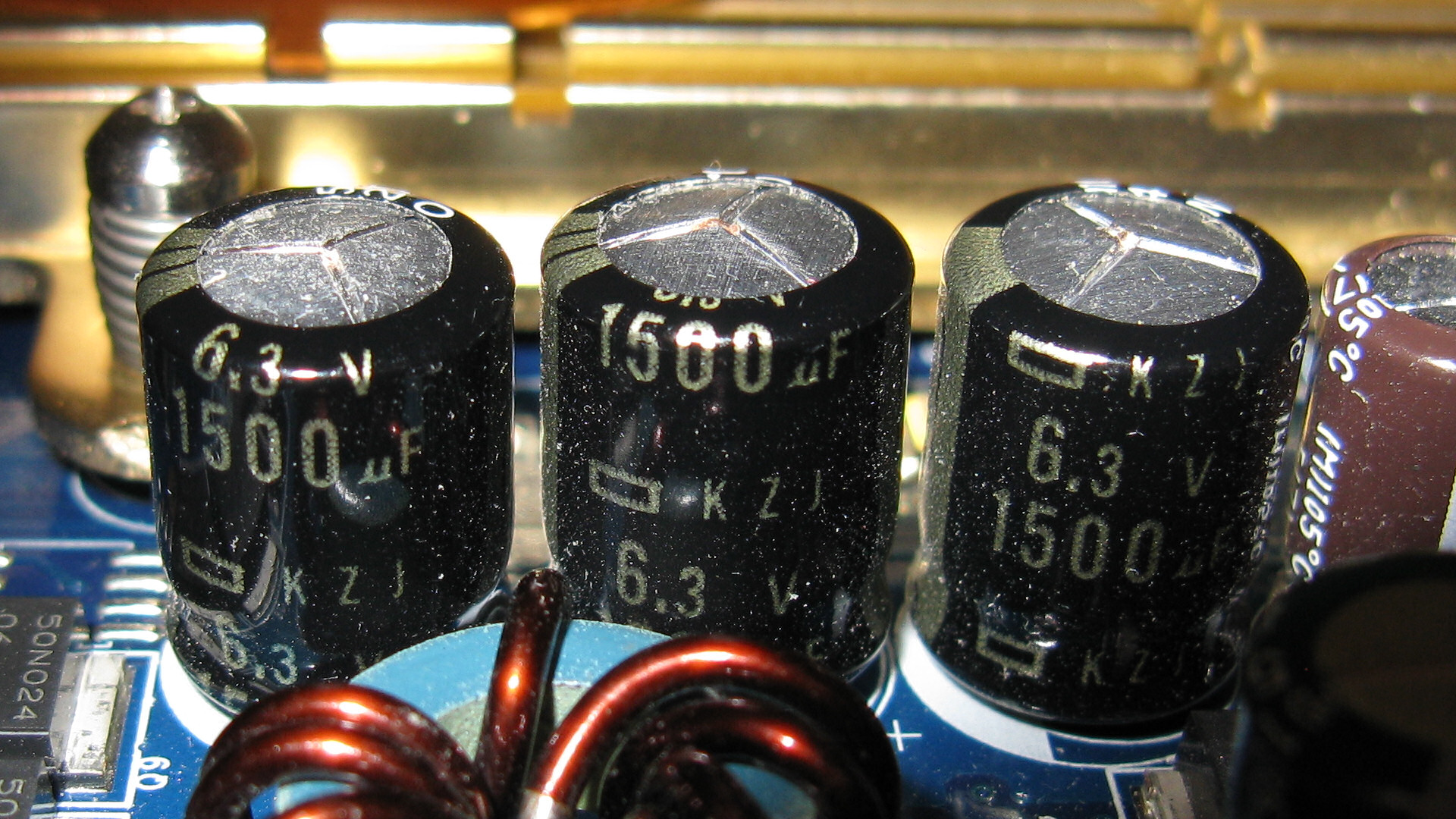

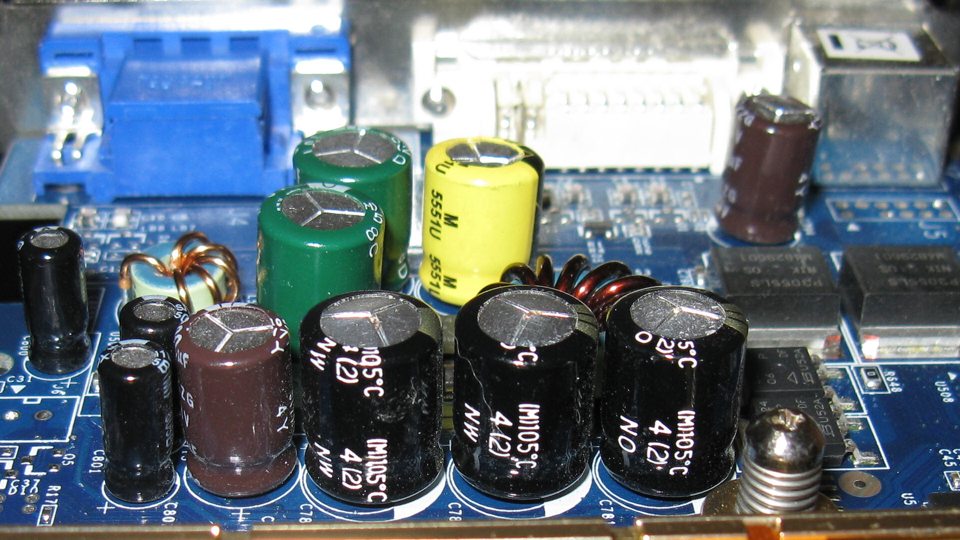

Random crashes started a couple weeks ago, got to a point where the system would black-screen a minute after startup.
Inspecting the video card shows 3 x 1500uF 6.3v KZJ caps are bulging and have a bit of ooze at the top.
Now using a 15 year old PCI VGA card until a replacement is found. Sloooow.
