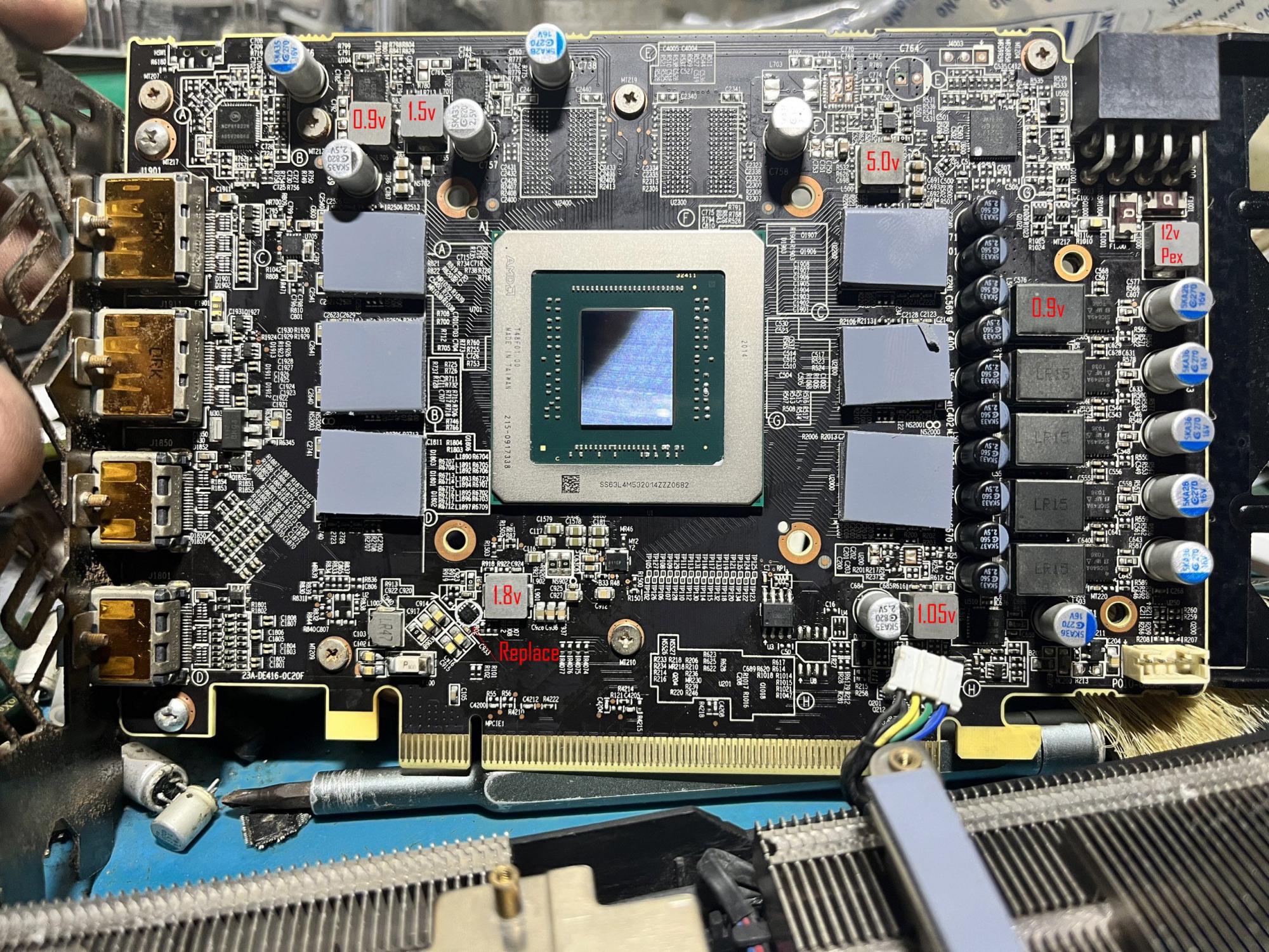

Voltage level on coil of RX5600 XT Sapphire
  • ductranvinh
    • Dec 2021
    • 135
    • Republic of Vietnam
    If u don't have level voltage at some where coil. U Reheat this ic near Coil or Replace ic exactly id.
