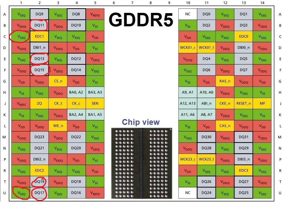

                                It's odd as only 1/2 the bits on the chip are failing MATS test (all bits fail as expected when chip was removed) which indicates more like a faulty ram chip or connections to the gpu than the gpu itself.
                                Found some good info from northwestrepair (good info in his discord too) - relates to Micron memory, but same principles apply to other GDDR5 / GDDR5X chips

                                      Ok, pulled the chip and some very suspect pads (no solder balls on them at all) - very flat dull - see attached image of which pads. Might have found the issue here!
                                      All data lines apart from 2 VSS
