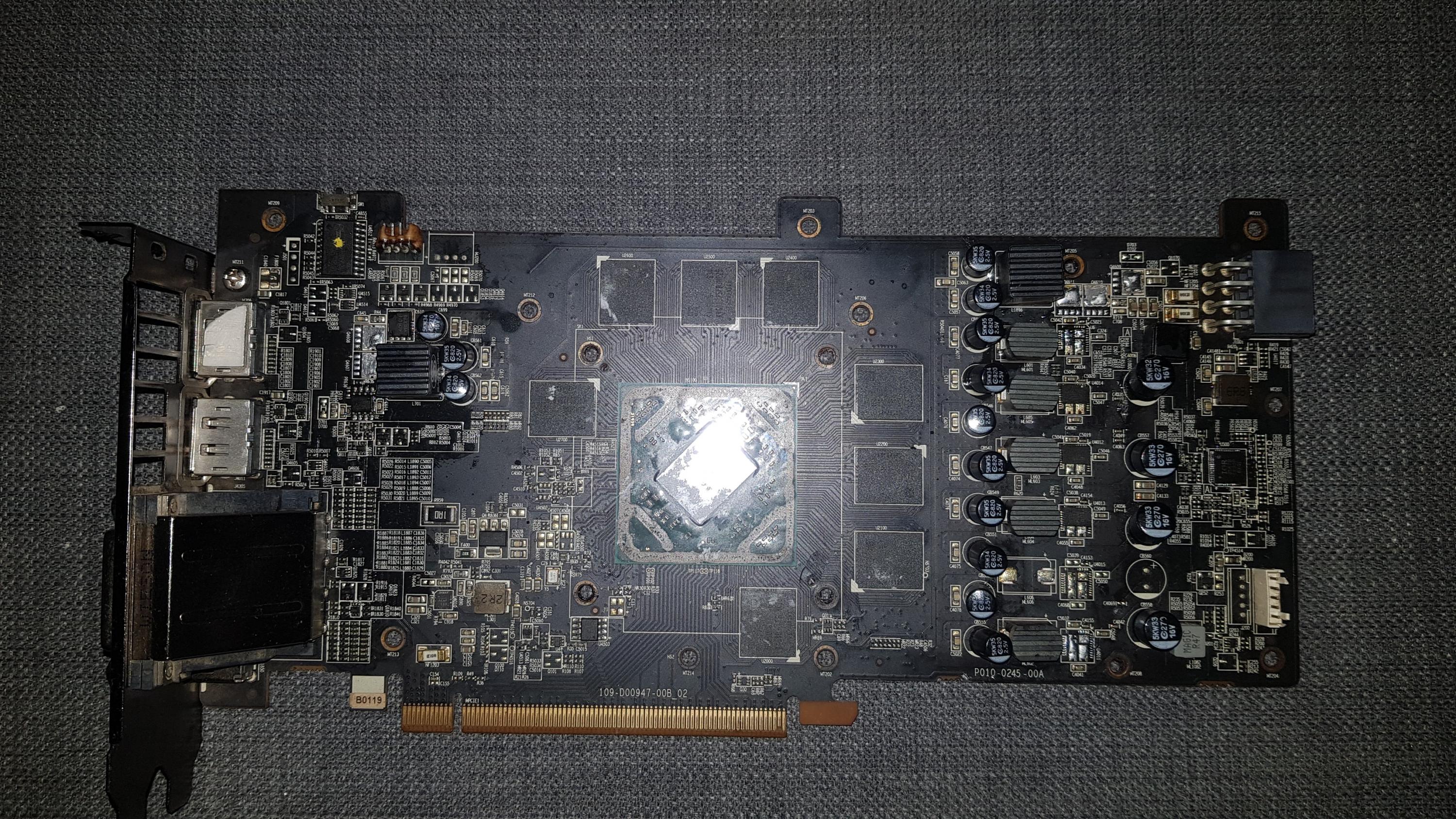

    Hello to all =D
    I would like to start this card again for my little brother.
    Symptoms :
    No power on , no rgb led , black screen , no rotating fan.
    What I found before disassembly a 22uF capacitor on the +VDDCI line was loose. Before powering up and checking if the component was missing, the capacitor was replaced.
    Then powering up

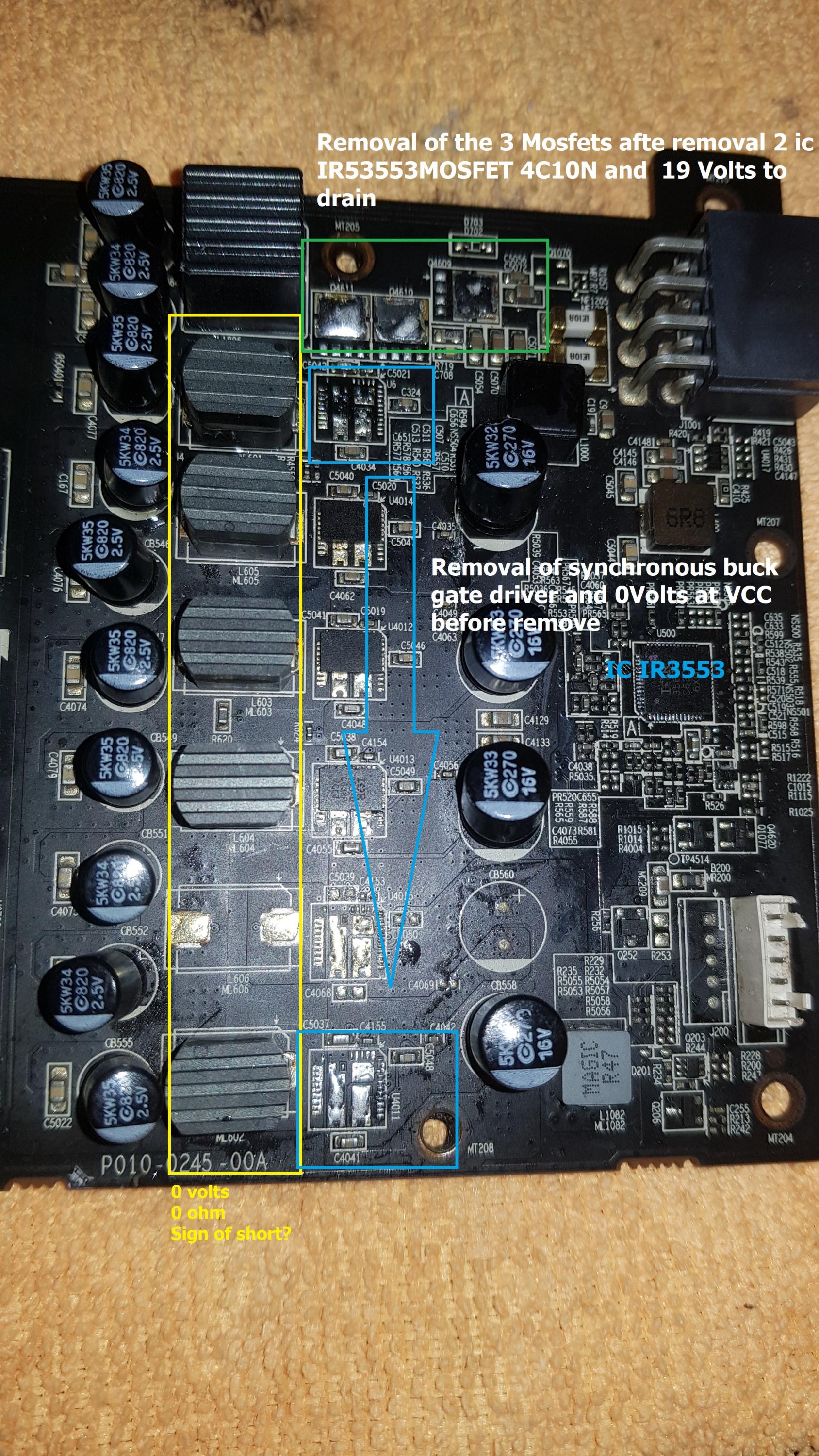

    What I found abnormal :
    -No 0 Volt on the +VDDC line of the CPU, value found 0 Ohm, diode mode 0mv and finally 0 Volts on the whole phase row (Which can be seen in grey metal capsules and I circled in yellow.
    The +VDDC seems to be controlled by the power regulator if I am not mistaken.
    What I did:
    1) Removed the synchronous buck gate (IR3553 chip) driver phase 6 and phase 1 and still 0ohm and diode mode 0.01 mV on the phases
    2) Removed then one by one the 4C10N mosfets but before removing everything I found 12 Volts drain on each but still 0 Ohm on the phases.
    Can you look at the diagram I am attaching on page 15 of 26 all the phase lines and the +vddc line and I am attaching the other photos for your convenience.
    and the Buck controller datasheet
    To tell the truth, I may be going the wrong way, no?
    Thank you very much in advance team =D =D

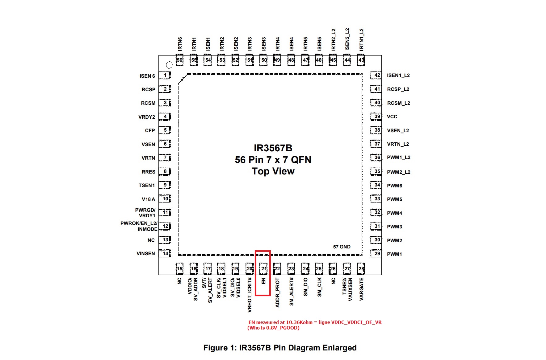

    It's normal for vcore vddc to be 0 ohms. The only way to test that is with voltage injection. If it draws more than 5A at 0.8V, the core is probably shorted.
    Don't worry about that, though.
    If a MOSFET is bad, it shows up as a short on the 12V rails.
    You'll want to check enable on the vddc controller. If you don't have EN, then trace that back to it's source. You can also check resistance and voltage on perst_buf. It should have 3.3V and nearly oL resistance.

          I injected 0.8 V at +VDDC and consumed 2.40 Ampere and as you said if the core is shorted it should overconsume then about 5 A and nothing heats up on the thermal camera.
          In addition I measured in Ohm to rectify what I said above, I am at 00.4Ohm (Same value when I touch the red and ground on my voltmeter) =S
          For the mosfet IR3550 on VIN on phase 1 to 5 = 0.670Kohm and VIN phase 6 (Located the lowest) measured at 6.01 Komh it seems to me quite high compared to others.perhaps following my withdrawal.
          A VCC = measured all phases at 14Kohm

          I can't find what you indicate =D (prest_buf) , do you mean I have to check on the buck controller IR3567B on ENABLE line 21?.
          What I get is 10.36 Kohm and seems to be VDDC_VDDCI_OE_VR which is the 0.8V_PGOOD
          The 0.8V_PGOOD goes to the GS9238-ATQ chip what should I measure on it?
          Am I doing it wrong?

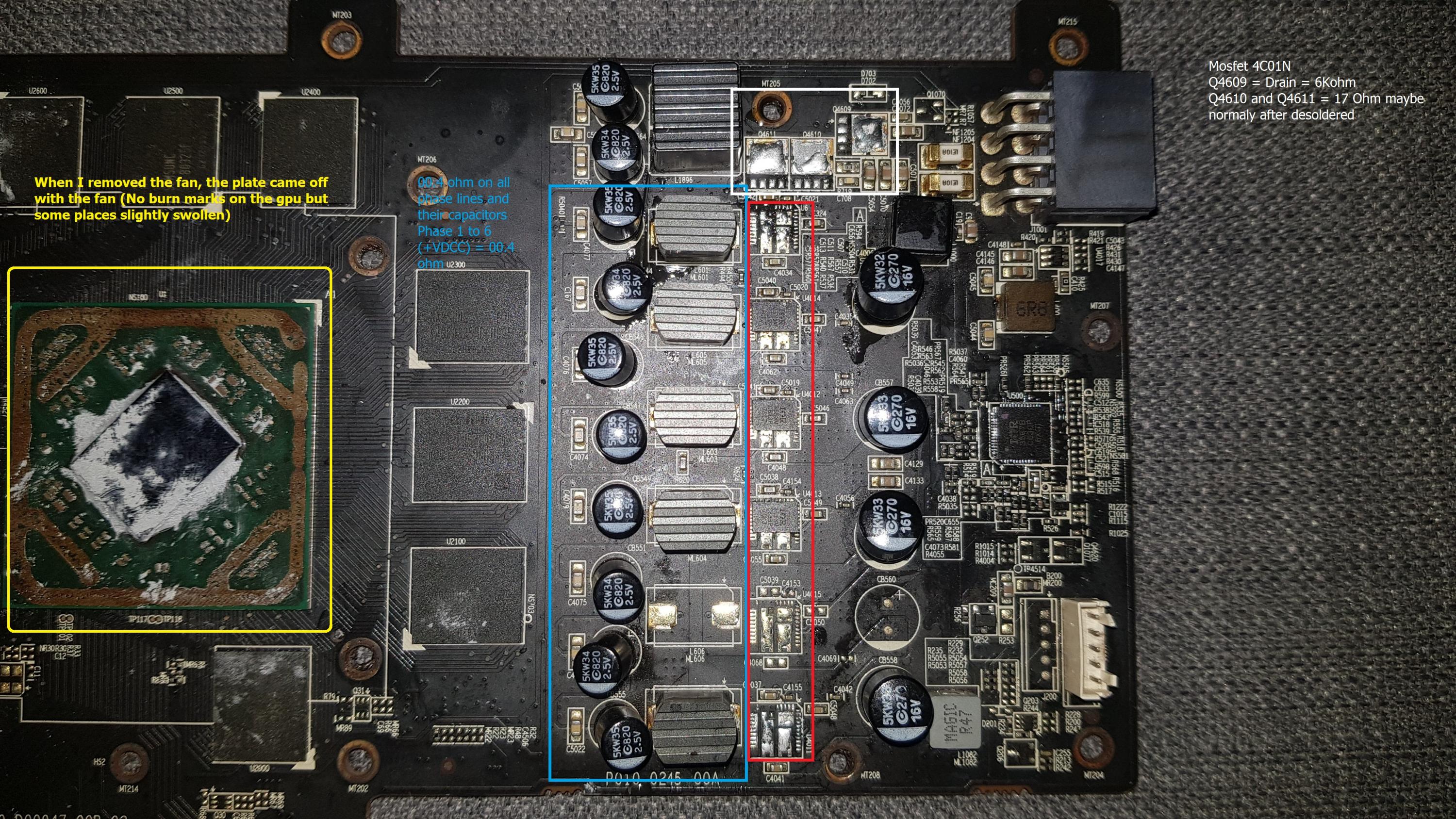

          IN VCC = 0.410kOhm measured (I think I saw 3.3 Volts before removing the mosfets)
          The mosfets 4C01N (which are circled in white and removed) the Q4609 on drain = 6Kohm
          Q4610 AND Q4611 = 17 Ohm
          SEE THE PICTURES TO UNDERSTAND BETTER
          Sorry if I don't know the terms, I'm a beginner since 1 month =D

              For information no short circuit on the VIN of IR3553 but on SW which has two mosfets internally I still fall to 0.06 Ohm despite removal of all controllers and obviously to the coils
              At the end of the video you insist on the subject of PCI-Express not short circuit.
              For the moment I do not know yet where is the problem =S
