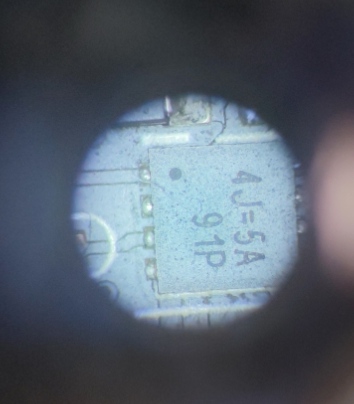

    I need top know which Mosfet driver i must buy for this Asus RX 570 Graphics Card.
    The Asus Part Number: 4J=5A 91P
  • dicky96
    Sun Seeker
    • Mar 2017
    • 1825
    • Spain
    Re: Asus RX570 - component
    It's a Richtek device. 4J is the SMD code that should relate to the part number, the other letters/numbers are a date code
    But I wasn't able to find the part number for Richtek code 4J so far

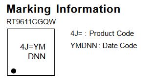

      Could be this one rich RT9611CGQW https://cdn.badcaps-static.com/pdfs/...0d9f034a6c.pdf
        thx,.code 4J=5A 91Q
