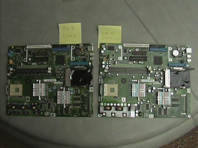

              I posted somewhere that this is my favored machine and it's back.
              I tried to get these pictures to show the new and improved motherboard next to badcap motherboard.
              Here's the thing, I was careful to match the correct replacement parteven down to the rev number, but they are different, in a good way.
              This new board has a big heat sink covering the mossy area,(greener part of board) so the fets and the caps will stay cool. One more added piece is the heat shield over the two caps that popped.
              I'm sorry my pictures aren't great but I have to agree I'm also not happy working on my own stuff.

              • willawake
                Super Modulator
                • Nov 2003
                • 8457
                • Greece
                Re: Gateway Profile
                omg that is a wierd board. can you post a pic of one board at 800px width?

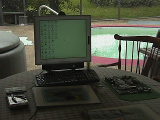

                  These are wierd. It's the all in one Profile 4.5.
                  My picture taking skill sucks but here's the machine up working again.
