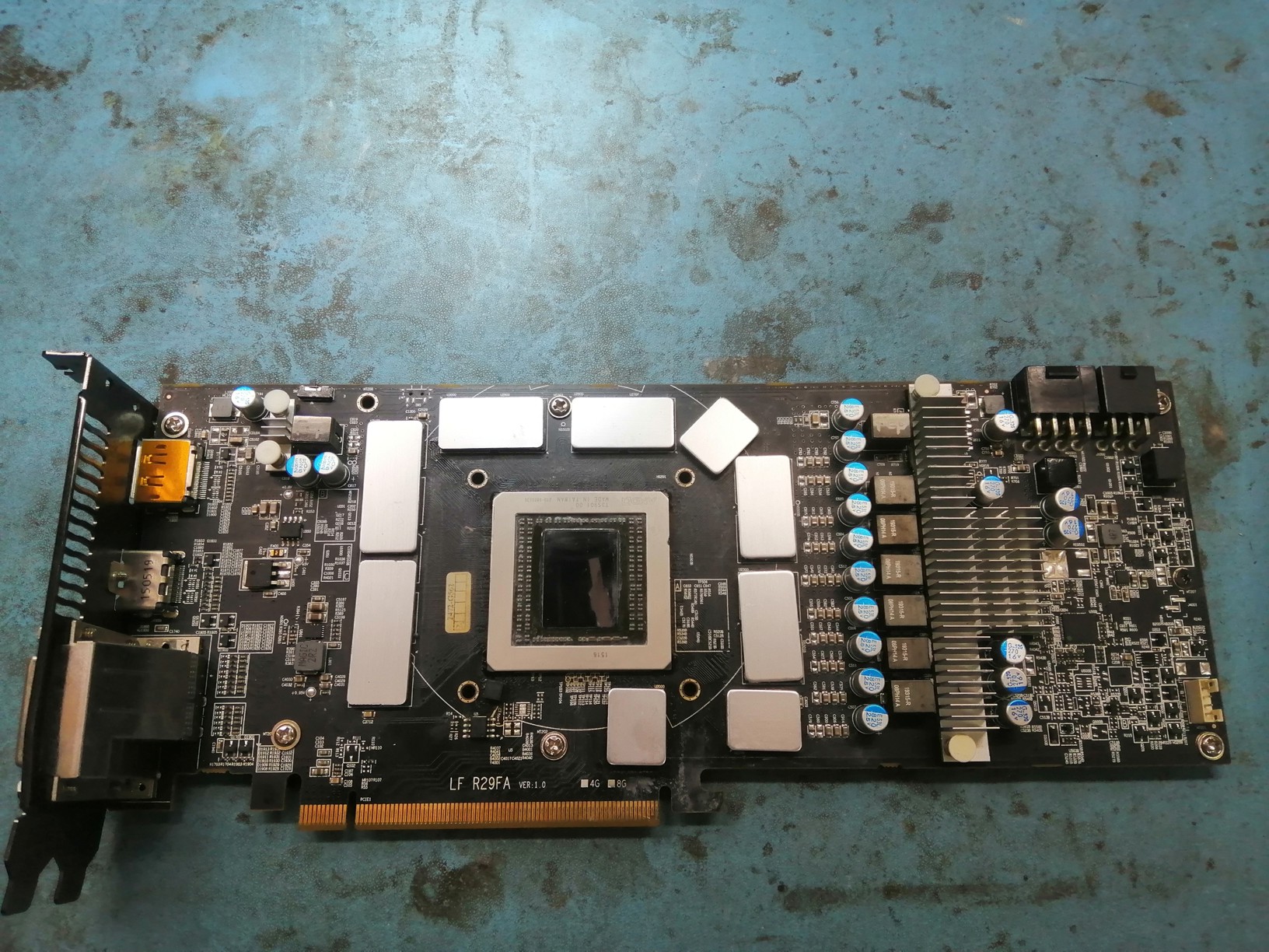

    Hi guys
    I have a R9 390 here. The owner sent it to me with a smd 1AM transistor (one leg broken off) taped to the heatsink
    He says he bought this used as 'working' on ebay, put it on one side for about a year (never tested it) and when he came to use it, it does not work
    He then spotted the broken transistor in the bottom of the box
    At this time it was much too late to return it

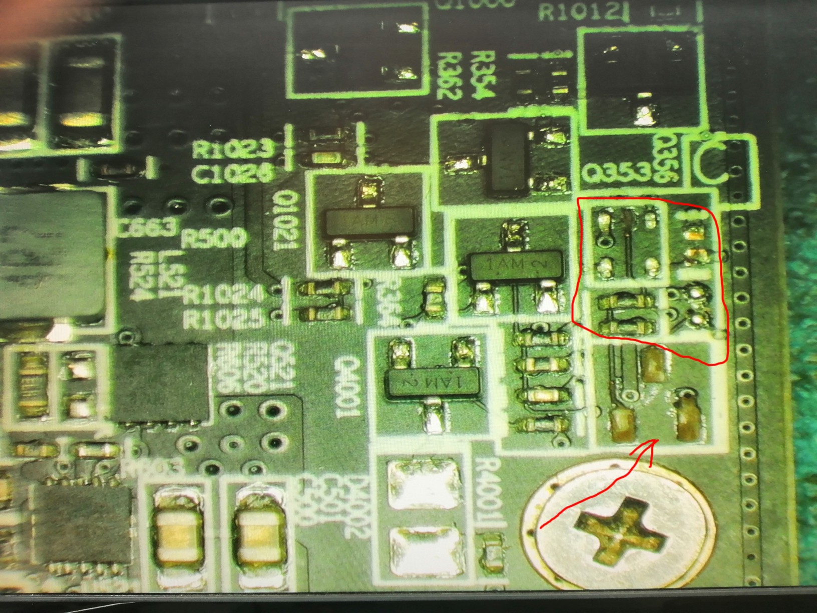

    He sent me some pics where he says the transistor comes from (not sure how he knows for sure).
    Under the microscope it does look like some transistor pads are missing here, but it also looks lie a couple other parts may have been desoldered. Does anyone know what parts should be here?
    See pics
    Cheers

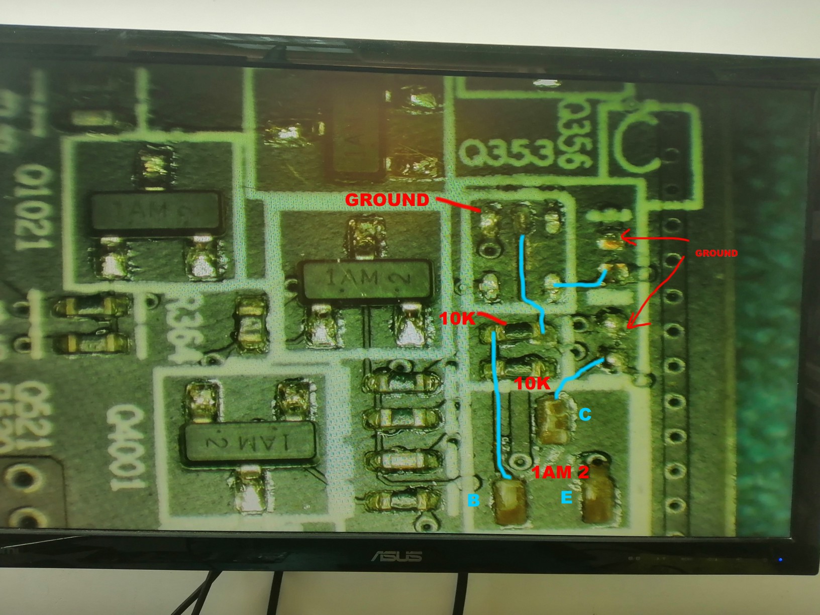

    I'm trying to identify these broken or missing parts
    It appears that the pads have been ripped off the board where the '1AM 2' transistor supposedly came from. The actual transistor has one leg broken off
    If I have the correct datasheet then this is an NPN SOT23 transistor and the middle leg is the collector
    https://pdf1.alldatasheet.es/datashe...ICTEK/1AM.html
    That pad goes to one of the missing components and the other end of this connects to ground. So I assume that must be a capacitor as I don't see any point to connect the collector of an NPN transistor to ground via a resistor. I also assume the collector pad connects somewhere else as well
    There appears to be a 5 pin device missing but the pad layout does not look correct for a SOT23-5 device. I can see there is another 'missing' component also connecting from one of the 5 pins to ground - this actually looks to be a broken off component. The other end also goes to ground so I am guessing capacitor
    One of the pins of this 5 pin device goes to the base of the missing '1AM 2' via a 10K resistor and this forms a voltage divider by the looks of it with another 10K resistor but I am not sure where the other end of that one goes
    See pic - it will explain this much clearer.
    It seems to me if I could know what the 5 pin device is, the datasheet would probably help and I could reconstruct this circuit using a couple of capacitors plus the 1AM 2
    I'm trying my best to help myself here - but can anyone give me a hand with this?
    Much appreciated
    Richard
