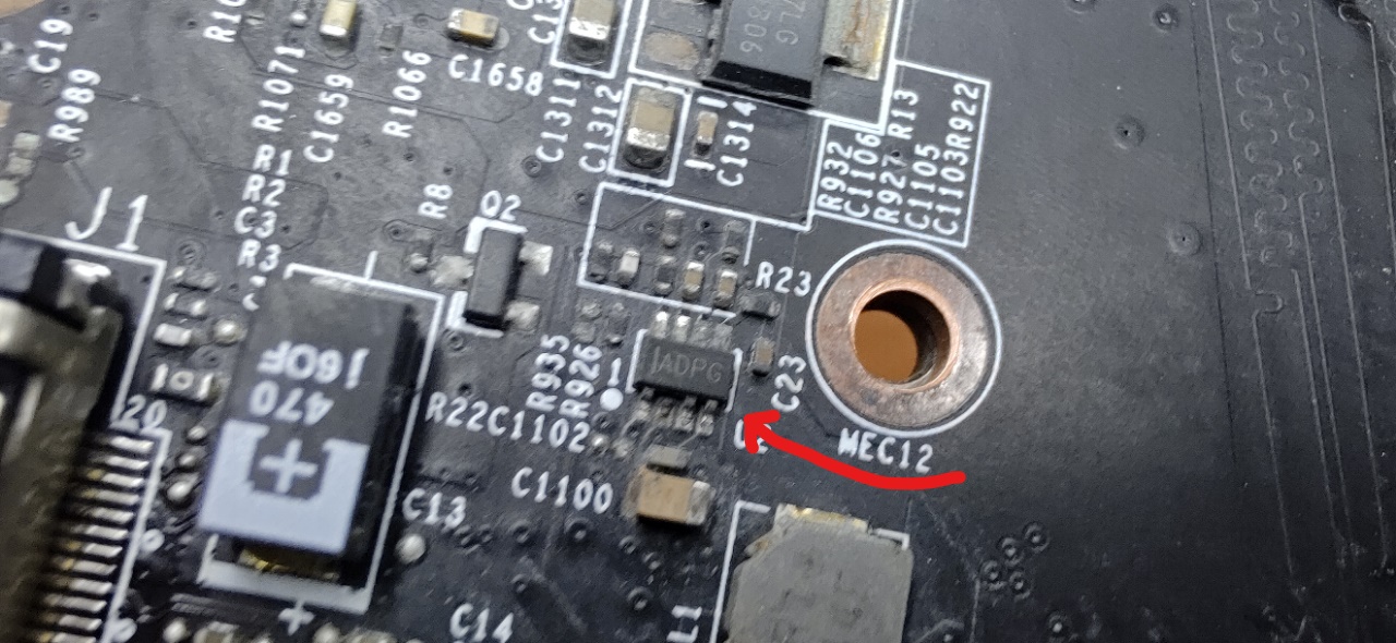

    Hi gents,
    so i recovered a liquide damaged GPU (MSI 1070 Gaaming X) i try to fix it,
    the corrosion is so bad that it ate some component's pads.

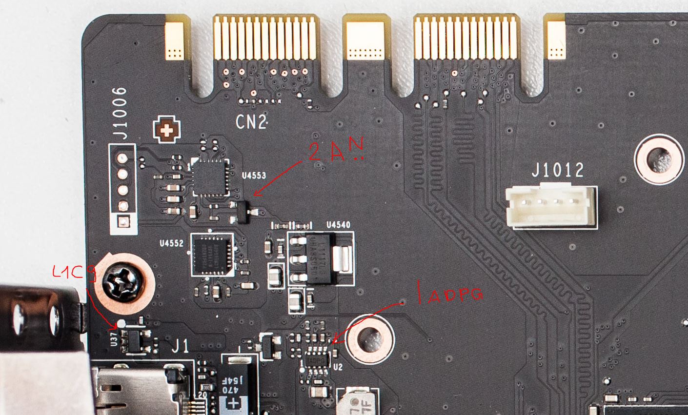

    some are easy identifiable, others are not, from a similaire Boardview (Msi 1080GTX attached) I got some info:

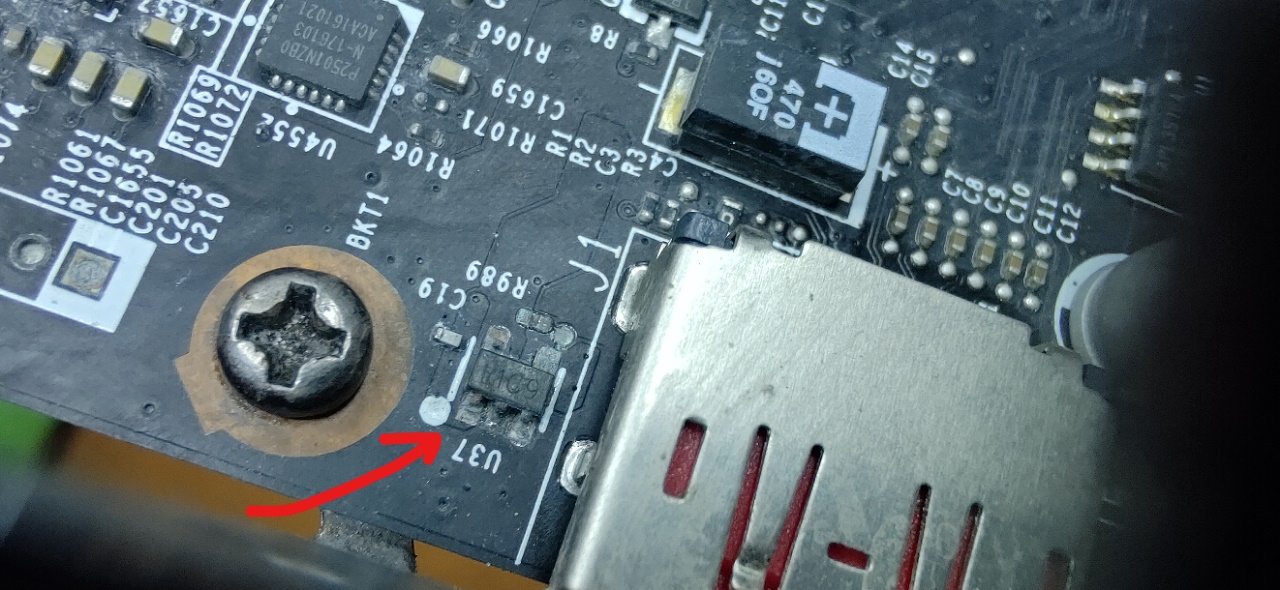

    1-in boardview the component is named SOT23-5 no other info:
    from the pic we can see marking L1C9.
    no datasheet available and I cant find where to purchase it, What other Ref can I use instead.

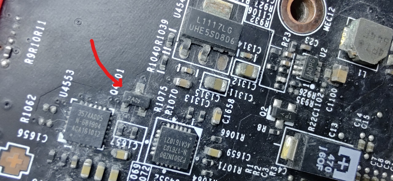

    2-not available in the boardview but i guess its Sot23 (marking 2A. and N symbole)
    same no datasheet no info where to get it or something similaire.
    you can see in the pic also the component L1117LG which i found it easily in aliexpress.
    3- in boardview the componant is named 0.807v a quick googling gave me Sot23-8 :
    marking ADPG also no info where to get it.
    so any idea with what component i can use instead ?
    the MSI 1080 boardveiw
    PS: a high res of the PCB pic

      • 21029
      Re: Help identification component on water damaged GPU
      The part marked ADPG has a vertical bar on the left, it a Monlithic Power part - https://www.badcaps.net/forum/showpo...85&postcount=3 .The last digit is a year code,so the part number is ADP
      Heres the datasheet https://www.monolithicpower.com/en/d...ocument_id/342 MP1475DJ
        Thx
        1/3 found 2 remaining :p
          • 21029
          Re: Help identification component on water damaged MSI 1070 Gaming X GPU
          The 1st one L1C9 is an Anpec APL3511A B .The C means 1A/Active High,the 9 is a date code
          https://www.aliexpress.com/item/4000412659922.html
          2 down 1 to go
            • 21029
            I think the part marked 2A is an ON Semi MMBT3906 ,although i`m not 100% sure
            https://cdn.badcaps-static.com/pdfs/...7d924bb6f9.pdf
              Mr SMDFlea, you re just amazing, thx man i will go with those.
              3/3 down
