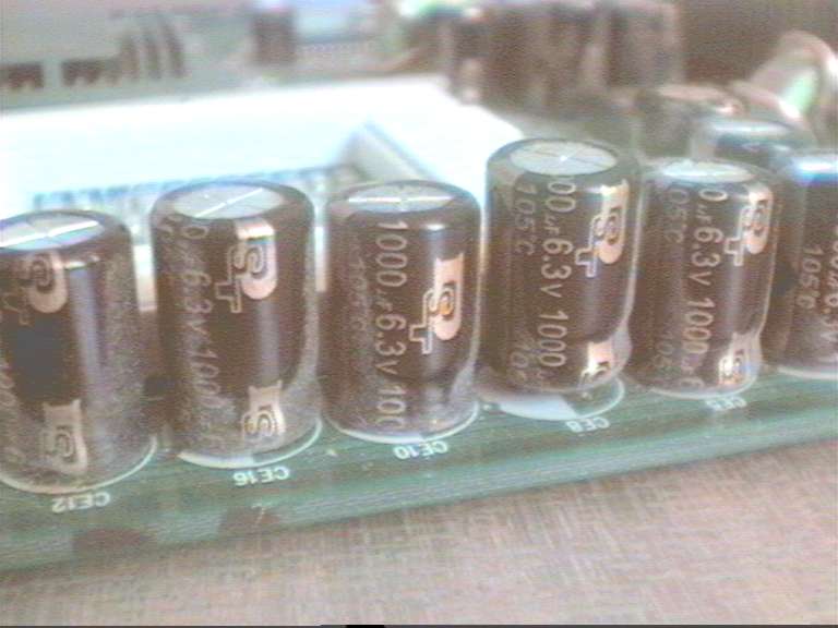

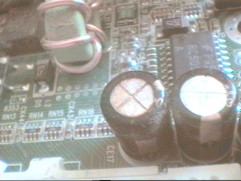

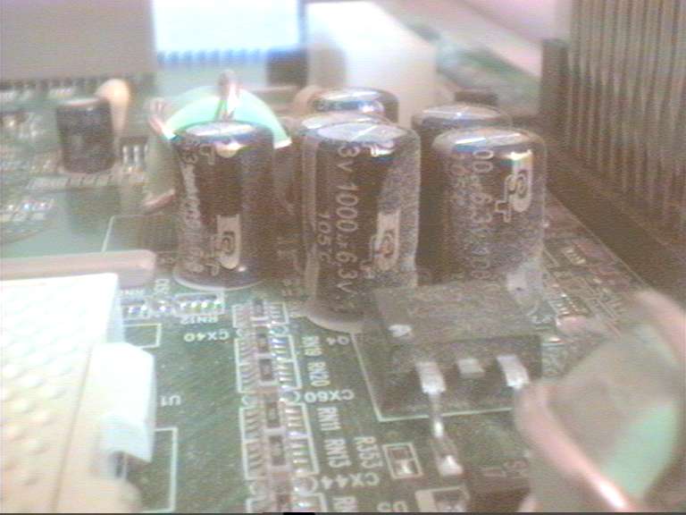

    QDI ZillioX 9
    My "favorite" brand caps - DST. They don't bulge on top, just leak from the bottom.
    BTW. The v2.0 BETA BIOS from QDI is piece of crap - it boots only on second attempt. The v1.2 boots fine, although it's crap too. ACPI is totally messed up (the board turns off randomly), supports HDDs only up to 32GB and it can't be patched.
    I've also done a Coppermine mod (connected AH4 (RESET#) and X4 (RESET2#) pins on the CPU socket). Celeron 600 runs fine but BIOS shows Pentium III Xeon 598MHz

    Re: QDI ZillioX 9
    You'd like IQ and Choyo caps. they also just squirt out the bottom. I have some photos of them on this board somewhere...
    --Randy

      Re: QDI ZillioX 9
      Rainbow, what model is your camera? The pics look way worse than my Kodak DX7630.
      The great capacitor showdown!
      • Rainbow
        • Aug 2005
        • 1375
        Re: QDI ZillioX 9
        It's web camera (no brand there ) from around 1998 (most probably with cheap CMOS sensor). It has analog composite video output that's connected to Bt848A-based video capture card - so the resolution is PAL - 768x576.

          Re: QDI ZillioX 9
          I think QDI motherboards are junk. I had a QDI Advance 3 motherboard, it came with DST caps. My QDI Advance 3 could only be stable up to 64MB of RAM on an AMD K6-2 450 or anything higher than 64MB would cause the system to be unstable and always froze in Windows 98 and ME. The freeze was the freeze that you had to push the restart button to correct. I recapped my QDI board with Nichicon low-ESR caps but the problem still existed. I recapped all 12 of the DST caps with Nichicon low-ESR replacements of the same value. And there was something strange with three of the DST caps, they were bulging at the top, not leaking from the bottom like Rainbow said.
