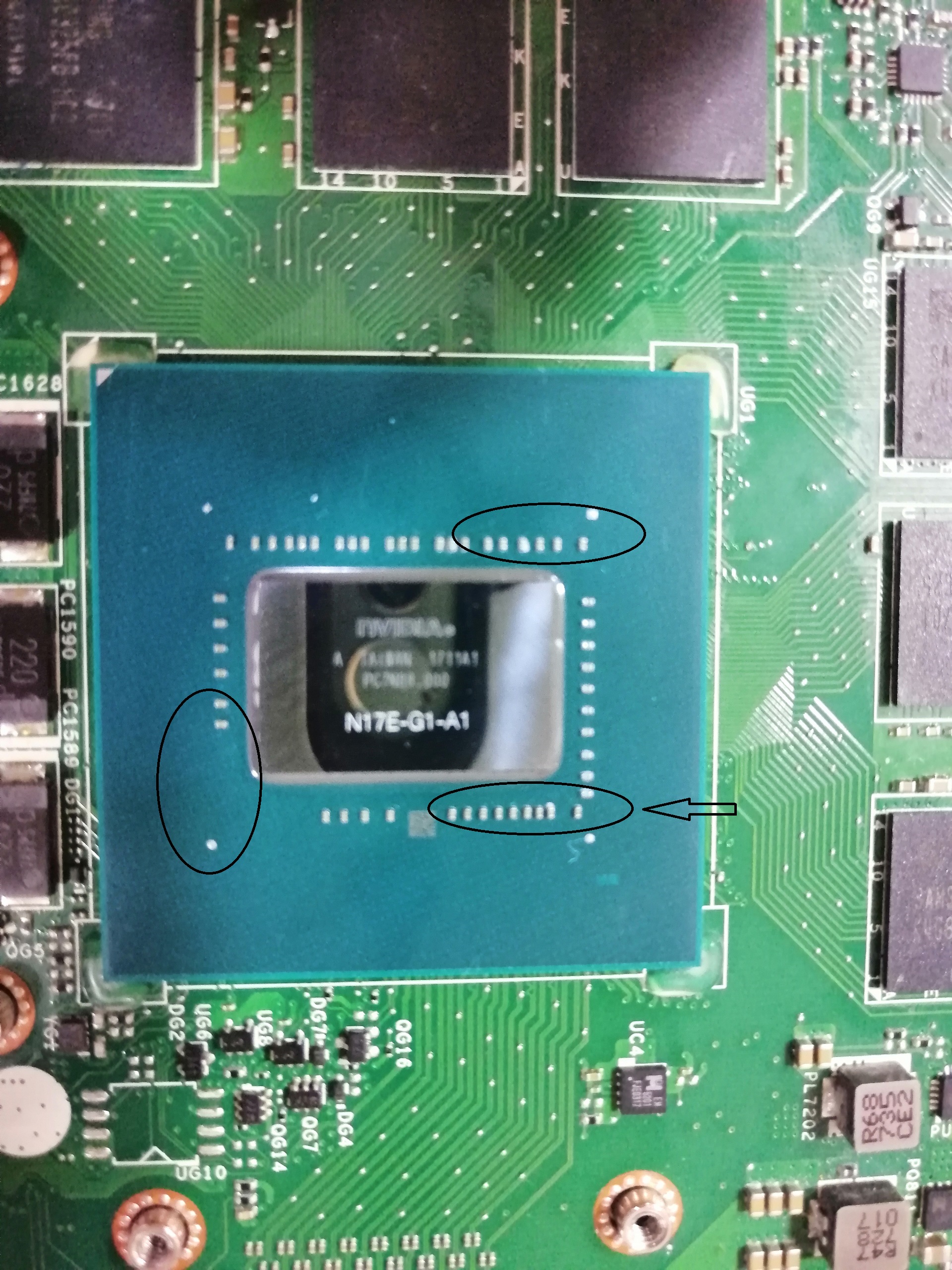

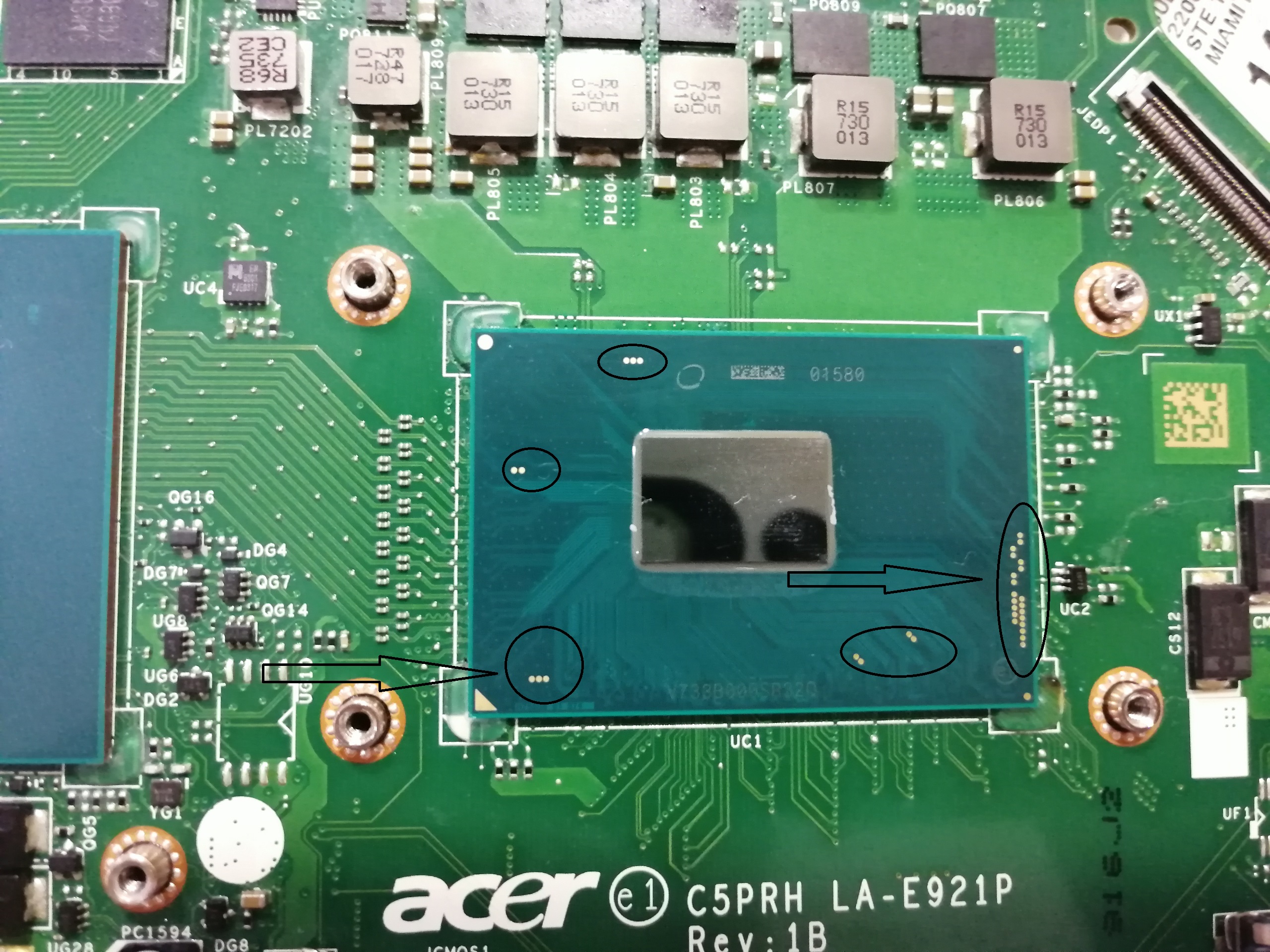

    Hi friends
    I don't know if there is already a topic about it
    but I want to know how to measure with your test points
    How to measure them, when they are in bad condition when they are short
    with multimeter
    some help?
    Thank you

    Yes you can check either the voltages or the resistance on the capacitors here.
    Typically for a Northbridge /PCH you will have three different voltage rails, one or two will be present in standby before you press the PS_ON switch
    On a GPU there are usually three or four. Again one of these is a standby or startup supply typically 3.3V. The others will usually be GPU core (around 1V, often very low resistance <1 ohm), GPU+RAM supply again around 1V-1.1V and typically 100 ohms, and sometime another supply rail with high resistance. I'm not sure what this one is, possibly a bias or Reference voltage.
    Here is a real life repair where I found the fault on an MSI Gaming Edge motherboard using this method by checking from the PCH capacitors
    https://www.youtube.com/watch?v=Ej_1VIOkQiQ&t=1355s
    Here is another one where I measure the GPU resistances on a good graphics working card
    https://www.youtube.com/watch?v=Pc3E4oR_o_Q&t=435s
    Also if you look on my YT channel you will see series of several videos regarding 8800GT graphics cards where I also look at GPU resistances, voltages, and short circuit tracing
    I hope that helps.
