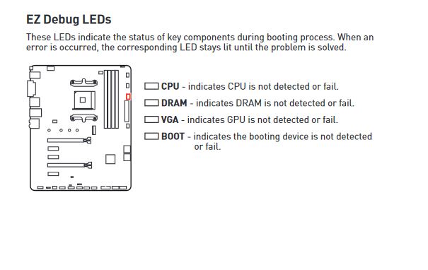

        The board has some debug LED`s .The bios you can get from the support site, no need to buy one,just program the existing bios chip, if you have a programmer .Do the other tests frirst though as suggested by dicky.

                Debug leds are dead :/ nothing at all
