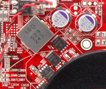

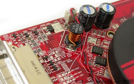

    I've just got a used V3350. There r 3 Rubycon ZA 10v 470uF 8mms on the PCB. Eventhough ZA is not bad, I decied to recap it.
    At first, I wanted to replace the ZAs with Nichicon LFs or FPCAP R7s, but I founded that they do not provide 10v 470uf in 8mm diameter.
    Then I found some pics of this card on the ATI website, also found that they use OS-CON SVPC 2.5v 1500uF 8mms for the offical version.
    Do U think it's going to be a problem if I replace the ZAs with lower voltage poly caps?
