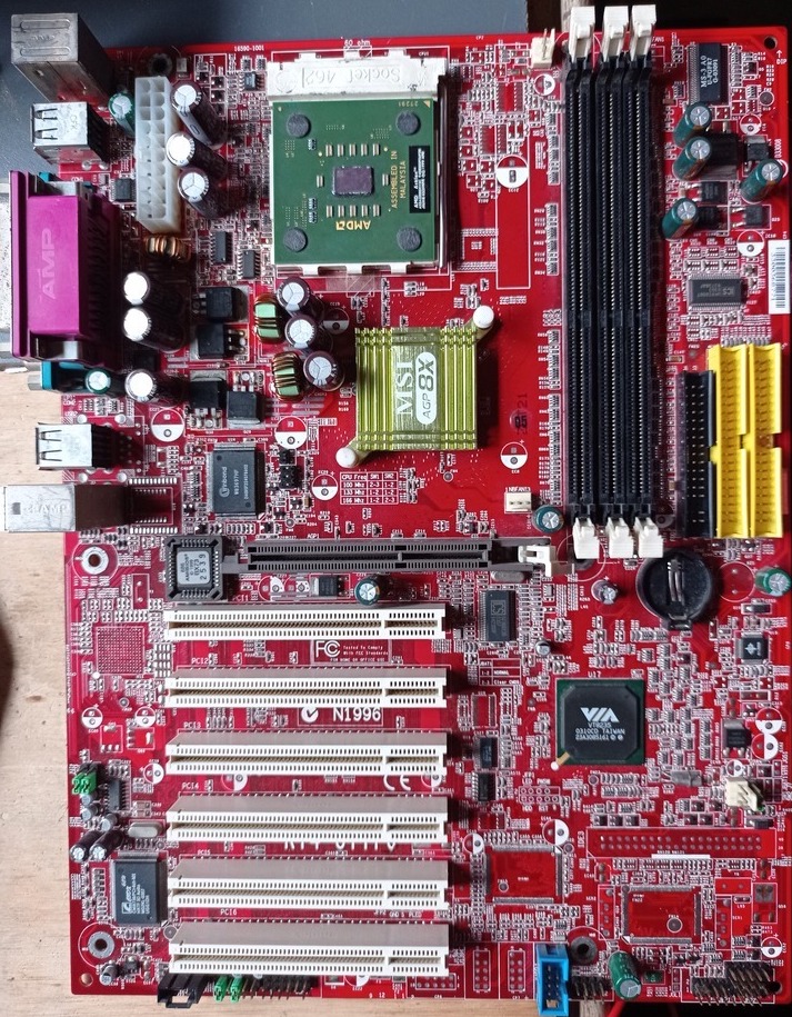

I continue my journey trying to learn how to repair a motherboard, I still have a few after the Netvista ended up working
I am trying to fix an MSI MS-6590 KT4 Ultra, that I discovered has a short on Vcore.
The board turns on without issue if the cpu is not installed, but it turns off after a few seconds with the CPU on.
After analyzing the schematics (attached) I found the vcore output in page 39 (Voltage Regulator Module) is shorted to ground. I took every component referred to in that page out of the board for testing and they are all working, the short is there even without them, on the PHASE1 and PHASE2 pins of the HIP6022 (i also took the 6022 out for testing and it seems to be fine)
So, what should be the next step? Should I take each and every capacitor between vcore and ground out for testing? Should I suspect the SIO? I didn't want to take that one out because I'm not sure I'll be able to put it back, but I guess it's a suspect.
Or does this look like the board is toast and I should simply bin it?
Thanks in advance
