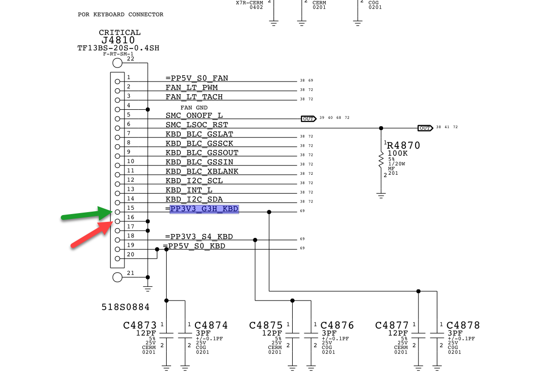

        You have a short on PP3V3_G3H somewhere on the board. With 0 ohms, appears to be a hard short where dead caps are often low resistance ohms but personally have not seen 0 ohms on a bad cap.
        Remove the KEYBOARD cable and inspect the logic board keyboard connector with the meter to see if there is a possible short between pins 15 & 16.
        PP3V3_G3H_KBD == PP3V3_G3H
        Regardless, leave keyboard & R6999 out till the short is found.

          Re: 820-00840 / No boot / PP3V3_G3H Short to ground
          Thanks for your reply mon2.
          Board is alone on my desk since the beginning, nothing plugged on it.
          Keyboard connector looks perfect, nothing special.
          However, values are below :
          Resistance from pin 15 to ground => around 2,6 ohms
          Resistance from pin 16 to ground => around 0,9 ohms (same as shorting my multimeter)
          Resistance from R6999 (pin 2) to ground => around 2,6 ohms
          So Pins 15 & 16 aren't shorted together, connector seems fine.
