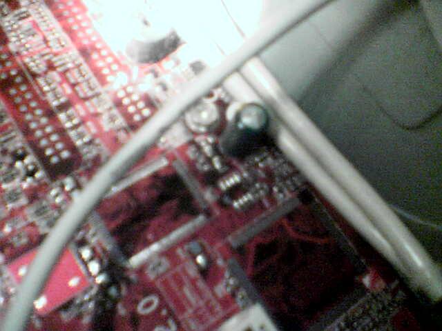

    Hi guys,
    After one month of continuous problems with my PC someone tipped me on this site and the possibility of bad caps. So I just found out that my 3 yr old MSI K7T266 Pro has got 8 bad caps (4 popped with electrolyte coming out from the top and 4 clearly blown). Thought I post it here just for statistics sake.
    The included photo shows one of the blown caps (sorry for the bad quality but I had to take it with my mobile)

    I gave MSI a call, to see if they could supply me some new capacitors to try to repair it myself. To my big surprise they were very helpfull and after I provided them a copy of the invoice proving that I really paid for this MB they have sent me without costs 20 new capacitors so that I can try to repair it.
    Time to practise my soldering skills again
