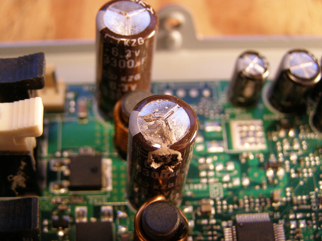

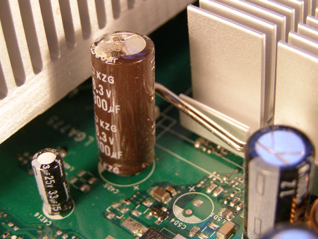

            Thanks for the helpful answers. I'm (attempting to anyway) attaching a couple of shots just cause it's fun to look at this stuff.
            Is "KZG" an actual brand?
            Anyways, the pic with the one blown cap... this is, as mentioned previously, a BTX board. Guess where this cap is positioned? Right in the jet blast coming off the CPU. Not exactly inspired engineering.
            The other pic shows a blown cap and a bulging one in the background. These two are positioned right along the top of the board, where the temps would probably be higher. These are both KZG's too. There are several 6.3V 1200 uf Ruby's on the board that aren't showing any damage that I can see.

              KZG is the series, United Chemi-con is the brand, you can tell by the little shield logo. They are generally a very good brand, just, like nichicon's HN/HM series, have some series (such as KZG) that are not very tolerant of heat.
