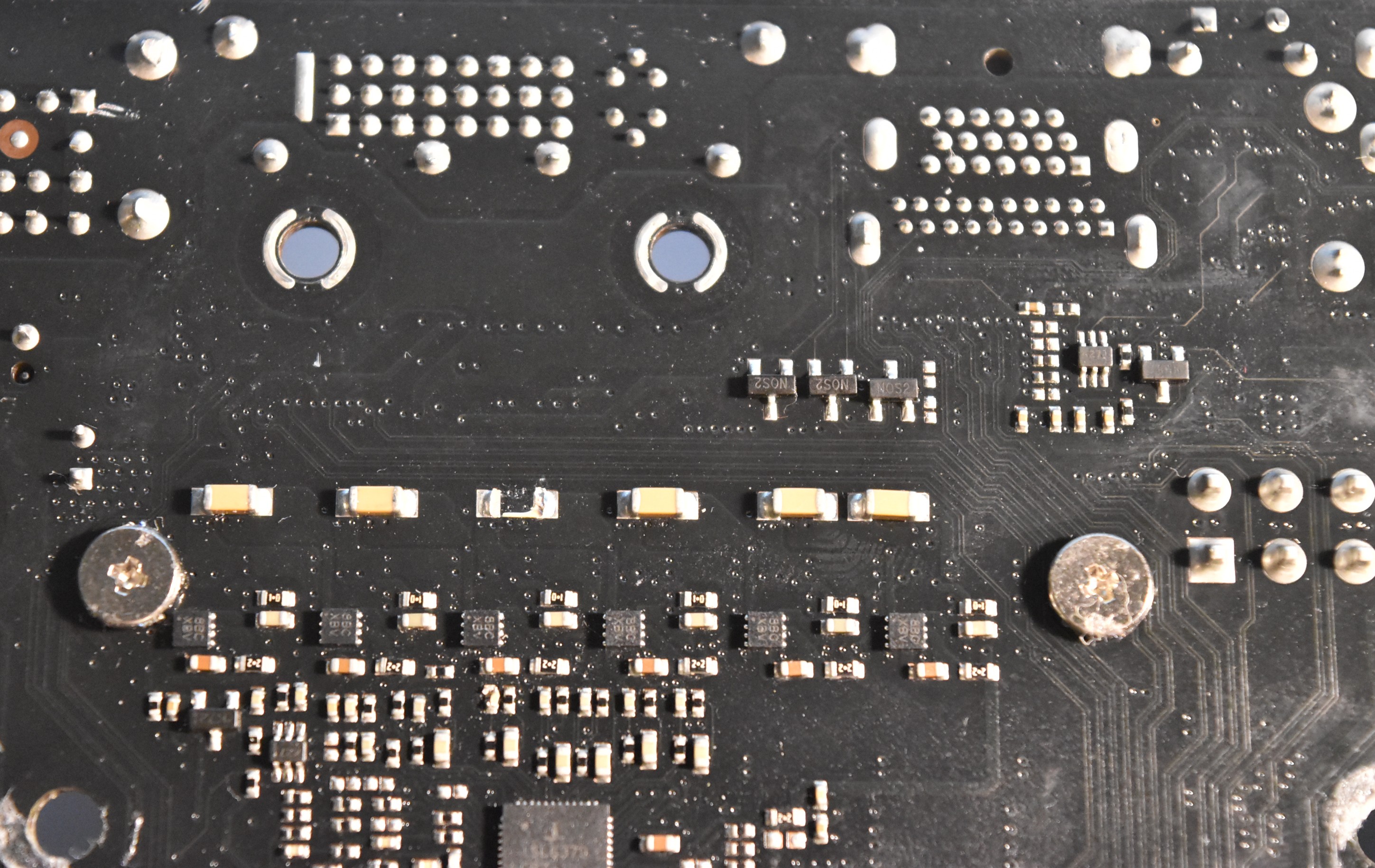

    I just received a used Asrock Z97E-ITX/ac board that I purchased on eBay. According to the seller the board works. During unboxing I noticed that one of the Multilayer Ceramic Capacitors (I think it is an MLCC but someone also suggested it might be a fuse) on the back of the board behind the VRM is missing. I checked and it wasn't bouncing around inside the package -- that would be too easy.
    (see attached board picture)
    I've done a bit of board recapping - but only for electrolytic capacitors where reading the values off of the label is really easy. I have 0 experience with MLCCs.
    I put a sacrificial CPU into the board (an i3-4150T FWIW) and the board seems to work. I was able to successfully install a clean copy of Windows and do some cursory stability testing.
    Even though the board works, I'd still like to replace the cap, but I don't know the voltage, capacitance, ESR, etc of the existing caps that are there. Is my best bet to just pull one of the remaining caps off and check it? I have a multimeter that has a capacitance mode, but this is only going to get me one of the measurements I need.
    Also, whether it is a cap or a fuse, its absence would seem to indicate that one of the voltage planes of the board has been decoupled from the CPU socket... or at the very least isn't being filtered properly(?).

    I would expect the cap. to be the same µf as the two to the left (all 6 are likely the same value) so you could remove one and check its value. I would suspect the voltage to quite low, check the voltage across the cap, it's likely under a few volts

      With the board powered up, I'm reading 12.2V across one of the still connected caps by poking each side of it with my multimeter. It would appear that these are probably for input side filtering. The 12.2V reading is due to the pretty low end PSU I'm using on my test bench. Since the ATX spec allows for up to 12.6V, I imagine I'd want to get at least a 12V +/- 10% cap or one for 13V+ to avoid sending too high of a voltage through it.
      As oriented in the attached picture, the left-hand pad for each of the capacitors reads 0 ohms to ground. The right hand side reads as a pretty big number that doesn't stay fixed at a single value. I haven't desoldered one of the caps yet, but that's planned for this evening after it cools down a bit. Even without pulling one of the caps off of the board, if I use the capacitance setting I get a reading of ~90μF +/- 1μF on each of the populated components. This leads me to believe that they are in fact capacitors (it has been suggested the might be fuses). I'll see about getting a true reading after desoldering one of them. And of course the holy grail would be to find some markings on the underside of the cap.
      The nearest rating I can find on Mouser is for a 16V 100μF capacitor... and at least for low quantities they're NOT cheap for such a small part. It looks like getting that combination of voltage and relatively high capacitance is costly. Dropping the voltage down a notch to 10V or dropping capacitance down to 47μF each cut the cost roughly in half.

        From your multimeter readings you can be sure it is not a fuse:
        Just imagine what would happen if you put a fuse across something that has 12v potential to ground? That is a short, fuse go bye bye
        This is probably a 10uF or thereabout MLCC.

          Right on the money!!
          Short version:
          Pulled off a cap and it measured right at ~10uF (10.2-10.3uF measured).
          Long version:
          I desoldered one of the caps, and then while trying to get the leads of my multimeter onto it with enough pressure to make good contact... it shot off onto the floor and disappeared forever. Since I'd probably killed the board anyway by removing a 2nd cap, I went for broke and pulled another one off and by being more careful was able to get a measurement on it that lined up with your 10uF estimate.
          So... now I need at least 2 replacements. Any suggestions or guidance would be appreciated. For starters since at this point 2 capacitors are missing and I've desoldered a 3rd. Would it make sense to just replace all 6 so that they match?
          Shopping at either Mouser or Digikey, it looks like I'd need to source a 16V 10uF MLCC -- of which there are MANY. There's tons of resources available for electrolytic capacitors, but I've been having trouble finding info on MLCCs.
