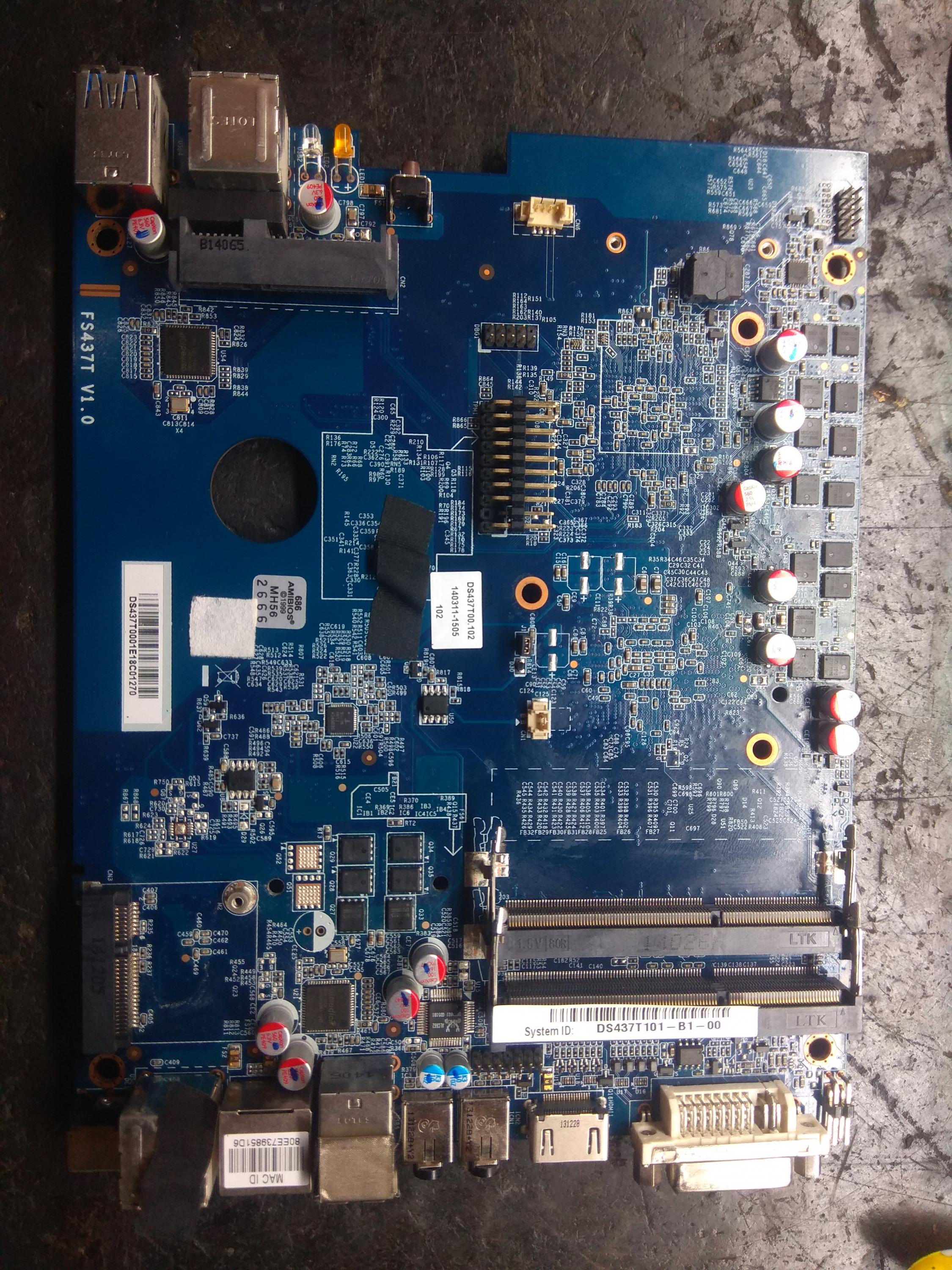

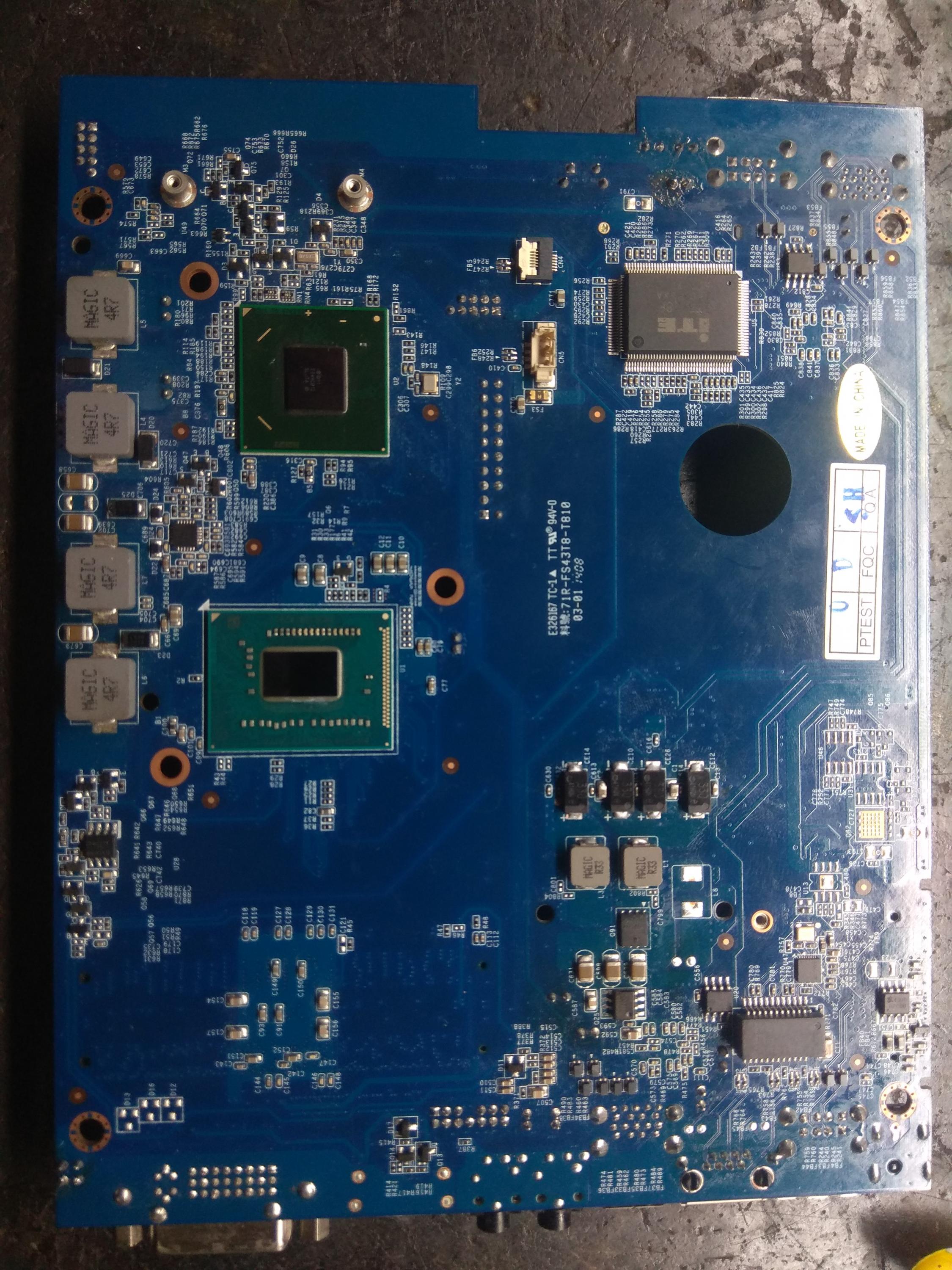

    Hi Guys,
    Brand : Shuttle XPC
    Model : DS437T
    Problem - Deadset with Blue LED indicator Flashing
    As I mentioned above the details of my patient. Has anyone encounter my same problem unit?
    as I measured the 4 pcs Group of capacitors - they are nearly shorted to 0 OHMS.
    I also tried to hang every posible IC and MOSFET but still no luck.
    Please Help me with this.
    Thanks in advance

    Re: Shuttle XPC DS437T - Deadset
    capacitor in circuit specially if it powers the processor or gpu must not be shorted.. 10 to 5 ohms is ok but if its shorted i mean near 0 ohm its defective or.. maybe the gpu is shorted.. try to lift the suspected cap to see if its shorted or if you cant see any defective capacitor.. try this at your own risk inject a 1volt 1 amp to the circuit with suspected shorted caps be sure the polarity is correct. and see if some thing is heating up
      Thank you Sir!
      I will follow your advice. Cheers!
