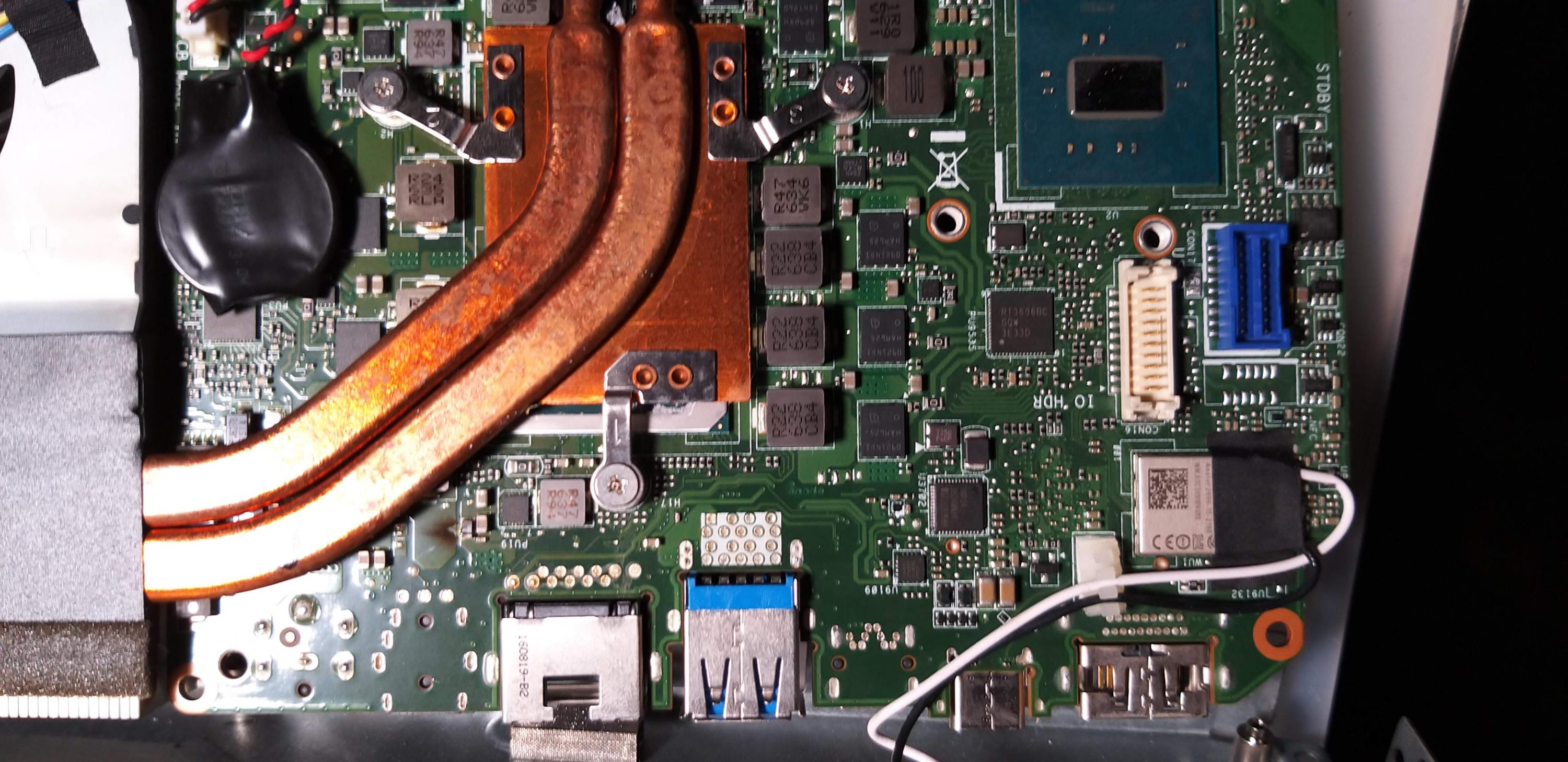

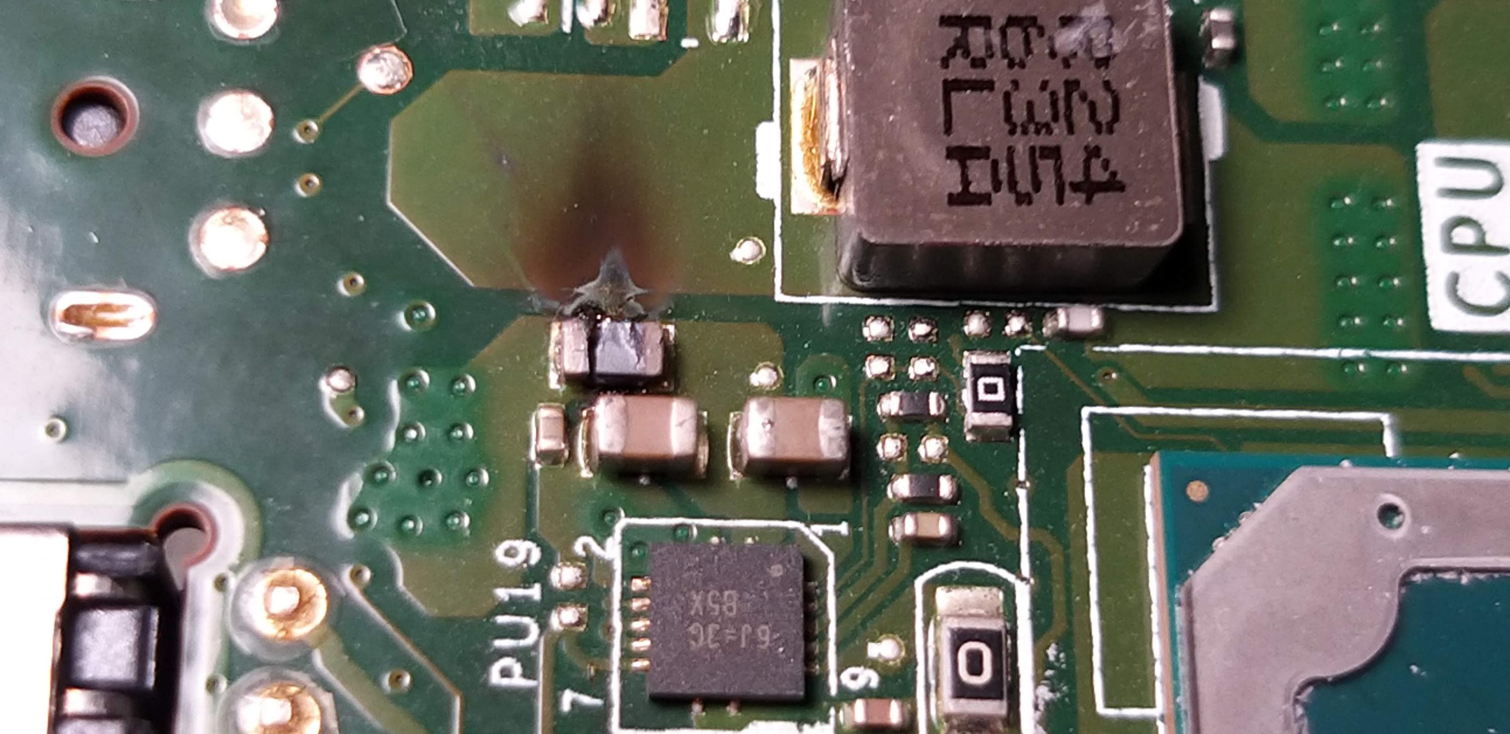

    I was using my NUC6i7KYK and suddenly it restarted. That happened more and more often. Now it doesn't even boot (fans start but no display output).
    I opened the box and found this little component burnt.
    How can I know if this is really a capacitor? It has no continuity (open circuit). In another part of the board similar components show continuity but can't measure their capacity.
    Any help is highly appreciated.

    Re: Help identify burnt capacitor?
    Most likely an inductor feeding the input of the voltage regulator just next door. (Richtek RT6220AGQUF)
    Voltage regulator is probably shorted, and that might have damaged the CPU…
        It could also be what they call a ferrite chip bead (not a ferrite bead) but a an inductor like a HCB4532
          Thanks R_J. But the size doesn't match; That HCB4532 has a footprint of 4.5x3.2 (mm). The component was closer to something like 0805 (2.0x1.2 mm).
                Hello, same issue here. I just replaced the voltage regulator (Richtek RT6220AGQUF) and still no video output. Will report back as soon as I get the ferrite bead.

                    Re: Intel NUC6i7KYK.Help identify burnt capacitor?
                    Regarding the ferrite bead: one side links to +V (19V) and the other is ground. I bought the ferrite bead they recommended in the intel forum, but they are very low resistance, and it feels suicidal to place them between 19 V
                    There is also a short circuit in R47
