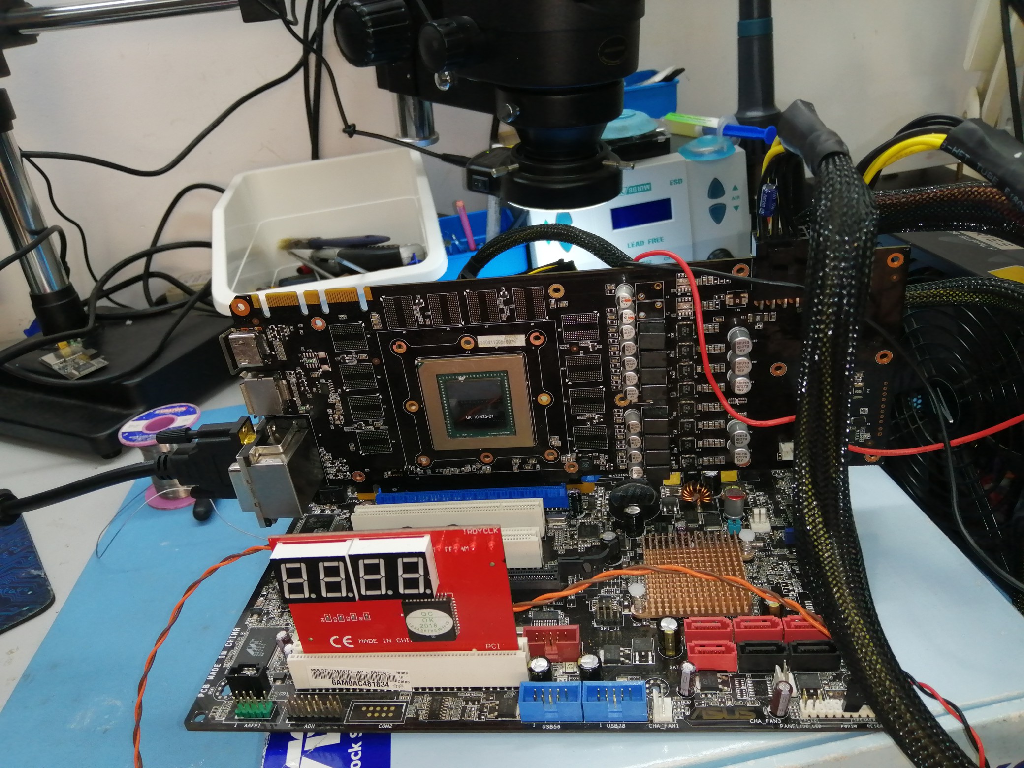

    As the VRAM FETs were faulty and the inductors are currently removed, I then powered up VRAM from my bench supply at 1.5V - something draws about 2.7A and I am pretty sure that is the GPU as it gets a bit warm. I then powered up the motherboard from ATX supply and I have a sort of result!
    Basically the PC now beeps to show it detected the graphics card, and my monitor comes on so it must have video sync - but I have a blank screen. That would seem reasonable as I have no video ram on the graphics card now...... but...
    I saw this video
    https://www.youtube.com/watch?v=vDyTtcKndug&t=601s
    I am basically doing the same thing as this guy, with similar reuslts on the current drawn from the bench PSU (I think his is a GTX780 and mine is the 780ti which makes sense mine would draw a bit more power) but he gets a picture with no video ram and I don't. Watch from 5 mins onward to see this. Unfortunately the video is in Russian and I don't understand that at all, but in the end he fixes his card, though i am not sure if he also reballs or replaces the GPU.
    Does anyone here understand Russian and can explain what this guy is saying? And how he gets video output with no video ram?

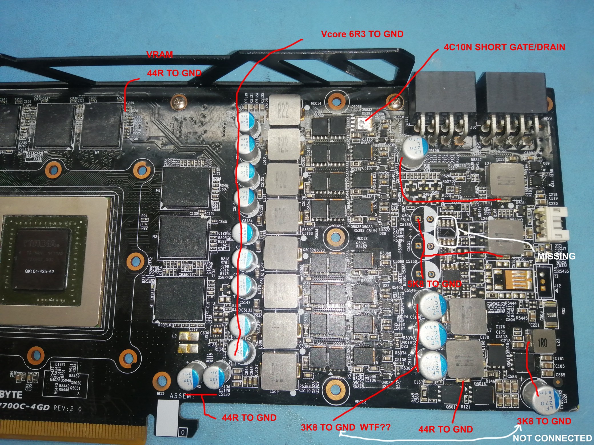

      And now onto the Gigabyte GTX 770, GV-770OC-4GD
      Someone has been messing with this one, there are three electrolytics missing plus a tantalum from the other side. Also a chip is missing (I can see where they cut the legs off to remove it). I don't know what the chip is, but next to it is a LM358L and these look like they may have been a pair looking at the PCB layout. Alternative scenario is something hit this part of the PCB very hard, as it looks possible the chip was smashed off the PCB and the missing electrolytics which are right next to it had the legs still attached to the PCB just no body.
      It is possible other parts are missing. In fairness I only paid 2 euros for it a the car boot sale.
      I think the only chance with this one would be to buy another card of the same model (working or spares/repair) then compare the two in the hope to get two working cards ,as I don't know for sure what may be missing..
      I took some resistance measurements, Vcore is 6R3 and Vram is 44R - which looks kinda OK compared to the other cards, considering this one has 16 RAM chips, 8 each side and the GTX780 cards had 12 RAM chips and read 110R
      The blown FET is short Gate- Drain I don't know why that has gone bang. Could be related to those broken parts?
      There is something *very odd* about the missing capacitors as I can't figure out where they connect to. I thought they should be on Vram because they are right next to the inductors but I found two capacitors for that supply rail further across the board. They don't connect to 12V in on the 8 way connectors or the PCIe 12V either. Also they are not in parallel with the three electrolytics just below them. I can't make sense of it unless I am missing something obvious. see pics.
      I think the Vcore/Vram resistances look OK. What do you guys think?
        Yup, I can confirm the GPU should detect and monitor power up without the RAM. I tried this on an old EVGA GeForce 7600 GT video card that had shorted RAM chips due to faulty caps. I removed the RAM chips and tried powering on the card without them. The only thing is, I don't remember if I got a black screen or a screen full of colorful random/noisy artifacts (I know I got both at some point, but I don't remember if one was with the GPU RAM supply disabled or whatever else I tried.) This was about 6 years ago, so I just don't have good memory what I tried on that GPU anymore.
          You may be able to find high-res pictures online of that PCB and determine what the missing chip is.
          I suspect the damage to those missing parts was from hit damage. And there is also a chance the GPU or something else could have gone bad before that, thus making the original owner not care and not store it properly (or discarded it and that's when the damage happened.) So that's probably going to be a multi-part repair, even after getting all of the right parts installed again.
          Looks alright to me as well. At least nothing obviously bad.
          Or the other way around.
          FET blew and original owner threw the card away, damaging it in the process??
          Sometimes, we may never know. :\

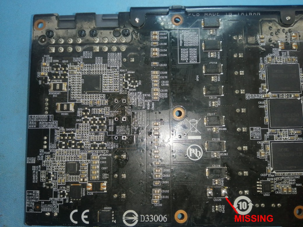

            PHANTOM
            OK so i replaced the six missing SMD capacitors by taking them from the Palit. I also made a note of the values.
            From the resistance across them, one is on Vcore, one is on Vram and the other four are on the 3.3V rail from PCIe
            Unfortunately this didn't make any difference, I still get those dashed lines on the video output.
            So I am not sure how to diagnose that further. As an aside - how do I power up the graphics card for more than a few seconds with no heat sink mounted on the GPU, so I can actually probe around it?

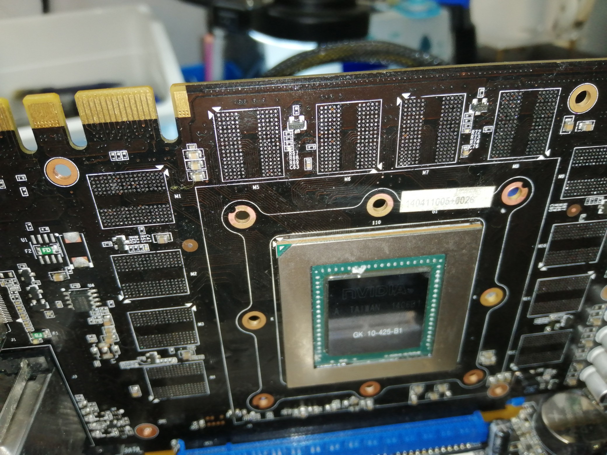

                I was powering on the card only for a few seconds with my fingers against the GPU to check the temperature. As soon as I saw an image I turned off again. It only got warm, not hot. I did myself think a water cooling block is something i need to get, I was just hoping for a cheaper way. Previously i had no Vcore or Vram or PLL voltage rail (what does that do by the way? PLL = phase locked loop = oscillator?) on this card so the GPU was cold. The others don't giver an image but again I only power on for a few seconds to take a voltage reading or see if the GPU detects, and use the same technique of fingers on GPU. Never has one got hot enough to be uncomfortable to touch.
                I put it back together to see what it does - those dashed lines are like about an inch long and almost always dark blue, sometimes cyan or green - against white they are yellow
                They are only on the top half of the windows desktop, and not always in the same place.. Images are fine it is just the windows 'background' area you see the dashed lines. When an image appears it kinda erases and dahed lines that were there. I suspect this is RAM problem as it is only in certain areas of the screen but have no experience to be sure. I will try get some video of what I mean after the weekend
                So Windows runs basically OK, however the PC always crashes (black screen) once I install the GTX 780 drivers - I tried a few times with Windows 10 64 bit, then put another drive on with XP 32 bit but the same thing happens.

                    I can't find a ball-out for H5GQ2H24AFR or even for GDDR5 though I think probably it is a standard layout. If anyone has that datasheet i would much appreciate it.
                    However in the Russian video at 2min 42 he shows which balls to check, and it is good enough to work from. There are 64 of them - though I read that GDD5 is 32 bit so I am not sure why that is??
                    Anyway, He says that if memory controller in the GPU is good you should read the same resistance on all these pins. On mine I didn't bother checking all channels (I think this card has 6 channels with two chips each) but I didn't need to because on M1 M5 and M8 chips - which I chose at random - I see I have around 560Kb on most of the DQ pins and 80Kb or less on some others. A few reads low at 9.8K
                    So from that, and the fact my GPU detects but gives no image without Video RAM whereas apparently I should see an image if the GPU is working, leads me to the conclusion my GPU is damaged and there would be no point replacing the Video RAM
                    The GPU are quite expensive to buy - around 75 euros on Ali but I did find a supplier at 45 euros which would mean I could at least get my money back if I fix this card, and probably even make a small profit at current used pricing - and it would be a useful learning experience, which is something you can't really put a price on.
                    I think I will put it on one side a little while. If I manage to reball and fit the Gigabyte GPU and that card is then working, I may decide to try fix this one also
                    I'm vacillating over removing all the RAM from the Phantom (the card with those lines on the picture) and checking the DQ resistances on that one also - to see if I can prove whether I have artifacts from a faulty GPU or from faulty GDDR
                    Rich

                      GDDR5 indeed has a 32-bit data bus, so 32 DQ pins, but you also have the address bus, the control bus and even a separate bus for CRC, and the clocks.
                      Random datasheet of a GDDR5 chip attached (from )
                      There might be different packages depending on the density of the chip, haven't checked.
                      I find it somewhat surprising to measure in resistance mode. Personally I'd use diode mode as usual on signal lines. But I'd expect all the signals in given set (eg. the 32 DQ pins of the data bus) to show a very close value on the multimeter since they should have the same driver inside the memory controller. The value may be different from one set to another (since for example a differential clock line will have a different driver than a single-ended data line).
                      Also a GPU could fail without showing any weird measurement on the RAM bus using the multimeter.

                        H5GQ2H24AFR Datasheet .The ballout starts on page 156 .Top View (as seen thru package)

                          Ahh thanks SMDFlea - that's excellent!
                          OK so I can now see what signals I am probing, here is an example of what I find on this Graphics card. I picked 2 random chips and checked all signals marked in green on the ballout diagram
                          GDDR IC M5
                          Byte 0
                          DQ3= 55K
                          DQ7 = 122K
                          All other balls Byte 0,1,2,3 read 560K-600K
                          GDDR IC M7
                          Byte 1
                          DQ14 = 88K
                          Byte 2
                          DB12# = 51K
                          All others Byte 0,1,2,3 560K-600K
                          It is obvious from the PCB layout that M5/M6 belong to one channel and M7/M8 to another - I am not sure of the way the layout is sequenced but if we go round in a clockwise direction lets say we have channels 0-5 in sequence and these are channels 2 and 3
                          So it is clear that this GPU has problems on Byte 0 of channel 2, but byte 0 checks OK on channel 3 where we have problems with Byte 2 and 3 instead
                          It looks like I stumbled on a good diagnostic method here to prove if the GPU is bad before going to the expense of changing the GDDR Ram
                          Obviously this is not new knowledge, but was I the only on here who didn't know it?
                          What I will do now is remove the GPU from the PALIT and see if I can find any differences with the supposed good one I already removed from the Gigabyte.
                          This may assist if I decide to buy a replacement GPU from Aliexpress in as much as I can test it for some problems before fitting it. If i can spot differences between the two GPU that I already have, then I am certain I will have to order one because the curiosity will get to me too much
