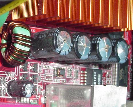

    About a 6 months ago I got a new motherboard because my old one was just fried and I they gave me a MSI Micro-ATX and I was moving my monitor and it shut off, so I tried to turn it back in and it said no signal. The computer was turning on so I hooked it up with my other computer and it worked, so I figured it must be my computer then. When I opened it up I found this
    is this bad?

    That's classic bad caps. Its in need of recapping. If you can't do it yourself, shoot me or KC8 a PM, either of us can.

      Re: MSI Micro-ATX Oozing from the top!
      so then its sfe to say this is the problem then heh?

        No doubt or mistaking it. It has bad caps.

          looks like the imfamous nichicon hm n series.
          that is becoming an everyday sight here.
