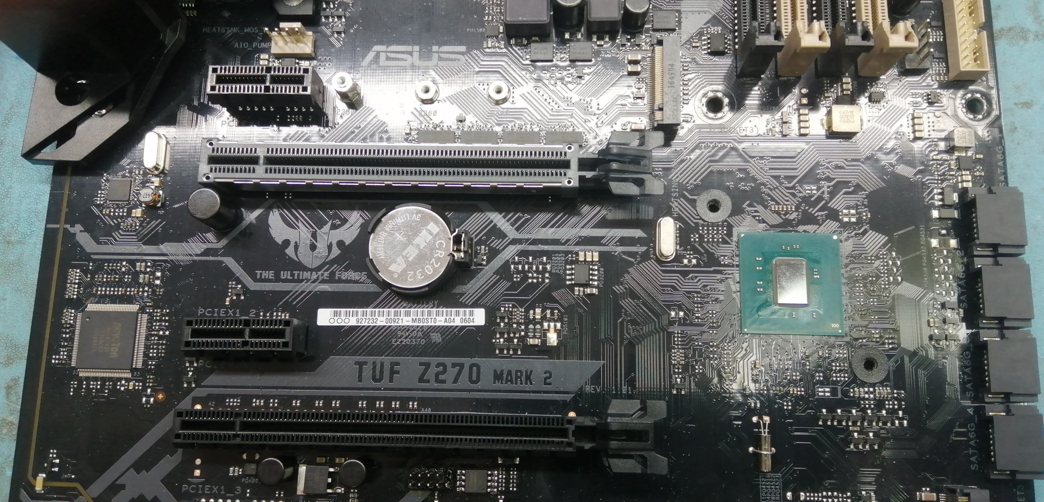

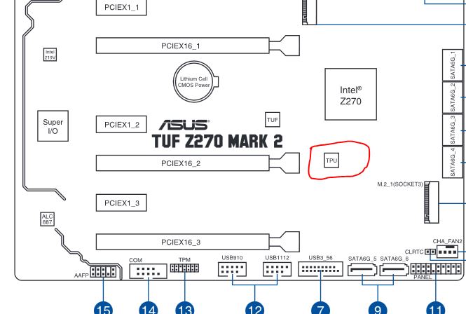

                      Interestingly, my board does not seem to have a TPU - at least not where it should be located. All I can see here is hat looks like a SOT23 transistor and a couple of resistor networks
                      I can see an 8 pin chip roughly in the area of the chip marked TUF on the above post, that is a 2A LDO according to the datasheet
                      There is an 8pin chip the other side of PCIEX16_2 but that is the BIOS chip I already tried programming 25Q128F
                      The only other IC I see in this area of the board is a Nuvoton 3949S next to CLTRTC pin headr but that could be a Fan Controller (I struggled to find an exact datasheet)
                      There is nothing on the other side of the board either

                        The TPU is there in the picture at post #26 ,damn asus lied

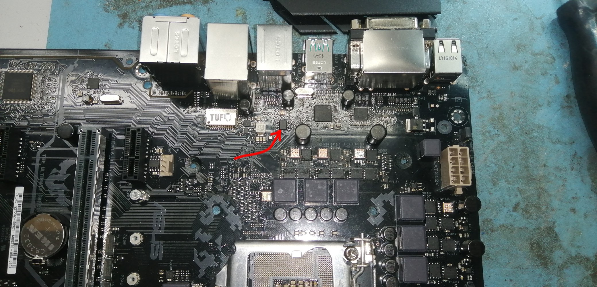

                            If it is true that all Zx70 motherboards have a TPU then it must be on the board somewhere - but it ain't where the picture in post #26 says it is
                            I'll make a note of every IC on the motherboard - it must be there somewhere i guess

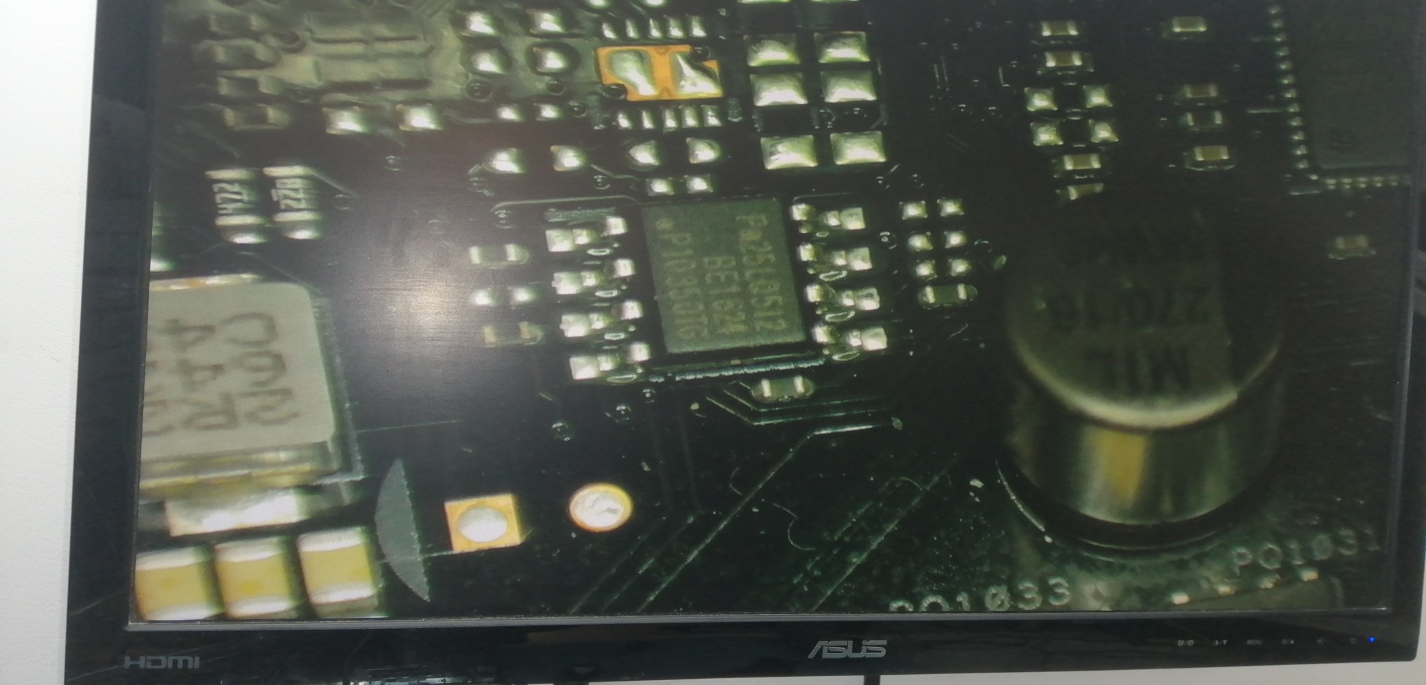

                              OK I think I may have found the TPU on my Asus TUF Z270 Mark 2
                              25LQ512 - datasheet seems to match the SMDFlea description
                              It was nowhere near where the picture showed it to be. See pics

                                  Hmm maybe hold the celebration -I'm told that may be the USB3 bios - I need to unsolder it and check
