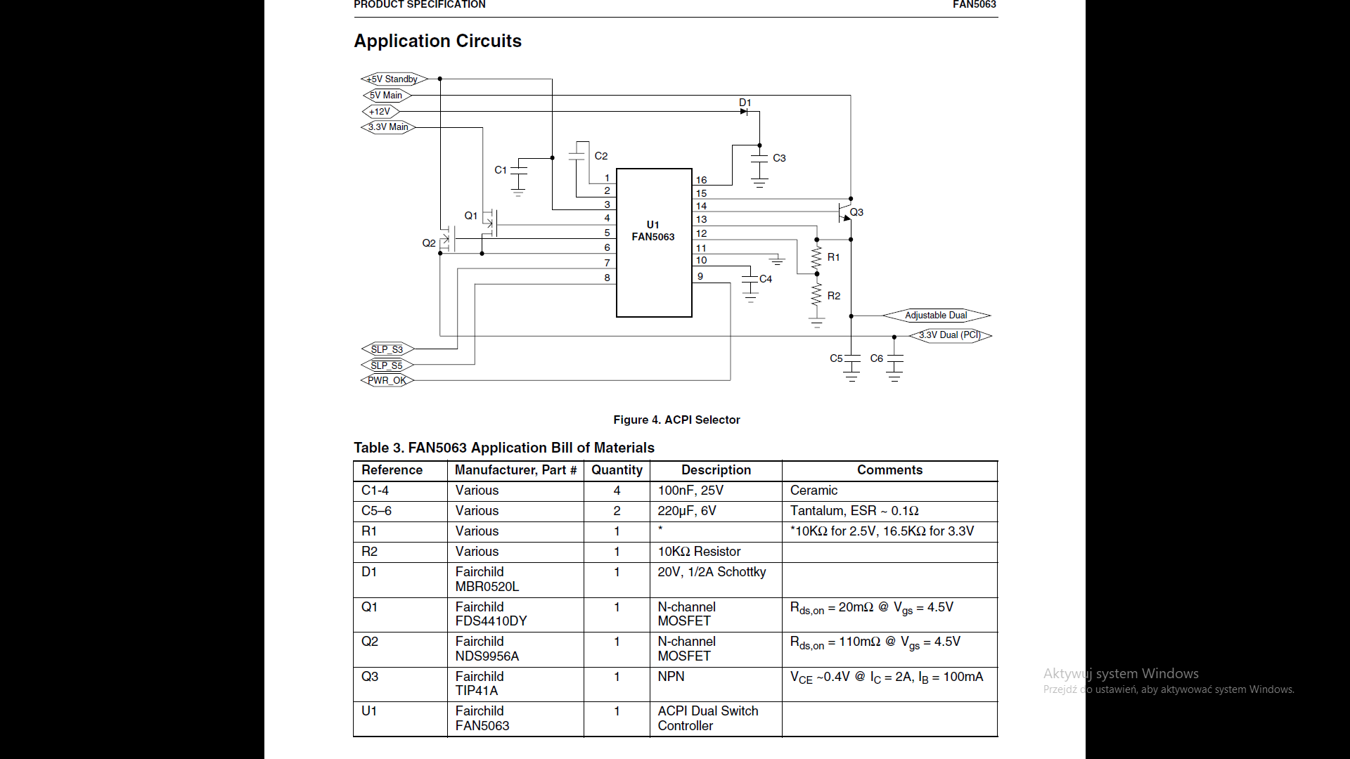

                        I've found a datasheet on FAN5063 controller, which contains application circuit.
                        Looks like Q3 is directly responsible for delivering voltage for SDRAM. There is no voltage control, output voltage is simply controlled by formula using R1 and R2 values (it's 2,5V for RDRAM and 3,3V for SDRAM). Q3 is the transistor where I found difference in voltages.
                        I measured both boards, both controllers, high/low states on PWR_OK, SLP_S5 and SLP_S3 and I haven't found anything different except voltage on Q3.
                        My qustion is - should I replace it? How can I check this component after unsoldering? I have this chinese electronic testing device with LCD, it's actually quite useful for other components.
                        From the datasheet:
                        Adjustable Dual Output
                        The adjustable dual output is intended to provide power to
                        RAMBUS or SDRAM memory.
                        Adjustable dual is generated by one external NPN bipolar
                        acting as a linear regulator from +5V main, and one linear
                        regulator internal to the FAN5063 from +5V standby, as
                        shown in Figure 4, and in the block diagram on the front
                        page. When main power is present, the NPN Q3 linear regulates,
                        and when main power is absent, the internal linear regulator
                        is on. Q3 cannot be substituted with a MOSFET. If
                        used in one direction, the MOSFET's body diode would permit
                        back-feed; if used in the other direction, it would shortcircuit
                        the linear regulator action.
                        The state of the external MOSFET and the internal linear
                        regulator is controlled by the SLP_S3 and PWROK lines,
                        and additionally the SLP_S5 line, as shown in Figure 3.
                        When SLP_S5 is de-asserted, both the external MOSFET
                        and the internal linear regulator are off, and there is no output
                        voltage on the 3.3V SDRAM line.

                          Re: Abit ST6E "Casper" fix
                          You lost me.
                          Where is FAN5063, you didn't mention it before. Is it the 16 pin chip mounted horizontally near the transistors in your pics?
                          If so, which pin of FAN5063 goes to the base (pin 1) of the transistor D114 G51?
                          If it is pin 14, then D114 G51 is an NPN transistor connected as a series regulator, which makes sense, and it must be open circuit BASE-EMITTER. It has 5.0V-2.2V= 2.8V Base-Emitter! It's probably 'leaky" collector-emitter as well hence you get some voltage on Vram.
                          On the good board you have 4.1V-3.4V =0.7V Base Emitter which is correct for a Silicon Transistor that is turned on
                          Change D114 G51. Take the same transistor (with slightly different part number ) from the good board and fit it on Casper
                          If that works we can find some equivalent for your other board

                            Yes, exactly it's 16 pin chip next to the transistors. And from pin 14 voltage is supplied to the base (5V).
                            Q3 is descibed in this datasheet as Fairchild TIP41A (it has different case, but it should have the same paremeters I guess).
                            Sorry, electronics is not my profession, so I don't know on which details I have to pay the attention I have some experience in reading the datasheets though, I used them quite a lot vmodding the boards and GPU.
                              TIP41A was quite a common NPN TO-220 package power transistor back in the day.
                              If B-E is open circuit (which it will be) you can expect pin 14 FAN5063 to go to 5V
                              Change the transistor for the one off your other board. I am confident that will fix your problem

                                Replaced this transistor and it's working Thanks dicky96 for help.
                                This tester which I have show the same values for both component, looks like this transistor was leaking after putting some load on it.

                                      The transistor has 1.6V voltage drop across it so 1.25A would hit the maximum rated wattage of 2W and I would be suprised if your RAM draws more than that. I don't know though it's just a guess - how much power does PC100/PC133 Ram consume? Someone here will know.
                                      Rich
                                        That should say 60V 3A 2W
