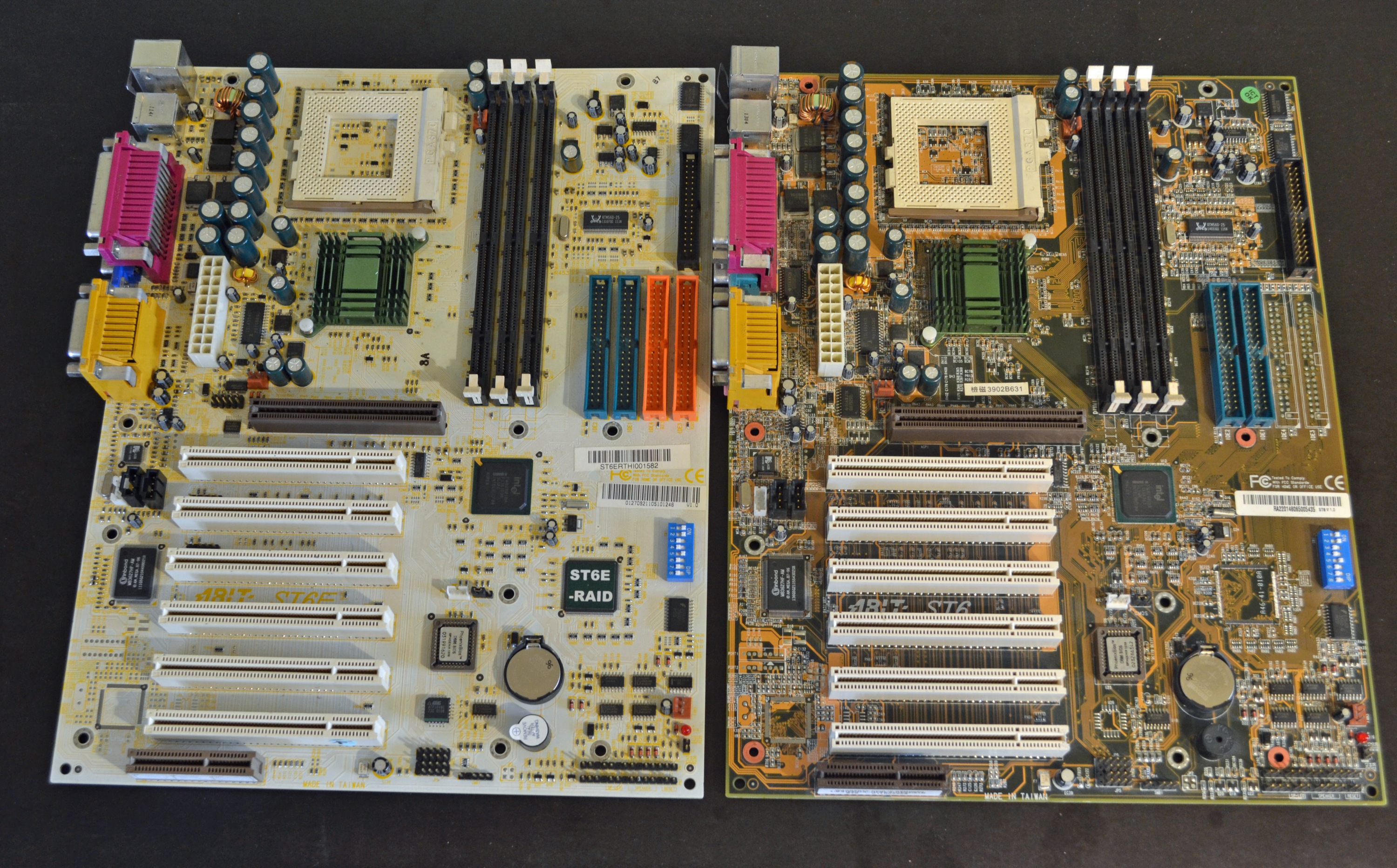

    I have an Abit ST6E board aka "Casper", which is unfortunately not working. Because it's very rare board, I'd like to repair it, not matter the cost or how hard it will be. It's in 95% identical with ST6, only difference which I saw is that ST6E has different NB and SB (ST6E uses 815, while ST6 uses 815EP without IGP). I've already bought working ST6 for diagnostics, and maybe a part donor if needed.
    Here is what I've found out already about this board:
    - hangs on 00 code using PCI Diagnostic card, no matter what CPU
    - reports the lack of CPU or RAM (by C1 code)
    - came with Tualatin CPU which was dead I think, there was a two tone siren from beeper on this CPU
    - I switched the bios chips between boards, bios chip from ST6E is working on ST6
    - no physical damaged, no broken components or damaged traces, no badcaps
    - voltages are present, there are also no shorts on main componenets (CPU, RAM, NB and SB).
    Can anyone help me with diagnostics? I can handle all the replacements by myself, even the BGA.
    Thanks,
    Bartek

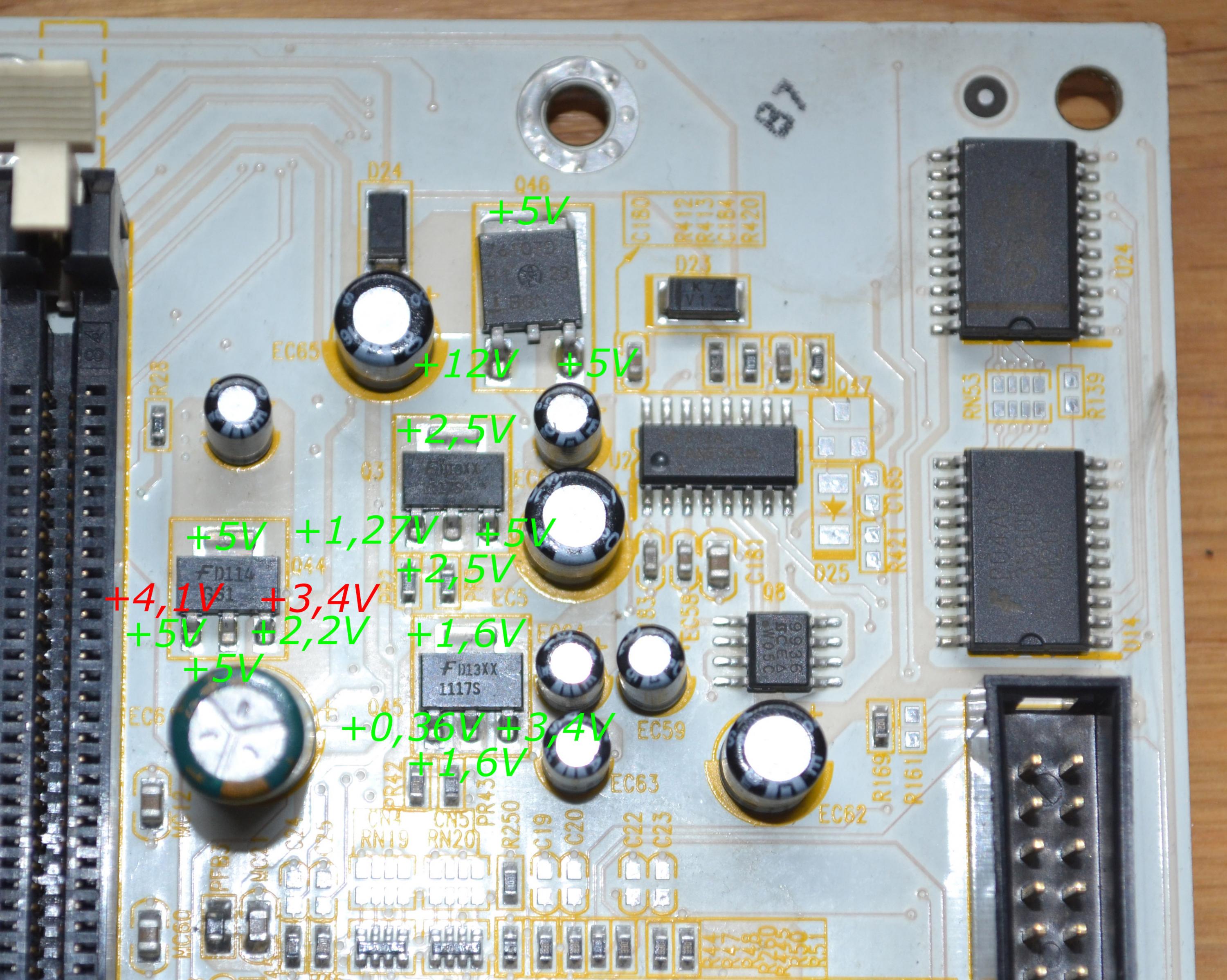

              EDIT: I went further with diagnostics, looks like there is an issue with RAM voltage. Good board have 3,4V on capacitors near the RAM slot, no matter if the RAM is present or not. Bad board have 2,2V with no RAM and about 1,4V with one RAM stick present.
              EDIT2: I measured the voltages on Mosfets on both boards. Those two voltages written in red are on good board, on bad board it's different. Should I replace this element or look for any possible shorts?
              • dicky96
                Sun Seeker
                • Mar 2017
                • 1825
                • Spain
                Re: Abit ST6E "Casper" fix
                Is that device marked D114 351? It's a bit obscured by the red text
                But yes there does seem to be a problem there. It seems a bit odd you also have 5V on the left hand pin, I would expect you to have something else on that pin as it probably controls the output voltage
                I can't see it being a short - looks more like D114 351 is acting as a high impedance source and leaking some current to the RAM, because when you put a load (fit RAM) then the voltage drops

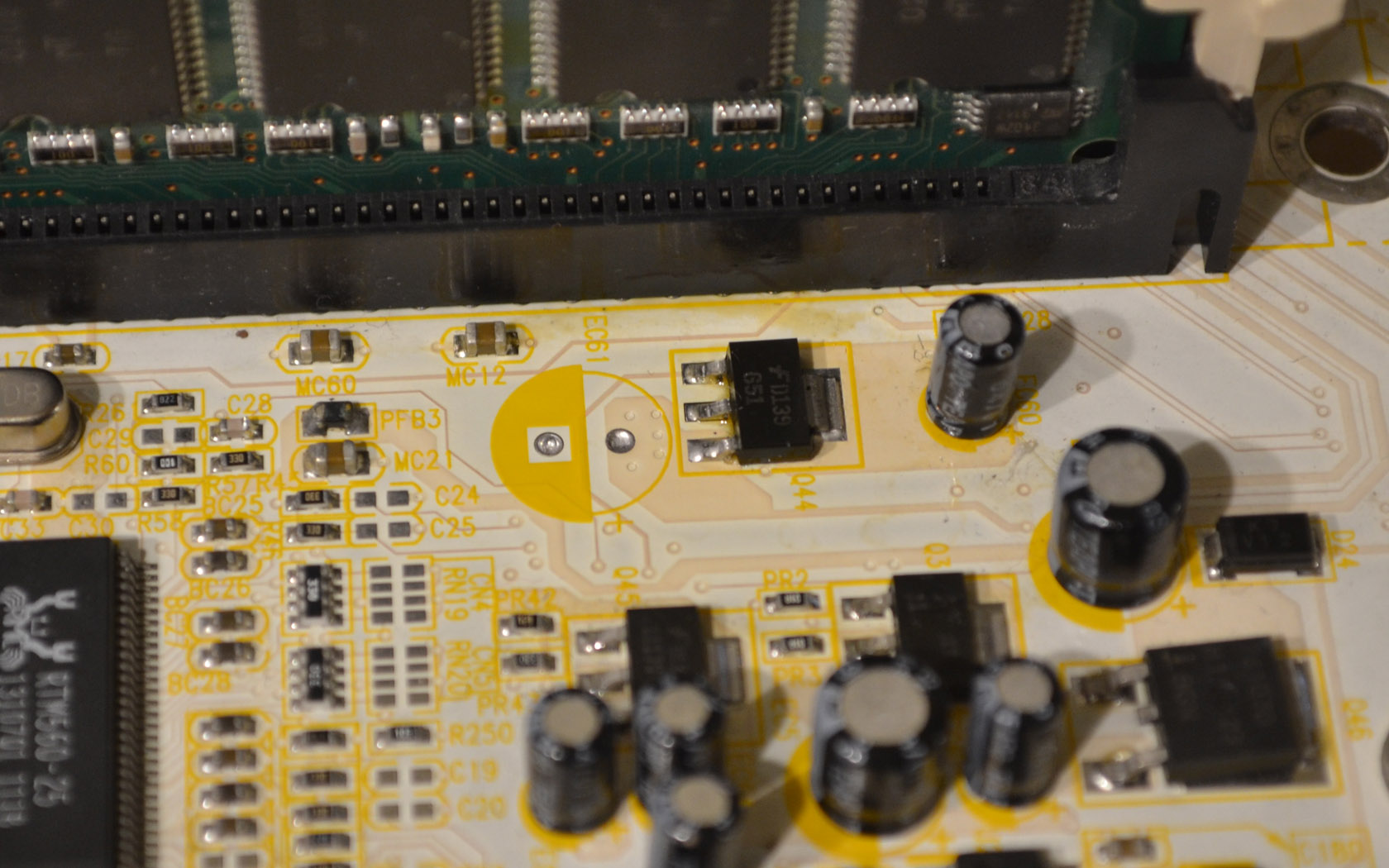

                  That's Fairchild component, marked D114 G51, on other board it's marked D139 G51 - unfortunately I was not able to identify it by SMD code.
                  I also noticed difference between capacity measured on the legs on the capacitor just below this componenent mentioned above. Good board have 2700uf, bad board 1800uf. Could one of the RAM capacitor cause such issue?
                  • dicky96
                    Sun Seeker
                    • Mar 2017
                    • 1825
                    • Spain
                    Possible I guess but I doubt it.
                    I dont' see any inductors around there so I would think that is acting as a series regulator
                    The thing looks something like a 1117 regulator to me, though I couldn't find a datasheet either
                    Some linear voltage regulators don't work well without a capacitor from the output pin to ground, so it would be worth just tagging a 1000uF 6.3V or greater from the Vram pin of the regulator to ground to see what happens. I can't see that would do any harm.
                    I would suspect that having 5V on both pin 1 and the centre pin is not correct, so the regulator is kinda disabled maybe?
                    You could just try removing the FET or whatever it is and apply VRAM 3.3V from an external bench supply then powering up the ATX and see if the board will boot up

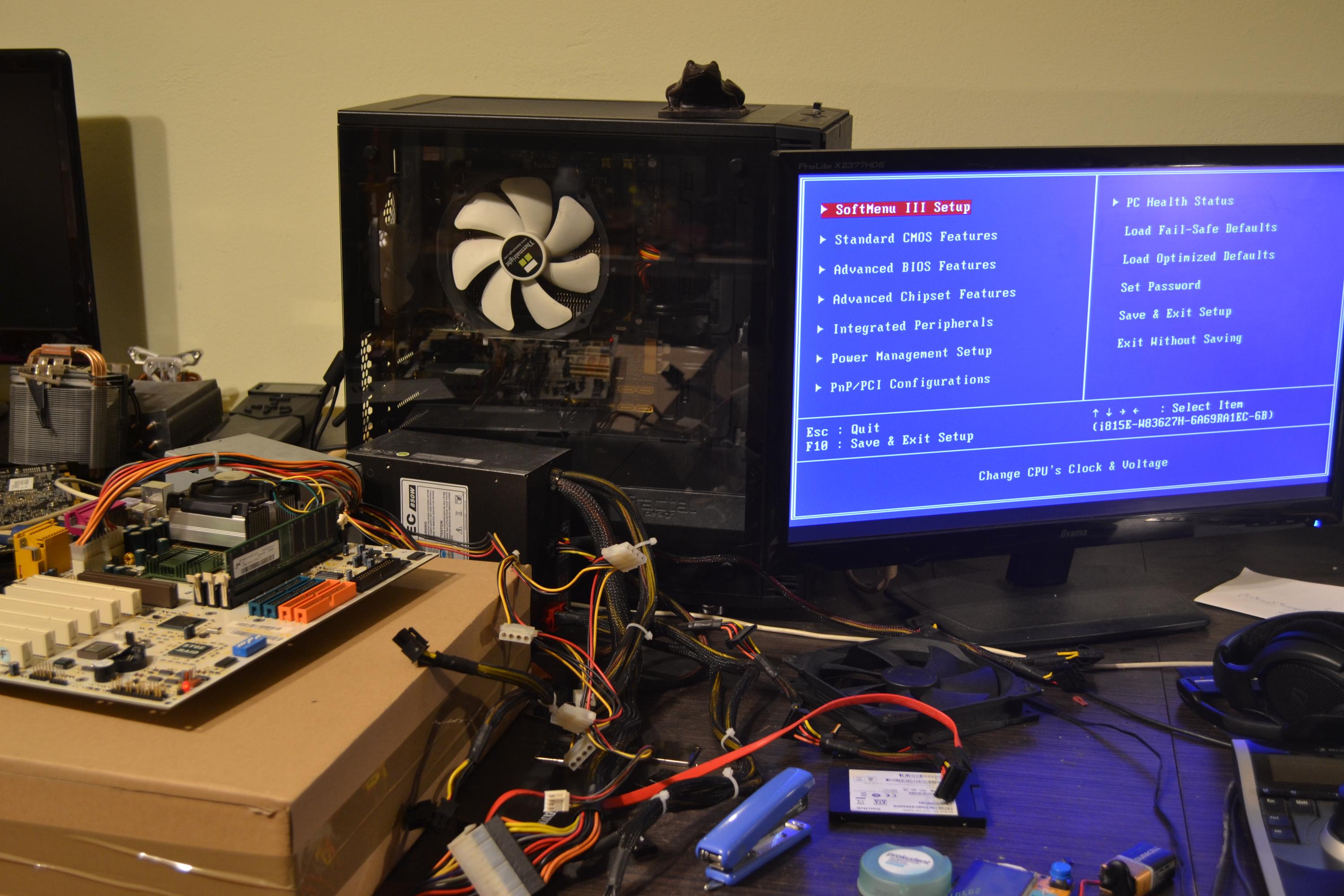

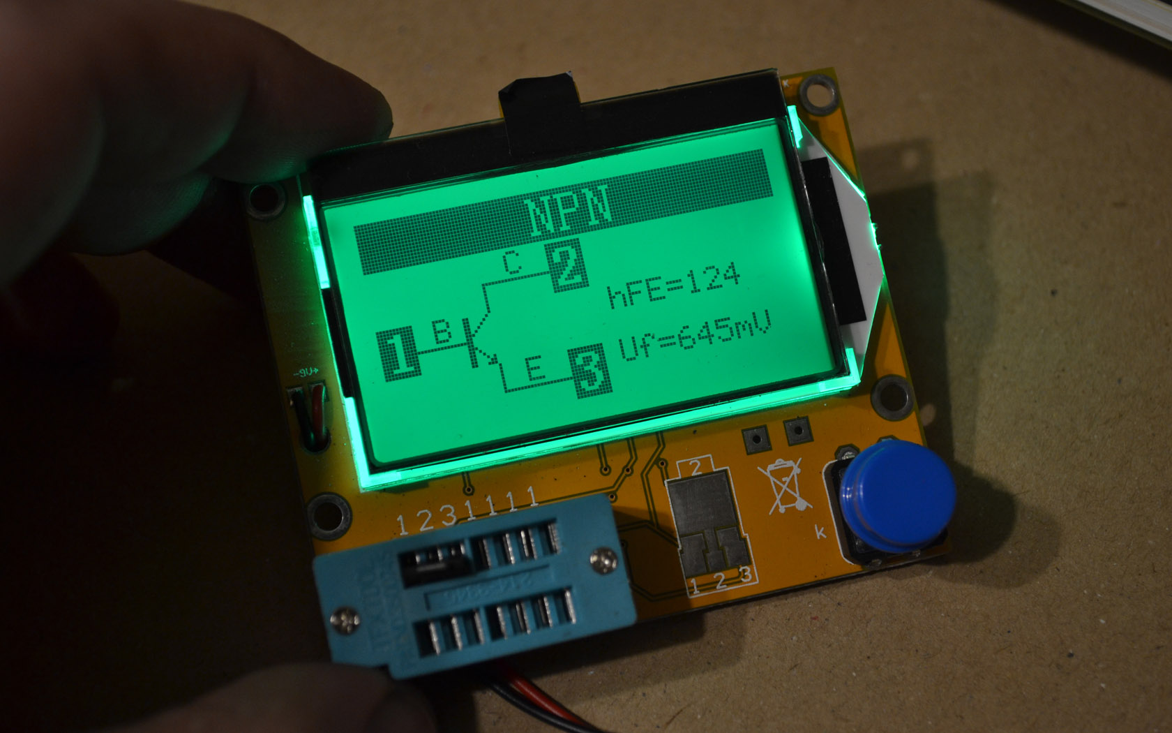

                                Replaced this transistor and it's working Thanks dicky96 for help.
                                This tester which I have show the same values for both component, looks like this transistor was leaking after putting some load on it.

                                      The transistor has 1.6V voltage drop across it so 1.25A would hit the maximum rated wattage of 2W and I would be suprised if your RAM draws more than that. I don't know though it's just a guess - how much power does PC100/PC133 Ram consume? Someone here will know.
                                      Rich
                                      Follow me on YouTube
                                      Learn Electronics Repair
                                      https://www.youtube.com/channel/UCFX...R8UZ2vg/videos
                                      • dicky96
                                        Sun Seeker
                                        • Mar 2017
                                        • 1825
                                        • Spain
                                        That should say 60V 3A 2W
