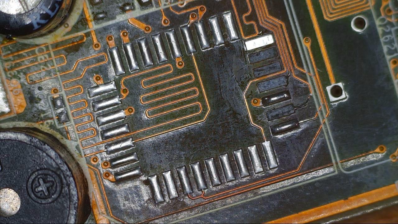

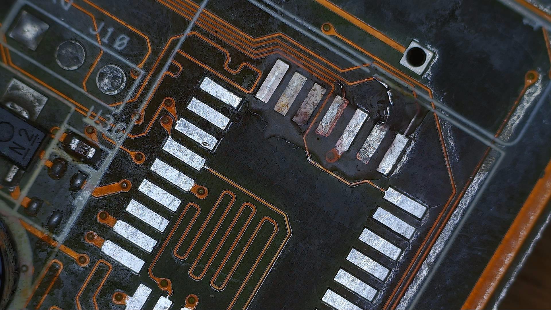

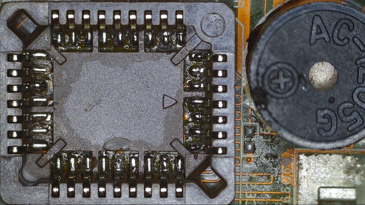

                    Well, it wasn't the bios.
                    Pulled of the bios and reprogrammed it
                    And eventually (after winding up pulling off 5 pads and 2 traces after trying more than ten times to install common plcc32 sockets with hot air, got lucky with obtaining some better plcc32 sockets, and this time putting solder paste on the pads before placing the socket on the pads and using a fine tipped iron and a microscope - which worked out very well
                    To secure the pads i used some chinese locteft 272, which is supposed to resist temperatures less than the melting point of leaded solder, and sets in the absence of oxygen,
                    cleaned up around the pads, and used uv solder mask the next day

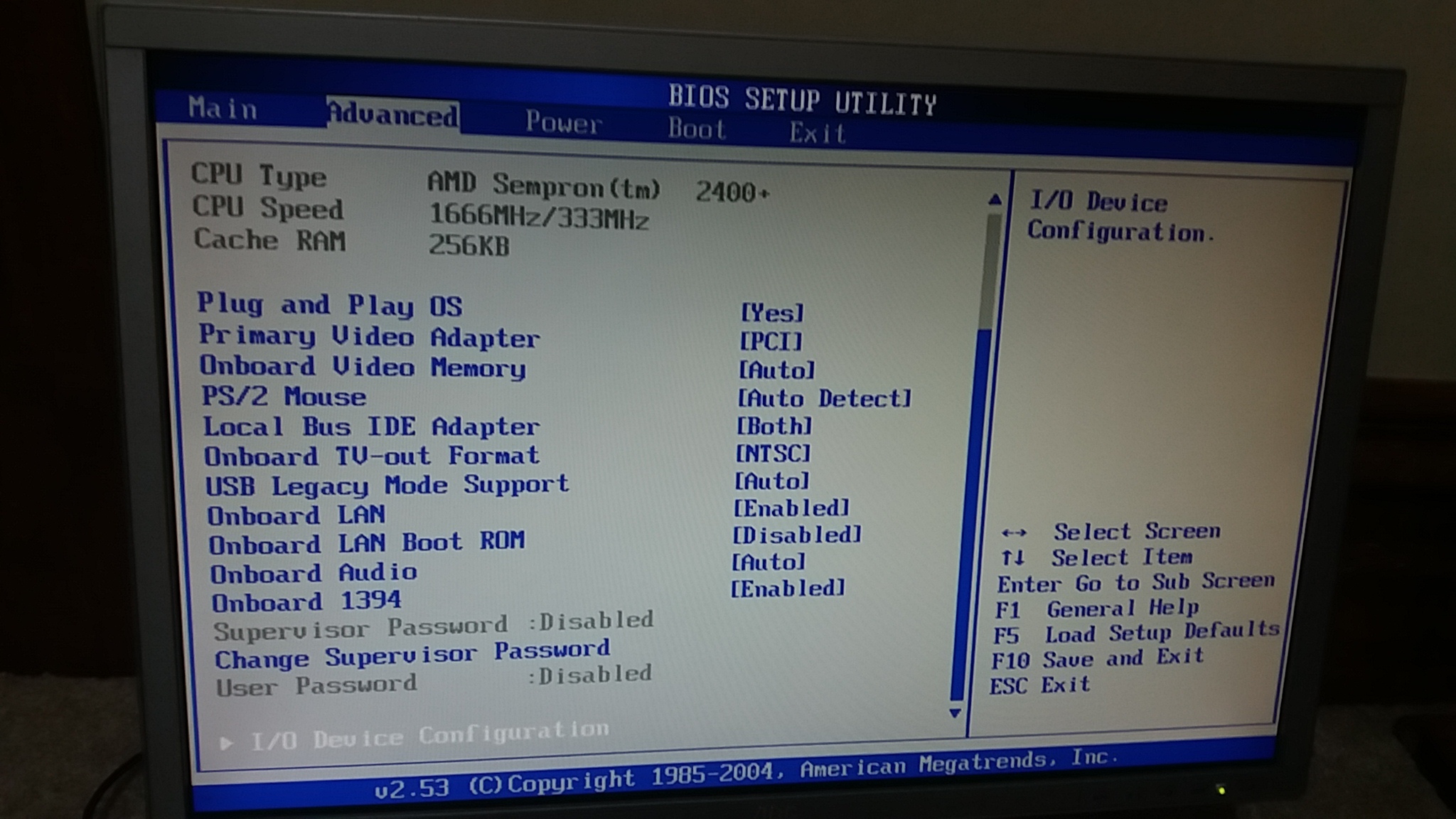

                    Then put the bios chip back in and it went right into the bios screen, but froze, IIRCC, not long after subsequent attempts just got less through the POST sequence, until 0000 was just displayed on the PCI analyser card

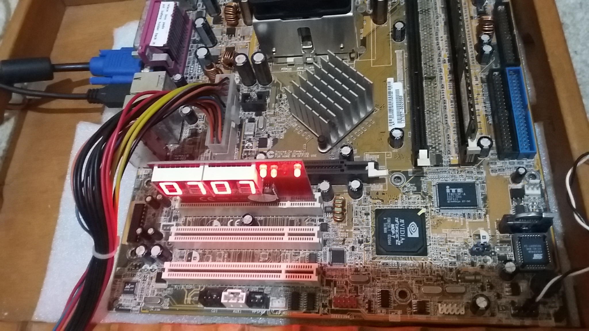

                    So decided to inspect the board and nothing seemed to be visually detached or area of discoloration due to overheating.
                    Then tried powering it on while moving a couple of VRM caps, and some digits appeared on the analyzer card
                    After lots of pushing around on the surrounding area occasionally some digits would be displayed
                    So moved to near the southbridge area, which was on the opposite corner of the board, and started pressing down on the south bridge and the i/o chip, and now eventually the board boots (for the meantime at least)
                    So now it's looking more and more like the nForce2 southbridge. as pusing down on it can get the board to go through the post sequence by pushing down on it quite hard
                    If i release the pressure when it goes into bios screen i can still move from one bios screen to another, and see that the hardware monitor is still active, but sometimes can't shut down with the power button
                    Also it won't even turn on sometimes on without pushing down on the southbridge
                    Which would it more likely be? - The chip itself, or a BGA spot not contacting one of the the pads?

                      socketa,
                      I must say, I'm really impressed by your dedication, both in terms of troubleshooting and keeping your threads updated
                      So it looks like it's boiling down to a bad solder joint, possibly.
                      I don't think (or at least I would hope so) that the nForce 2 Southbrdige chip is the issue here. It's a wirebonded chip, and these won't (or should not) have the same issues like flip-chip technology chips can... unless the chip was somehow severely overheated and for a long time. So I think it's either a BGA under the Southbridge... *OR* could also be a bad connection on the SuperIO/LPC chip. FWIW, just because there are not BGA does not mean their solder joints can't fail. Actually, if I have learned anything from the VooDoo 2 cards (and some Yamaha YMF7x4 close audio cards), the SMD soldering on chips like that can fail quite often. And seeing how close the SIO/LPC chip is to your Southbridge, I would suggest to start with that first. Take a small needle and gently shove it slightly between the pins on the SIO/LCP chip, then wiggle a bit and see if a pin moves on the bottom where it is supposed to be soldered. If it does, then that pin is not soldered properly. If all of the pins on the SIO/LPC pass, only then it might be a BGA on the southbridge. I suppose an alternative approach would be to reflow both and at the same time (well, one after another, while the board is hot.)

                        Thanks,
                        That was a good suggestion
                        I checked all of the pins on the SIO chip, as you recommended, but none of them them showed any movement
                        Of course the board starts every time now :-|
                        Initially thought that there might be an issue with the SIO chip, because the screen wasn't bringing up the BIOS setup when i pressed F1
                        But noticed that you have to press F1 just after the number code on the PCI card ticks over to the next one. (the user manual probably tells you to keep tapping it)
                        I'll put a sticker on the board that identifies the possible cause, and if the issue happens again, and i narrow it down more, then i'll update this thread, maybe after reflowing them both
                        But i'm pretty happy about getting this far, after so long.
                        Close enough to being solved now.
