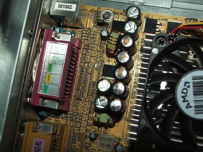

    i received this photo from Mark Jones of MASM forum who has visible fails on the GSC capacitors of his board. I hope Soltek give him some free caps also. It is interesting to see that Soltek used sanyo in place of panasonic in identical positions to previous posts.
    here is the thread
    http://www.masmforum.com/simple/index.php?topic=1939
    we wish you success with the recapping Mark. Any questions, please let us know. We welcome MASM members to our forum for discussion on badcaps.
    Thanks to MD_Willington for confirming Soltek provision of high quality replacements.

    Yuck!!! GSC caps just like with the Epox 8RDA motherboards!!!
    BTW, the same motherboard I was talking about last July with Wendel caps still don't have any bulging and is still stable!!!! It passed a 12 hour run of Prime95.

      Ok I tested the RAM with another PC, no errors. I also tested the Soltek board with another PSU (brand new) and I got even more errors!!! Right now I'm changing two of the 1500uF which are in upper left of the socket. There are two more 1500uF by the left side of the socket, but I dont have any more parts. The cheapstakes at Soltek only include one 1500uF cap in their repair kit while the board has 4 of those. I'll test the board again tonite.

        You could probably use a 1800 or 2200 in place of the 1500...
        I recapped an ECS board with 3300's that used 2200's...works just fine.
        Usually if you google Jessica@Soltek you will be able to find her correct email address, if that does not work, I'm sure Topcat can help you out.

          I just realized that my vga card was missing a small cap (5.5uF). I replaced it at work, lets hopes this is it. I also realized that the 1500uF caps on the soltek board were made by Sanyo, but I went ahead and replaced them anyways. Those caps were not domed but they had some kind of residual corrosion on top, like some white stuff.

            Well I replaced all the capacitors and added the missing cap on my VGA card, the result??? 96 errors at Test 8 [Modulo 20, ones&zeros] in MemTest86. I'll test the vga card tomorrow in another PC. I hope, really hope its not the CPU or the VGA card.
