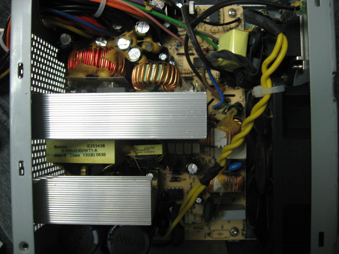

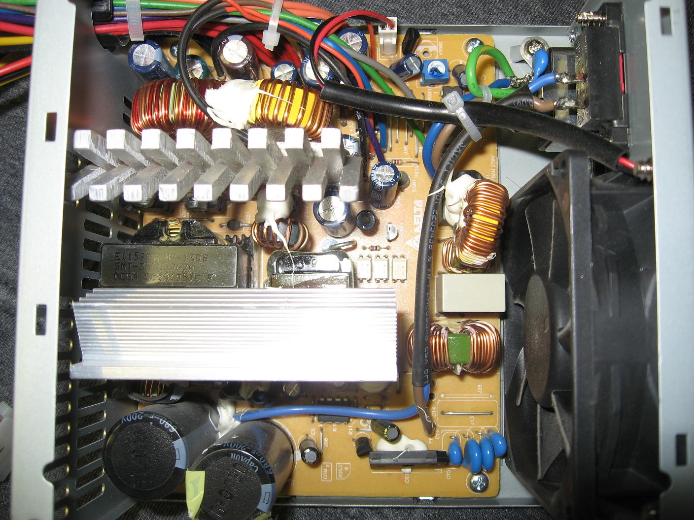

    Thanks again everell here are the measurements as suggested
    Bestec
    vsb 4.8v, Red 5.08v, yellow 12.16 volts and orange 3.32v
    delta
    vsb 5v, red 5.16v, yellow 12v orange 3.37v
    Pic attached show 001 delta psu and 002 bestec
    hope this can helps

        Voltages on both power supplies look OK, and the photos look good. I did not see any bulged capacitors, nor did I see any burn areas on the pc boards indicating a problem. Usually the Bestec will have a burned area near the small transformer if it is giving a problem.
        Next step - make a list of the capacitors in the power supplies and on the motherboards. The capacitors need to be listed by brand, capacitance ( a number followed by uF), and voltage. The members on this site will be happy to tell you which capacitors are the potential problems and need to be replaced. I would go for cap replacements next, then consider reflashing the bios chip if it still doesn't work. There is a guy on ebay that will reflash you eprom for about five bucks. I have had him do it for me on two motherboards that were dead. Worked on both of them.
        Both power supplies working is good news. The mother board that spins the fan and can be stopped shows that the southbridge chip is not blasted. If this board had a catastropic surge, I would have expected the southbridge chip to be shot. So I think there is hope for this board. As we continue, you might get the other board to work also. One of the boards that I did the reflash on the bios chip was totally dead, and would not spin the fan. So you never know till you experiment, and learn lots of new things about computer boards.
        If the southbridge is working, I would think the northbridge is PROBABLY working also. No need to unsolder it and take it off the board. Do both of these mother boards have on board video? If they do, the mother boards will have a video connector soldered directly to the mother board.

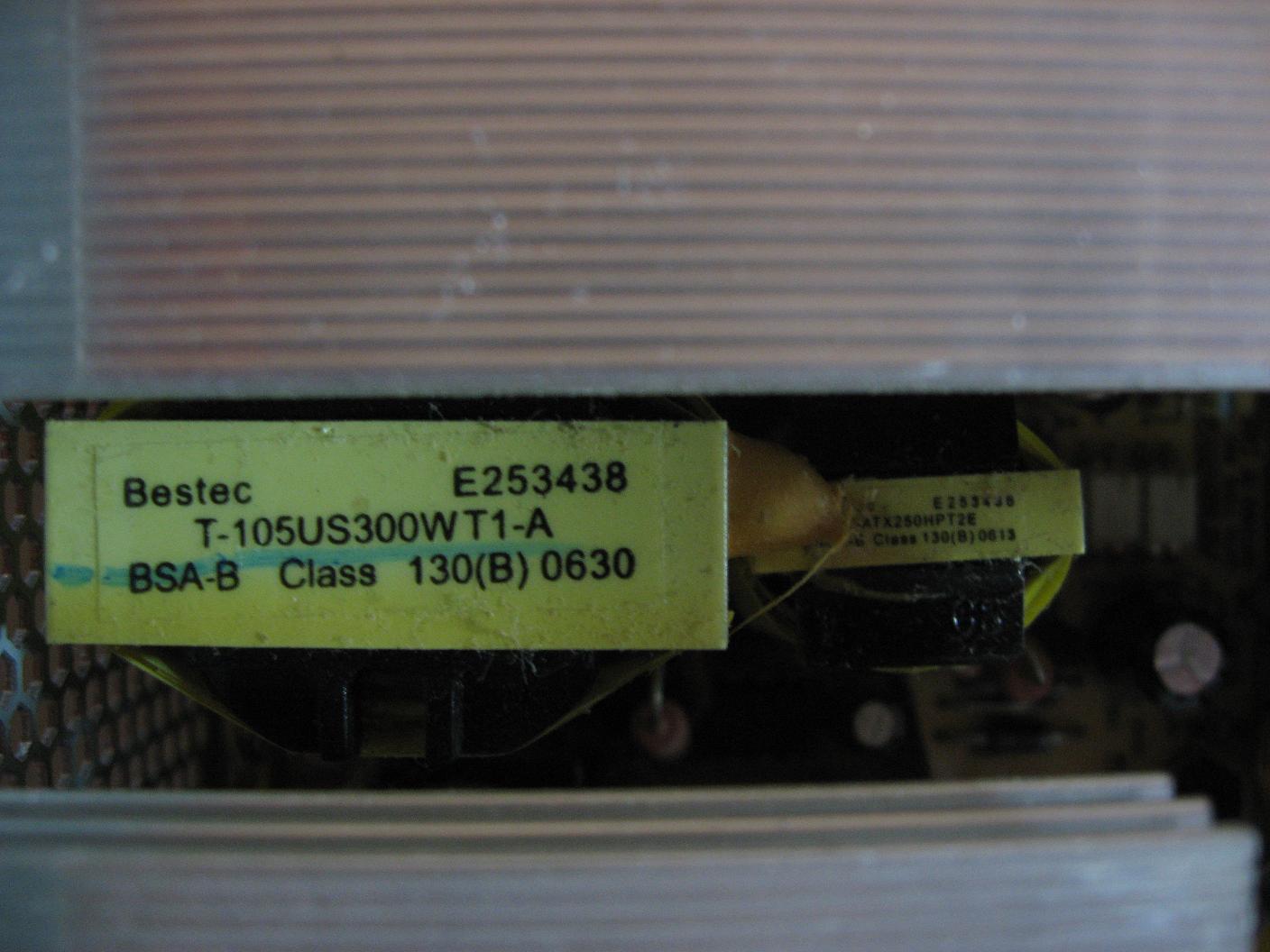

                          I would like to comment further on your Bestec power supply. I have a Bestec ATX-300 12E Rev. D which looks different from yours. Mine has two 8 pin integrated circuits between the two heat sinks. One is a UC3842 which is the main PWM chip. The other is A6351A which is a PWM chip for the 5vsb circuit. In the picture you posted, I saw only one chip. Check and see if your power supply has one or two chips, and what number is on the chip. If you only have one chip, look at the heat sink nearest the two big capacitors. Does it have one or two transistors screwed to it? One transistor would be much larger than the other. A few more pictures would really be appreciated, especially close up between the heat sinks.
                          What concerns me is that you may have an early model of the Bestec ATX-300 12E, and it may have the mother board killer circuit in it. If so, you will need to replace it.

                                          There ar two chips between the heat sink. The large one is T-105USWT1A and the smaller one is T-ATX250HPT2E. There is only one transister screwed to the heat sink closest to the two large cap
