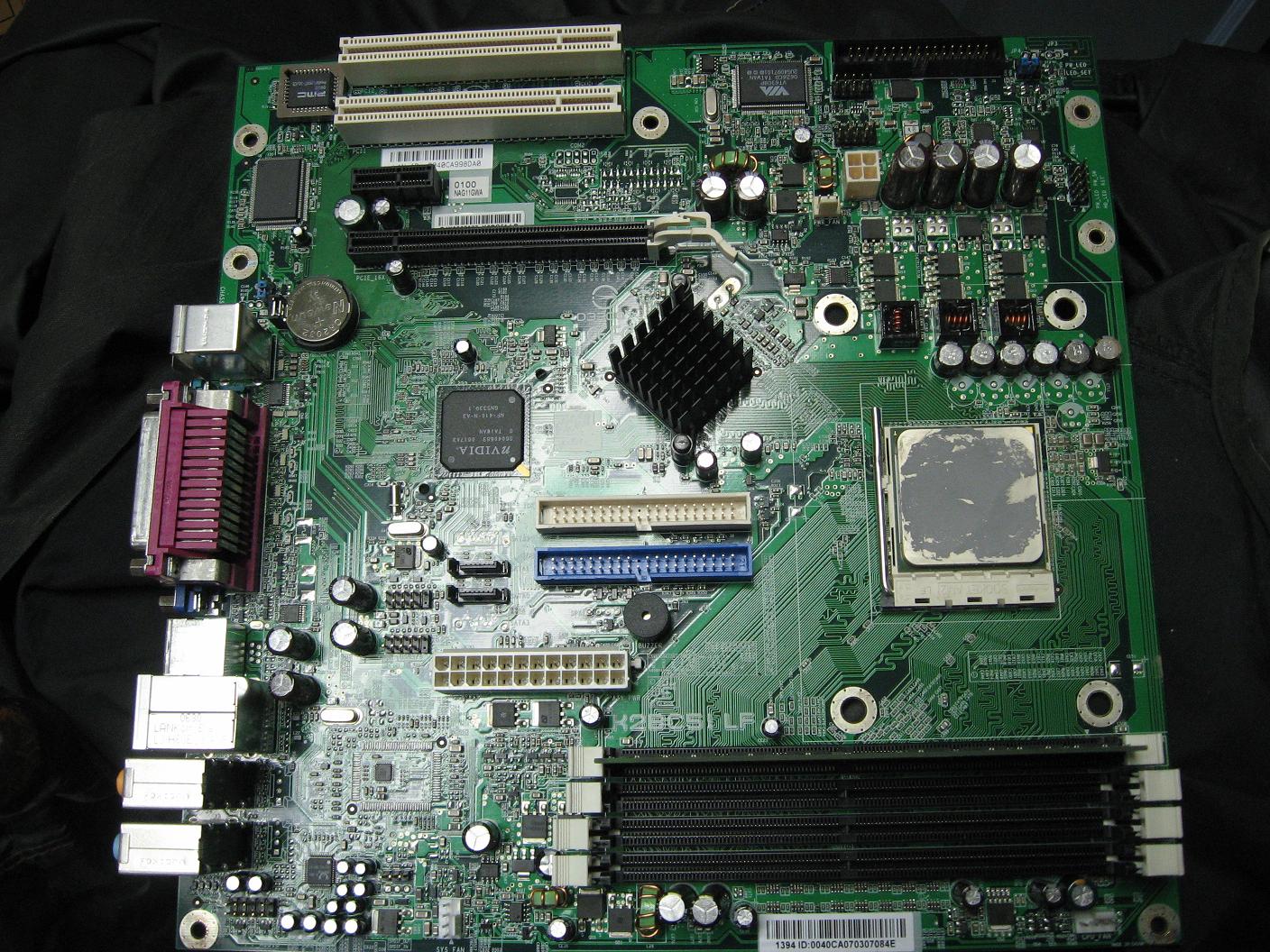

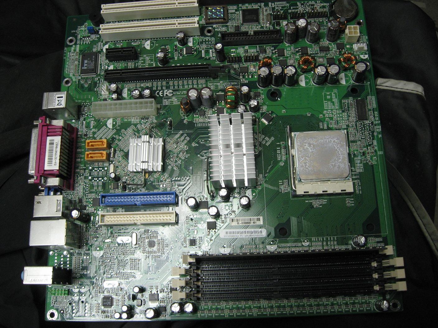

    I have two gateway desktops a gt5082 and a gt5232e. One starts up with both fans going but no video. (no ram installed and no hd) The other only shows the blue led light on the front panel. I have swapped the cpu and the ps but no difference. I am not sure how to ask the right questions but any help would be appreciated.
  • davg
    • Sep 2008
    • 536
    Re: gateway desktop no post
    My question should have been "Could this be a cap problem? I do not know the history of the unites or what happened to them as I was given these in hopes of making one out of two.

          Thanks for the reply I have the case open on both and there is no sigh of swollen caps. I swapped out the PS (one to the other) and there was no different. One still starts the cpu fan and the cabinet fan and the DVD Rom will open and the other one nothing just the power light on.There is ram in one unit but that is the one that only shows the front panel blue light. Do I need ram for it to post the bios? I will post some pictures of the boards. The power supply is 300w in one and 250w in the other.

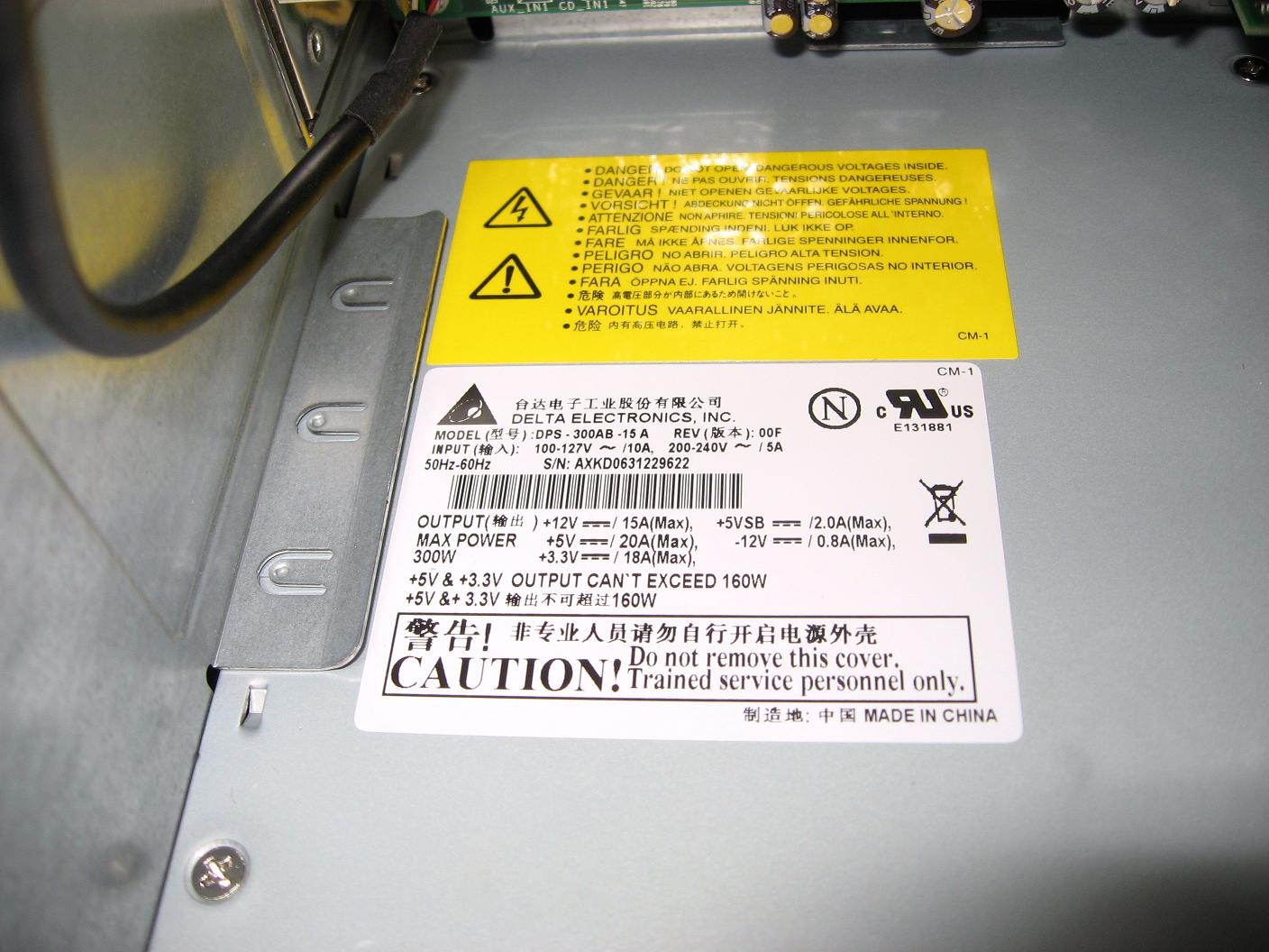

                Here is a photo of one of the power supplies and the other is a Bastac model Atx-300 12EB3 Rev-S2R

                  thats a delta.
                  those are usually very good

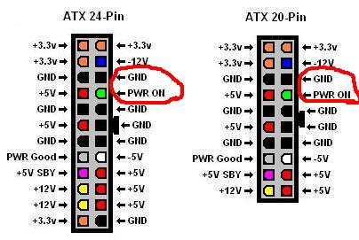

                                      In trying to answer your questions, a lot depends on how far you want to go with this project. Anything can be fixed given enough time and money, but sometimes is not worth it. If you are up to the challenge, lets start with the power supplies. You have a voltmeter, so lets put it to work.
                                      On each of the two power supplies, plug one of the power plugs into one of your CDROM drive. Do not plug power supply connector into the mother board. On one of the other power plugs normally used for CDROM or hard drive, insert the negative side of the voltmeter (normally the black probe) in one of the two center pins (black wire). This is the power supply ground. Plug AC cord into power supply and other end in wall socket. Now using the positive side of the voltmeter (normally Red probe) measure the voltage at the motherboard connector pin where the violet wire comes in. It should measure 5 volts DC. This is your 5vsb (5 volts stand by) measurement.
                                      Now unplug the power cable from the wall socket (for safety) and put a jumper wire between the green wire and an adjacent black wire in the motherboard connector. Plug the power cable back into the wall socket. Now measure the other power supply voltages according to these colors:
                                      Red is the +5 volt
                                      Yellow is the +12 volt
                                      Orange is the +3.3 volt
                                      Write these voltages down on a piece of paper for each power supply as you make the measurements. Then let us know what you found.
                                      After making the measurements, unplug the power cable between the wall plug and the power supply. Take the screws off the power supply cover, remove cover and take some pictures of the inside of your power supplies. Sometimes we can spot problems from this.
                                      After checking out the power supplies we can do more with the motherboard!

                                        Here is a picture of the ATX connector which connects power supply to motherboard. This shows the colors of the different wires and what voltage should be there. The two pins which are circled is where you insert the jumper wire after verifying that the 5vsb is working.
