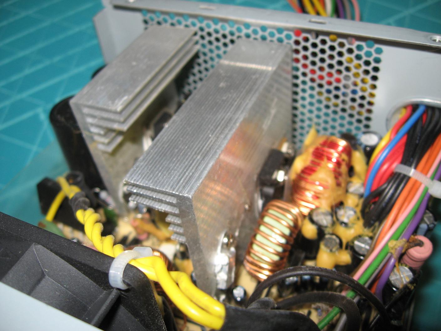

    First, lets clear up some questions about the Bestec power supply. The last photo you posted showed the output side of the power supply. There are two semiconductor devices screwed to the heat sink, both are diodes. I also see some crud on the top of one of the capacitors. Check this closely as it is probably a bad capacitor leaking.
    What I am looking for is to see if there are two transistors on the other heat sink - on the other side of the pc board. See if you can get pictures of what is on the other heat sink.
    Old proverb say.........If you shoot at nothing, you will hit nothing (George Henry 10-14-11)

      Re: gateway desktop no post
      Thanks I tried to get pic between the heat sink but what I posted is the best I can do but yes there are two (what looks like transistors) screwed to the other heat sink? one larger than the other. I can't get a pic nor can I read the numbers on them. The crud you see was added at the factory I checked all caps none seem to be leaking.

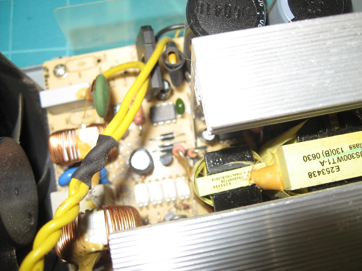

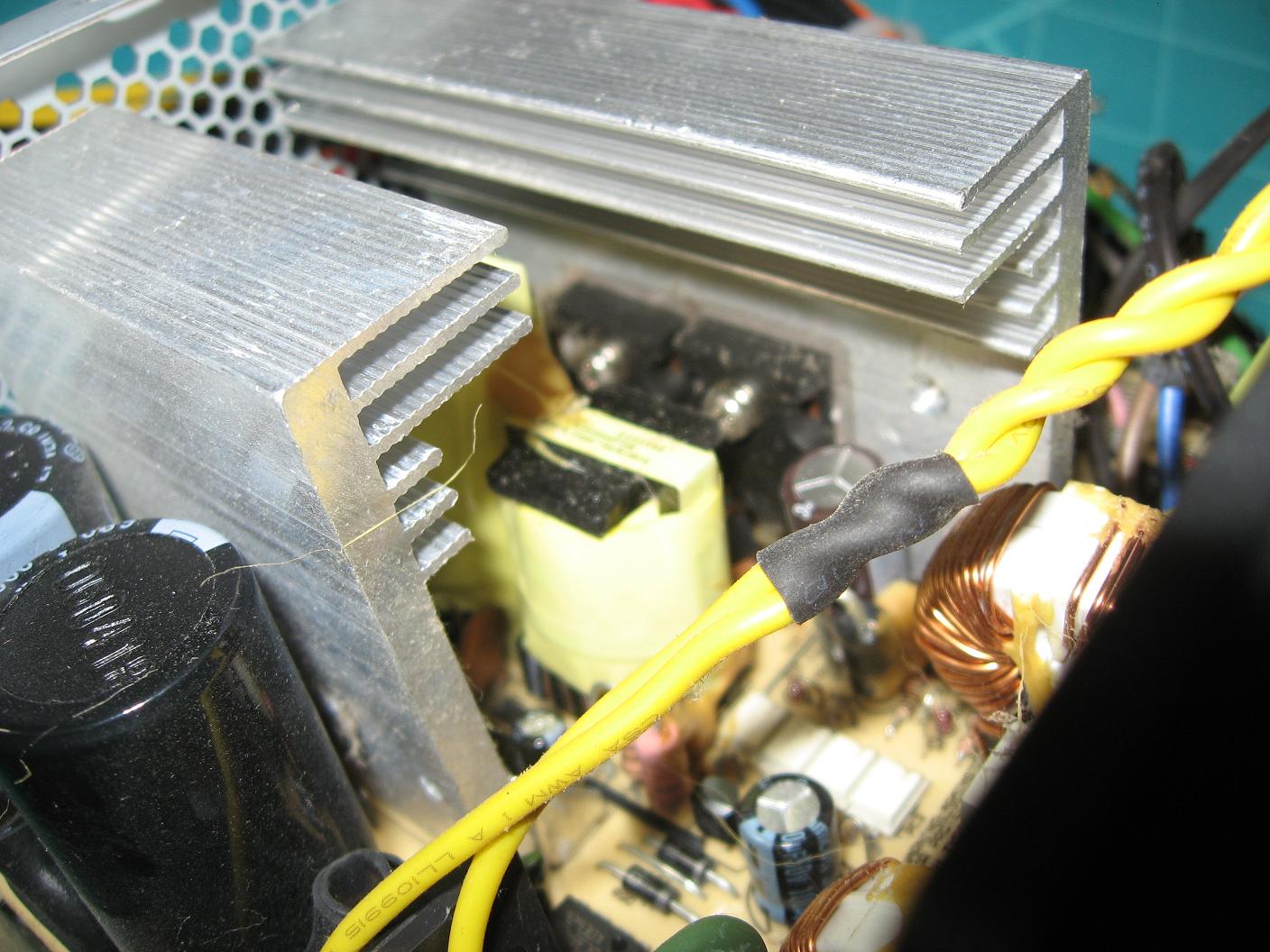

        The two numbers you gave earlier to identify the two "chips" are the numbers on the two transformers. Since there are two transistors on that heat sink (I don't need to know part numbers), there should be only one chip (integrated circuit) located between the two heat sinks with part number UC3842 written on it. It is a very small device having eight pins, four on each side, soldered to the pc board. See if you can find it.
        There are four optocouplers on this power supply, giving added protection which the killer Bestec ATX-250-12E does not have. But the 5vsb now looks to be the two transistor circuit design which at this point is very questionable. Until your electronics experience increases, I HIGHLY recommend that you set the Bestec aside to play with later. The consequences could be killing a perfectly good mother board. So far, looks like it did NOT kill the board it was originally powering, but no sense in taking chances. Don't toss it, just don't use it for now. Do you have another power supply that you can use for testing the other bad mother board?
          Sorry for my lack of knowledge but there are two of these 8 pin chips near the heat sink one that you saw at first is UC38420 and the one right between the heat sink is a A6351A. Yes I do have an extra power supply that I can use to test the other board.

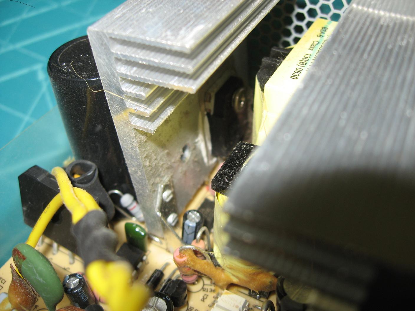

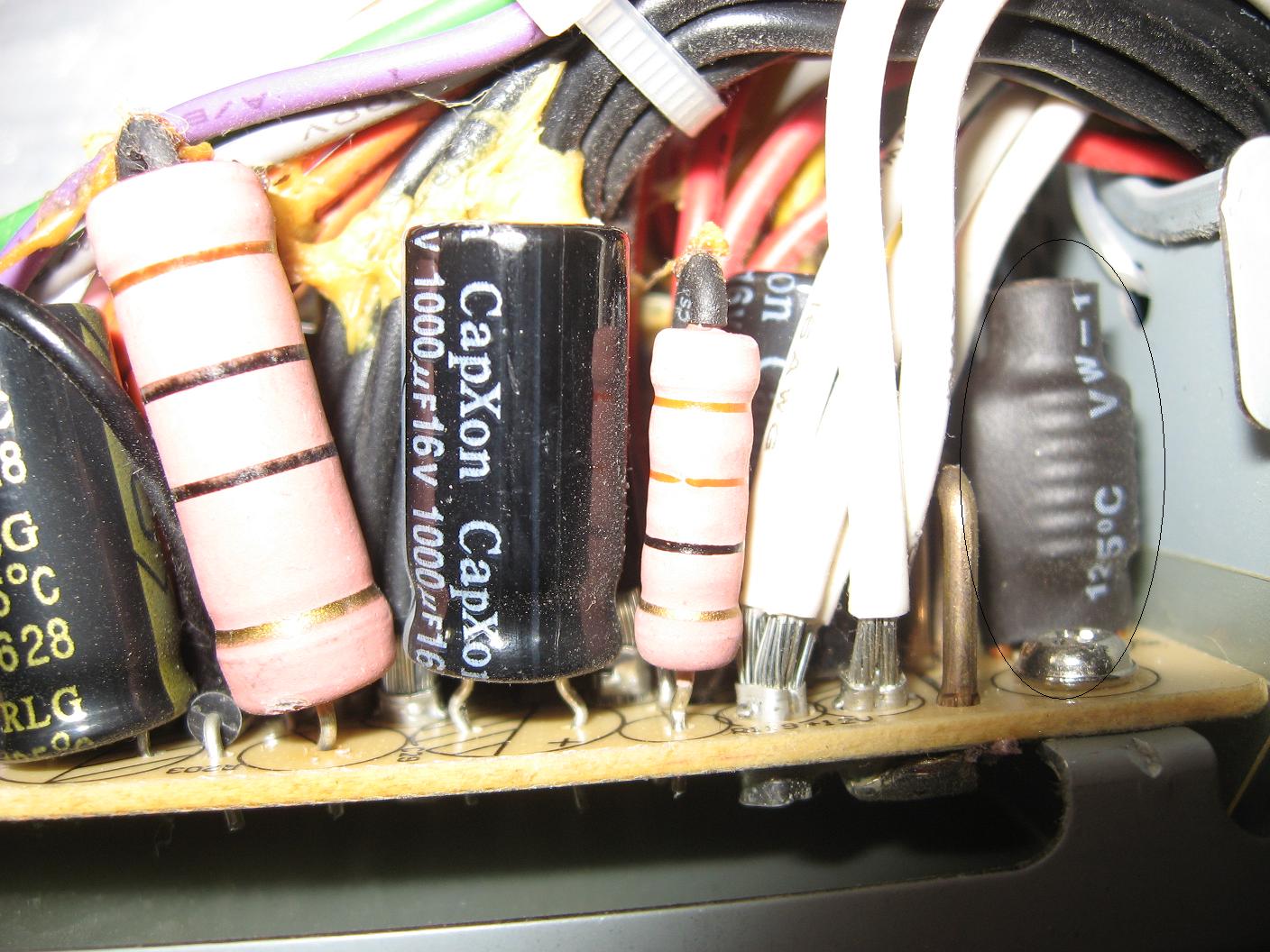

            Maybe these will help? On closer look at that cap that appeared to be leaking It do look like some leaking but it is not a regular cap it looks like the one in the last pic?
            • everell
              • Jan 2009
              You are doing a good job and learning quickly. Now you can identify what the chips (integrated circuits or ICs) look like and what the part numbers are. This is very important to know how to do.
              The pictures were great and showed what I needed to know. Identifying those two chips helped to verify that the Bestec power supply you have is OK to use. It has the PWM chip in the 5vsb circuit along with the four optoisolator chips for added protection. You can go ahead and use this power supply without worry about the "Bestec spike of death" you will hear mentioned so often on this website. You have the good one, not the mother board killer.
              Next post I will try to give some ideas on troubleshooting the bad mother board.
