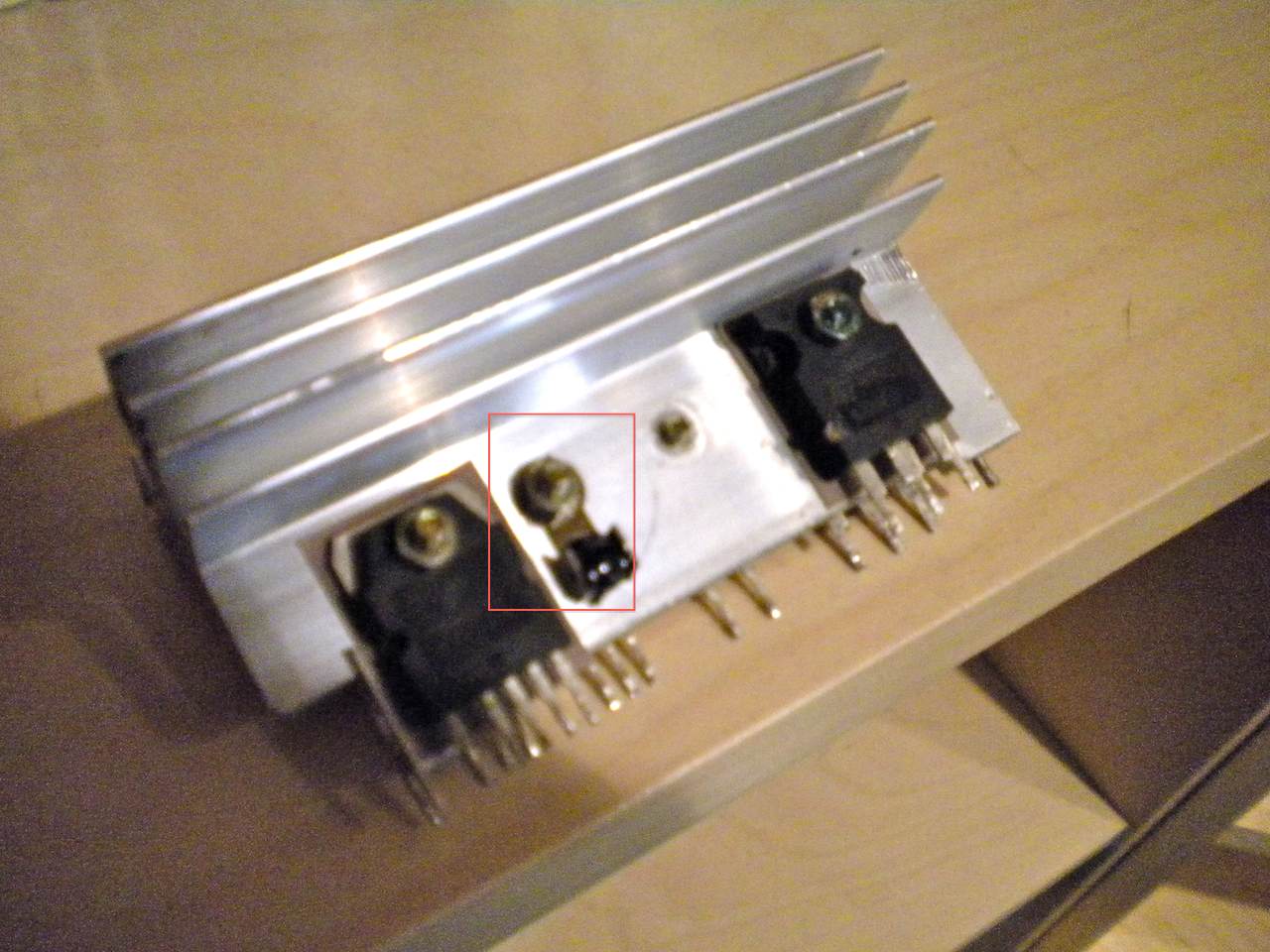

              Now for a kicker, While removing the heatsink to replace the switchers on unit #2 I forgot to unsolder the leads to TH3 and severed them
              Since the other unit is back in service and operational, I again don't have a reference for part #.. I did while the other unit was repaired managed to get 86.4 Ohm reading from the other unit (at room temp 75f).
              TH3 is tiny and bolts to the heatsink via a small metal bracket.
              I was wondering if you had during your tear down and testing/repair happened to get a part # for TH3.

                  So I took the part of the heat-sink and there is no markings or part # on the bracket or Thermistor.
                  Taking closer inspection, it appears that the Thermistor was glued into the metal arm for bolting to the heat sink due to very limited air flow or to prevent damage or short against the heat-sink upon installation.
                  I have been able to determine that the Thermistor is aprox 3mm and lead spacing of approx 2.50mm - 3mm
                  Plugging in the dimensions there is really only 2 units to choose from
                  http://search.digikey.com/scripts/Dk...me=570-1088-ND
                  and
                  http://search.digikey.com/scripts/Dk...me=570-1087-ND
                  The Ohms rating varies greatly between the two.. my measurements were 86.4 Ohms with the meter on auto.

                    Marking on ring tab: 10850
                    Measures ~85Ω @ room temp
                    When heated, it seems to "trip" to a high resistance of over 200Ω. It is not linear in it's resistance compared to temperature and seems to be more of a switch than thermistor. It is connected to the PWM board nearby and is most likely for thermal overload protection.
                    Might try some old PSU's for a similar type device.

                      #50
                      Re: PowerMac Dual 1Ghz Mirror Drive Pop&Burn Power Supply
                      @ Toasty,
                      Thanks for the info. This is pointing me towards what I "think" is needed.
                      I really appreciate the help.
                      So going off what you have discovered and that the values increase based on temperature, I searched high and low for a thermal switch
                      Below is my results and looks to be the closest match I could find.
                      There are 4 available temp cutoff points, according to the Data-sheet.
                      Here is a pdf link for the product, under TS3 Series Moxie (figure 3 style):
                      http://onlinecatalog.digikey.com/Web...ageLabel=2141#
                      Switching temps are 57, 65, 75, and 85c
                      Now I would probably go with the 85c as the board components get pretty hot lol.. So I just need to guess on a median temp cutoff point.

                        The Moxie are NTC (like TH2). You need PTC. Resistance increases with temp.
