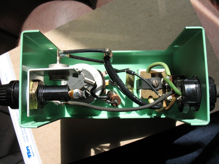

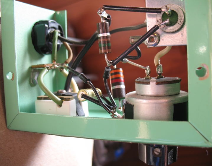

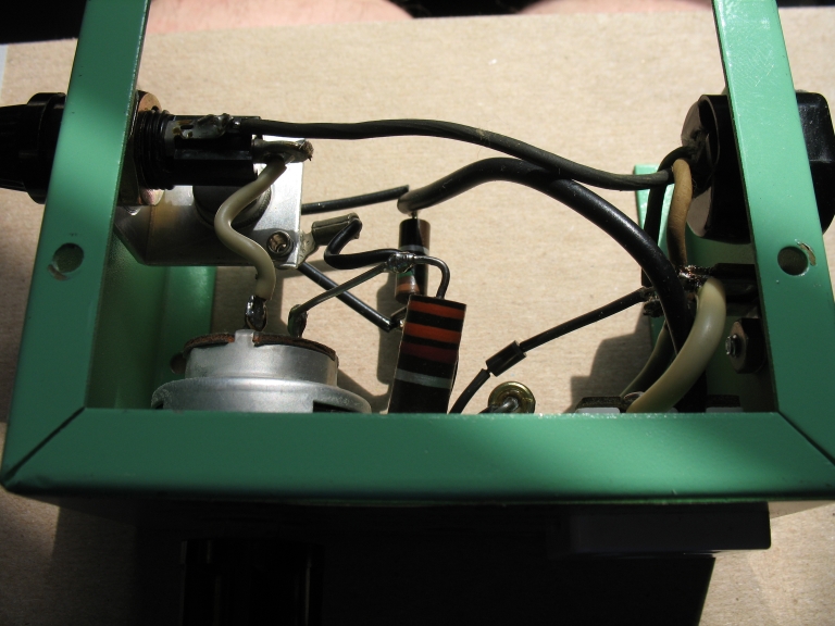

    darn - I tried to add a few pics to that last post on the innards of the speed controller, but was too late to edit.
    Anyway, if you're wondering just what exactly that speed controller has on the inside, see the additional pics.

      Speed controller in essence is a high powered lamp dimmer. Not usable in this situation. Inductive loads could easily damage the unit. Incandescent lamps only or AC-DC motors (i.e.- Dremel tool), as the label says, are fine.
      If the cap shorted then went open, it could take out the rectifiers and the MOSFET's as KC had reported.
      I can't get the right symbols for the circuit program and I don't have a scanner else I'd draw the setup in a minute for the test lamp circuit. BLEAH!!

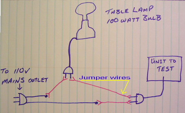

        Did it with the camera. See attached.
        The bulb is in SERIES with the load; in this case, your PSU. Do not connect any load to the PSU. The bulb should come on briefly as power is applied and then go dim. If there is still a short, it will come on and stay on very near to or at full brightness.
        The jumper wires are test leads you can acquire at Radio Shack or a similar store. They are lengths of wire with insulated alligator clips on the ends. Heavier is better.
        I recommend you do this on a switch controlled outlet, in case something goes totally FUBAR you can kill the power. ( unless the circuit breaker beats you to it )
        Ask questions if you're unsure of something.

          Cool, that looks pretty simple. I could probably do that wood platform thing and just mount a 15/20A GFI outlet on there, yes? What about grounding?

            Don't complicate this. It's a simple "plug in to wall outlet" tester. Respect the AC mains but don't fear it.
            The bulb will limit the current to less than 1 amp. You could start out with a 60 watt bulb which will keep it at 1/2 amp or less.
            Since KC has had no input since the initial, PM him and ask him to respond here on what he did and which MOSFET's (location) failed.
