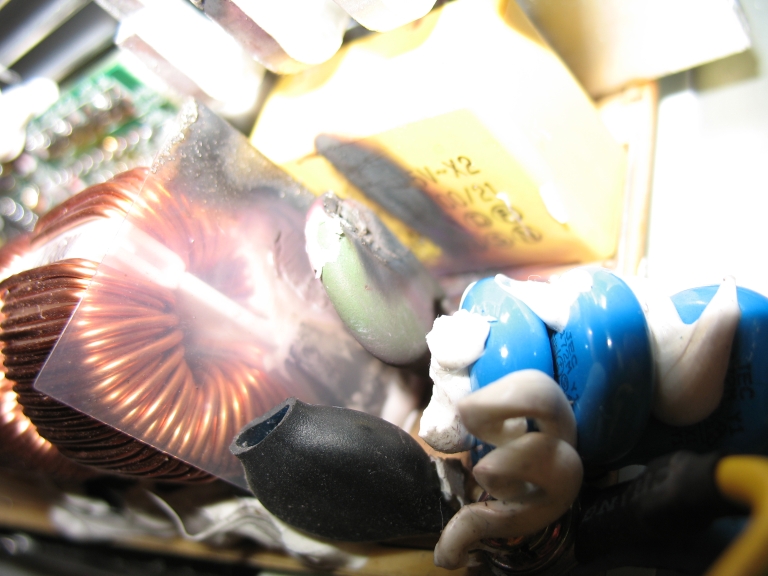

    Hi everyone!
    I have now, a third in my Mac PS series.
    this PS comes from a PowerMac 1Ghz G4 Mirror Drive computer.
    Sadly, this one appears in the worst shape, as compared to the others which required simple low voltage recapping to regain functionality.
    This PS is a Samsung 360W PS (see pics for exact info)
    Symptoms: Computer wouldn't cycle, so I pulled out the PS, and opened it up (much easier as they didn't use those stupid anti-tamper screws with the protrusion in the middle of the Philips socket - good thing I have a Dremel!).
    Noticed a burnt fuse, and thought, oh! could it be that simple?????
    Bought some 250V 8A fuses, popped one in, and, "Pop! Fizzle! Light! Stinky!"
    Hrrm...well, that's not good. I took a look and discovered a nasty burn spot right near the AC in point. I've detailed this in several pics shown below.
    So, my questions, being a non-electrician:
    1.) What do you think happened?
    2.) What are those two components? Is the yellow a rectifier, what's the green one with a burnt "whole" on top?
    3.) Is this fixable?
    4.) If yes to (3), what are your suggestions? I guess I can get replacements online, as I have with capacitors.... right?
    Thanks, guys.

    Re: PowerMac Dual 1Ghz Mirror Drive Pop&Burn Power Supply
    i have one on the bench now.
    but i saw the hard blown fuse and investigated the cause.
    your burnt part is temperature dependant resistor that serves as a "soft start"
    with a dead short they sometimes blow up before the fuse opens.
    mine had an open main filter cap and 2 shorted mosfets in the apfc section.
    the replacement mosfets arrived yesterday so i will complete it soon.
    i autopsyd the cap and the foil connecting from the plate to the terminal was blown open.the cap itself is dry and shorted.
        -mains cap shorted
        -bridge rectifier shorted
        -power MOSFETs shorted
        -Yellow plastic devices are X type interference suppression caps; usually metalized polypropylene or polystyrene in construction. Connected across the mains, their used to limit line interference from or to the unit.
        -Green burnt device, as KC said, is a current limiter. It's a thermistor of the NTC (negative temperature coefficient) variety. Initially it has a high resistance and as it warms its resistance goes down. It's there to stop, under normal circumstances, the blowing of the fuse from the high inrush current when you power-on the supply.
        -Most likely
        -check the items I mentioned in the first answer. KC gave you the clues for the mains cap and MOSFETs.
        -Yes

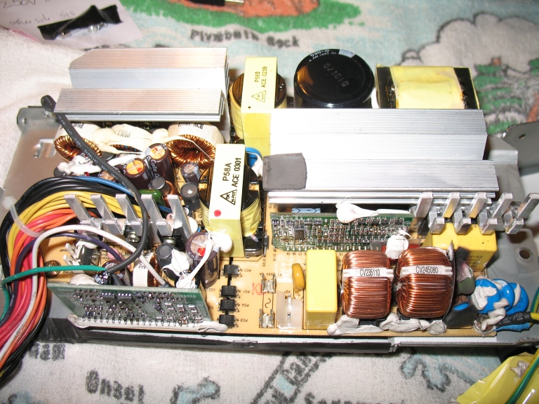

          Ummm.. hi!
          I understood everything up to the "...sometimes blow up before the fuse opens.." part. Then, you lost me.
          Open main filter cap is the big black mutha across the board from where this blew.
          Shorted MOSFETs in the APFC section. MOSFETs are the devices mounted to the heat sinks.
          APFC is Active Power Factor Correction and improves the PSU's efficiency.
          Care to bend your mind a bit? - http://en.wikipedia.org/wiki/Power_factor
          Pay attention to the lower half of the page starting with "Non-linear Loads". It's an explanation that requires a bit of an egghead. Mine hurts right now... :p
              There is a guide on here somewhere for testing MOSFETs. What you're looking for is most likely shorted components. Make sure you discharge that cap before you try to read it. Use volts scale first to be sure it's discharged.
              KC should have some answers as he said he's got one now. He can point you better. Me, I need pics to tell you what to look for and test.
              You might want to pop that out of the case and make sure nothings burnt underneath.

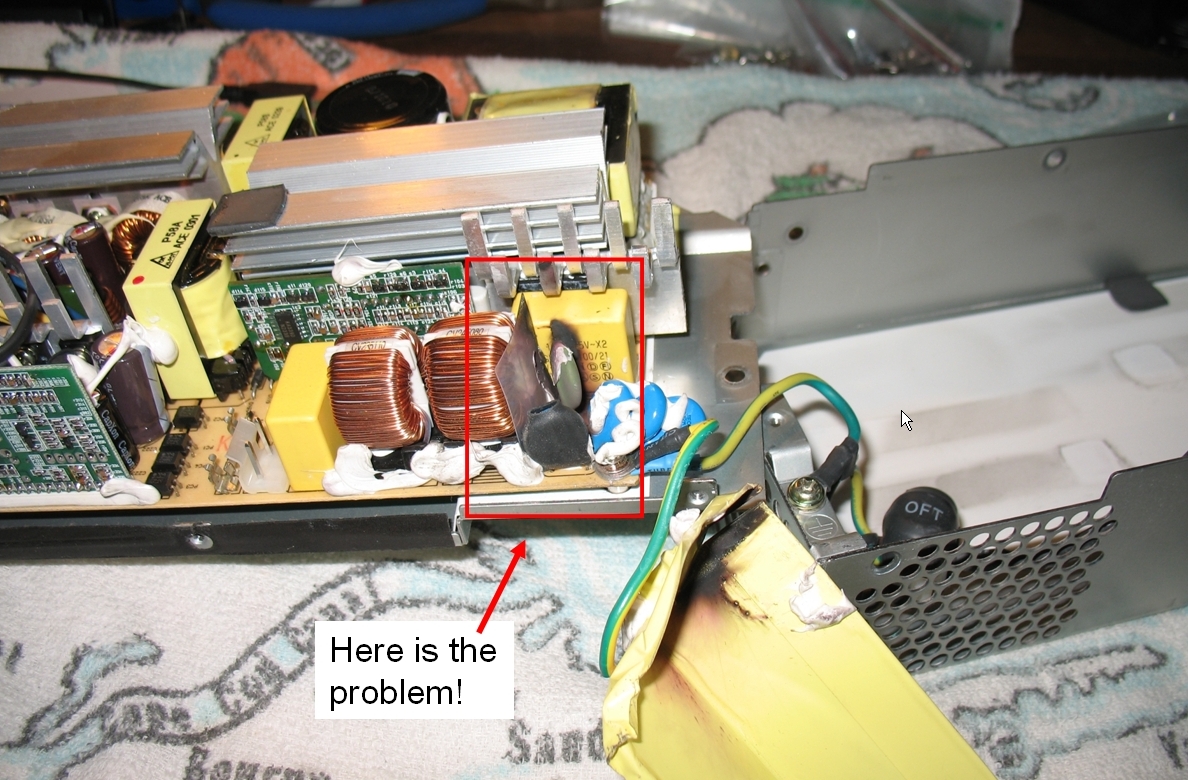

                    I completely removed the board from the casing, and see no obvious damage on top or bottom, besides in the pics I showed you. Nothing appears bulging or anything
                    So, I've been playing around with my multimeter.
                    I haven't removed anything from the board, so I don't know if any of this is accurate.
                    I tested the capacitance (uF-2000) of several caps on the board, and the resulting values were all within about 30uF of the rated value. When I tried this with the main cap, by touching the cap leads on the underside of the board, I get nothing. Does this mean anything, as it is still soldered to the board?
                    I've been trying to test some of the MOSFET's, according to instructions here I believe I correctly identified the Source/Drain/Gate pins, but I can't seem to see what they describe. After setting my multimeter to the diode position, If I touch the two outer pins, I see no value. Touching what I think are the source (black) and drain (red) pins, I simply see an accumulating voltage starting at 0.000v, and slowly climbing, until I remove the probe tips around 0.8xx v (though it would go higher, I think). But I can't seem to discharge by putting my finger over the leads while maintaining contact with the probes. Again, this is all done while they are still on the board - does that make a difference?
                      Reading the "When MOSFETS fail..." paragraph is what you're looking for. A failed one usually goes shorted -zero ohms- drain to gate. Or, is obvious by a hole in it or a chunk blown out or a fracture of the casing.
                      On the board testing is not reliable as the other components interfere. I think they are talking in that how-to about a loose in your hand unit or at least one that's desoldered from the circuit.
                      The mains cap should read something. Try an ohmmeter across it and see if you get any reading connecting first one way (red + / black -) then the other with your leads. You should see a lower reading that rises in one of those hook ups. If not, it's time to desolder at least one leg and try that for a uF reading. You may have the same situation that KC found, that being the cap is open circuit - no connection.

                        Hrrm. So, following Toasty's suggestion, I set my multimeter to Ohms, and tested the resistance across the soldered leads of the big black cap
                        I get a reading of 0.435 M Ohms (black to neg, red to pos, OL when reversed). Umm..does that mean anything regarding whether the cap is good or not? Am I still going to have to desolder it?
                            >>OL when reversed<<
                            What does that mean?
                            The readings sound high to me on the cap. Plus, you should see a rise in the reading at least in one direction. I'd just desolder a leg or both and pull it to test. The board isn't double sided, like the iMac was, so it should be fairly easy.
                            The readings on the MOSFETs would indicate they are not shorted. You are likely reading the other components in the circuit.
                            Is there a bridge rectifier in that PSU or individual diodes? I would check it/them as I indicated in my first response. It/they may be shorted.
                                >>that's out of limit/range, no reading.<<
                                I think then that the mains cap might be open.
                                >>regarding testing it, I just need to do a continuity/resistance test, correct? I should see different readings in each direction (high vs. low)...<<
                                Use the diode-check function and you should see high one way and low the other. The bridge rectifier packs are usually marked. Each of the 4 pins is 2 diodes connected as follows-
                                Set 1: Anode to Anode - Out
                                Set 2: Cathode to Cathode + Out
                                Sets 3 & 4: Anode to Cathode ~(A/C) In
