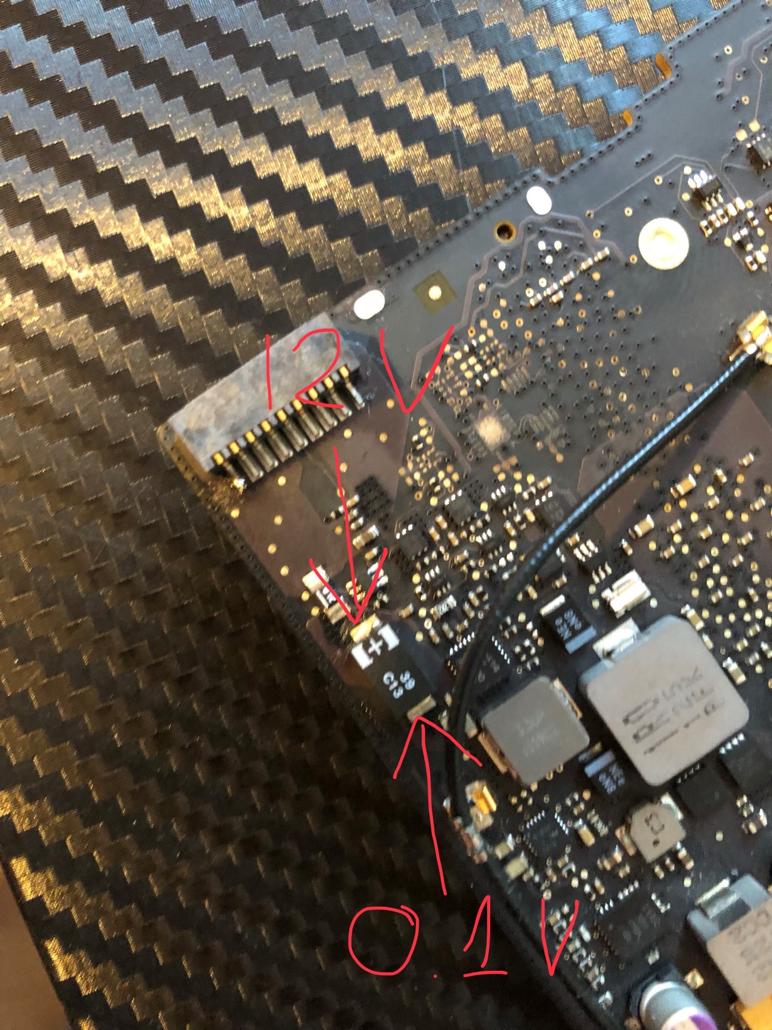

    Hello all,
    This is my 1st post on this website, but I'll try to be as clear as possible. I've bought 2011 A1347 (820-2993-A) mac mini for spare or repair on ebay with intention of fixing it. After short troubleshooting I'm sure that PSU is OK as I'm getting stable 12V from it. I've started checking other components and found that power rail marked 39 C13 is getting stable 12V from PSU side, but I'm only getting 0.1V on the other side. I don't have access to any schematics, but 0.1V sounds way too low. Can anyone tell me what the part number of that component is, or maybe something similar that I can replace it with. I'm adding a picture of the suspect
    Thank you in advance.
    Maciej

              Re: 2011 Mac Mini 820-2993-A no power
              No schematics for 820-2993 AFAIK. Therefore someone asking for money is probably a scammer.
              I don't see what's wrong with having 12V on one side an 0V on the other side of a capacitor.
                  Sorry for being late. That is a capacitor and the voltage is OK, that "0.1V" side is ground. You have another problem.
                      Hey man, so common issue in this is a bad BIOS chip. What you are most likely experiencing is a either a Bad Bios chip. I Had a no power issue and replaced the bios chip on this and it turned on. Not saying it is but do a Bios Chip test and see if the BIOS has failed. I repaired a 2011 recently. I was just curious if the Bios failed and it was something that truly was the issue. Its an easy repair. If you have a Programmer easy work, if not you can buy one on eBay for it.
                        Let me add to my statement, I ALSO am not saying it is a Bios Chip as well. But I have got a few of these recently with Bad Bios Chips. I had a few Mac Mini 2011 laying around for donor boards and took their bios off and replaced it and they turned on. I would just start there IF THERE was no signs of water damage.
                          I just repaired a 2011 Mac Mini that would not power up. The LED on the front and the fan would come on for about 1 second, then power off. Is this the problem you are having? If you hold the power button on and plug the Mini in (safe mode) all of your supplies may come up so you can measure them at the coils.

                            Hi ,
                            I have the same issue. I can hold the power on button, then plug in the power cord, system turns on with high fan spinning. What is the actual issue causing this symptoms? Normal press power button, the power does not come on, but I can hear the hard disk spinning, no green led on the box though.
