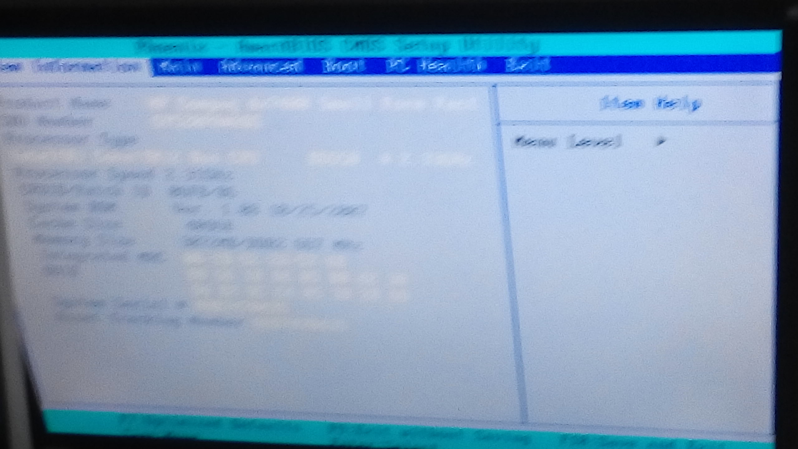

    Guys,
    I got POST diagnostic 7575 and then shut off on MSI MS-7352...
    CPU Core 2 Duo E6550
    Without memory it's C1C1 repeated beep but not shut off...
    WIth RAM it's 7575 few second, two fast beep then shut off...
    Anyone knows what's the issue ?
    cheers

        Re: Msi ms-7352 post 7575 ?
        http://h20564.www2.hp.com/hpsc/swd/p...&swEnvOid=1098

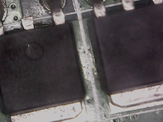

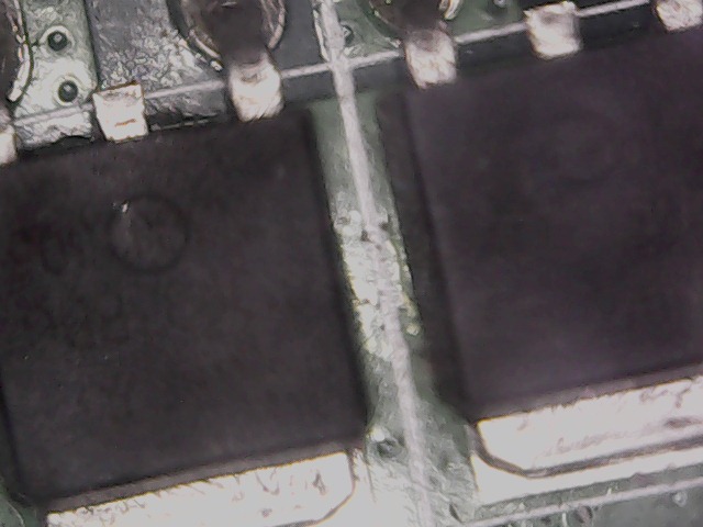

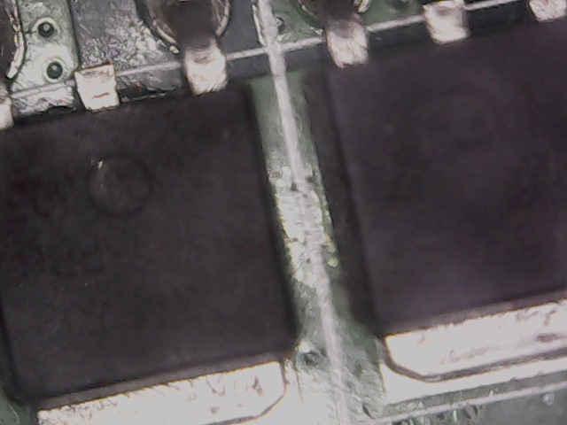

        Is it possible that I got problem with FET, because there were some bad caps that I have replaced now...??
        FET = P09N03BDG
        • bianchi77
          • Jun 2016
          • 1121
          How do you reckon of those FET condition ? I can not read label clearly...could it be burn and making the voltage unstable under stress ( full load ) ?
          • bianchi77
            • Jun 2016
            • 1121
            I've replaced the FET, now it can boot, but asking for system fan...I put a fan already on that connector but still complaining and auto shut off, probably my fan is not compatible ?????

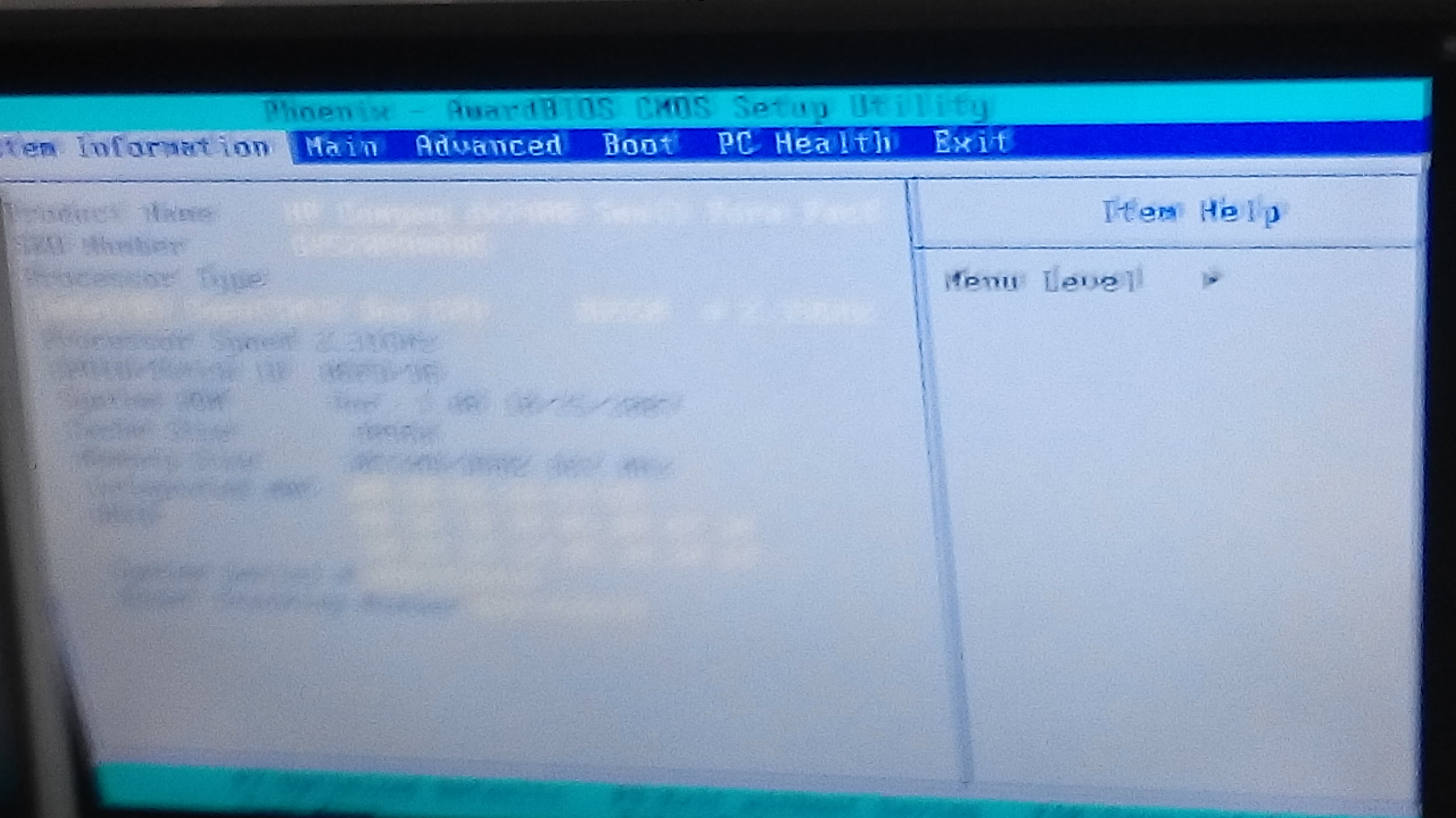

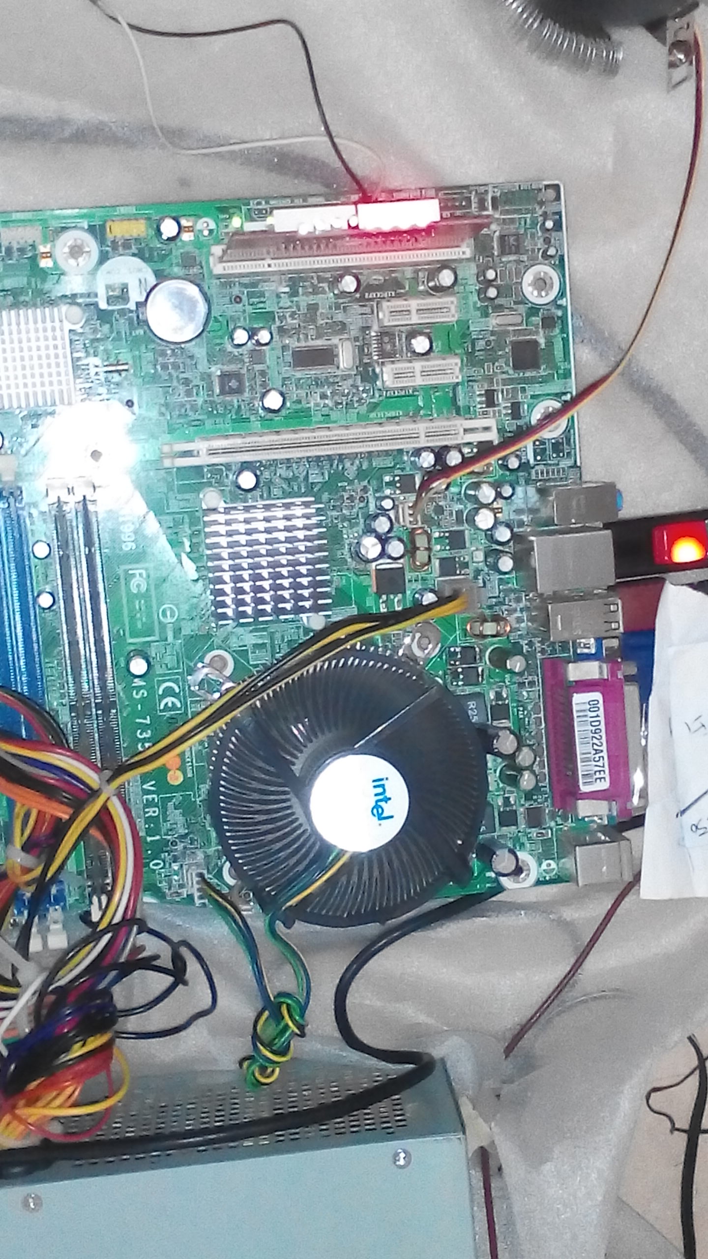

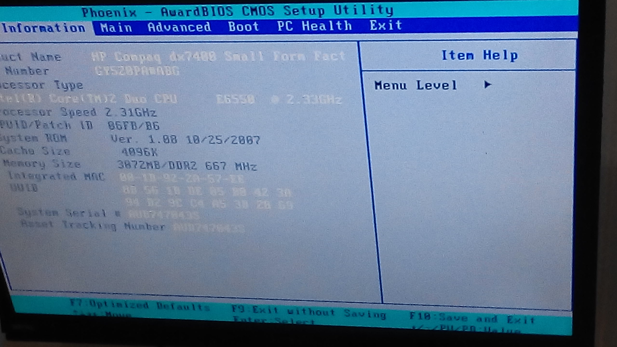

              It's fixed already, thanks guys, HP DX7400 mainboard...I'll give you a picture later on..
              • bianchi77
                • Jun 2016
                • 1121
                Photos, I'm done with this board, now doing the test with 3Gb memory, linux and CPU E6550....
