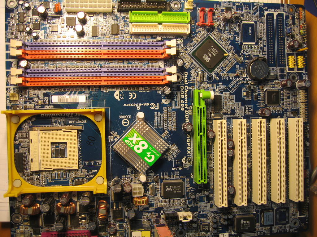

    I have a Gigabyte GA-8S655FX motherboard that do weird things. Start when have been powered off for some time and after a while running it locks.

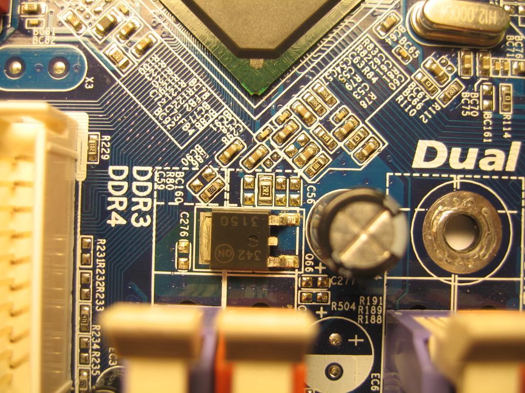

    I have been trying to find what the problem is and found a FET that gets too hot. its near the Ram slots. Its the one in the Picture 1.
    This FET gets about 8.6 volts in the gate pin and I think this is wrong. I tracked the pin and it comes from another chip with reference ST M104I that is the one in the picture 2.

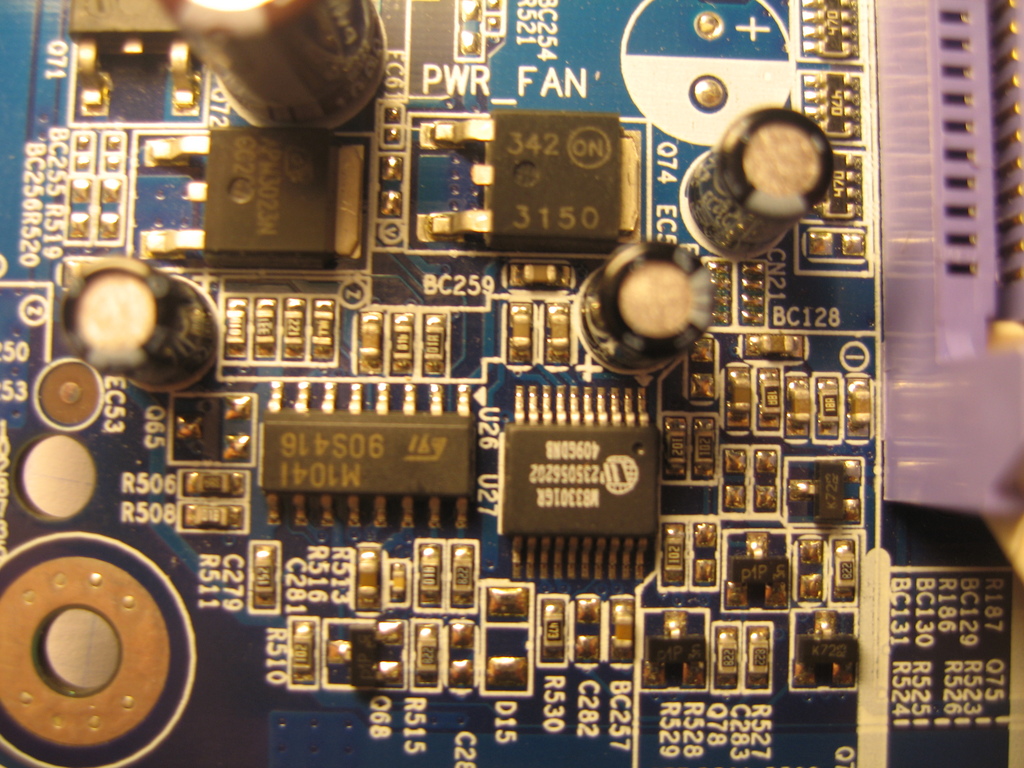

    The picture 3 is the motherboard.
    All the caps in the MB looks good.
    Anyone know what I can check now ? What could the problem ?
    Thanks in advance

    I can now add that the M104I is a quad differential amplifier and the inputs of the amplifier that handles this FET has 2.89v.
    Any ideas ? could this be a badcaps problem ?

                  The fet part number is On Semiconductor NTD3055-150 . Its a Power MOSFET 9.0 Amps, 60 Volts N–Channel DPAK
                  When I power on the system I get this voltages in the FET that gets hot.
                  D - 3.32v
                  S - 1.90v
                  G - 6.30v
                  Ive tested memory with memtest86 on other system and is fine. Now Im going to read AGP and Memory slots volts.
                  Thank you all for your help

                      Just found this FET is the memory regulator and its not giving the 2.5v but 1.29
                      Any ideas of what could be the problem this is not giving 2.5 Volts ?
                      Thanks for all your help

                            Sorry I was wrong...
                            The mosfet that gets HOT powers the Southbridge SIS964 chip. Other mosfet gives power to the DDR slots and this last is giving 1.29V instead of 2.5volts and is not getting even warm.
                            This two fets gets power from the 3.3v line.

                                Ok figured out that the 1.29v are fine!
                                As indicated here
                                the DDR slots needs 2.5v and 1.25v
                                The controller for the DDR memory voltages is the w83301. The w83301 datasheet have an application circuit which reflects exactly the gigabyte ddr voltage regulators used in this board and looks fine. The datasheet can be downloaded from here .
                                So I get back to the first FET which gets too hot as the problem.
                                greets
