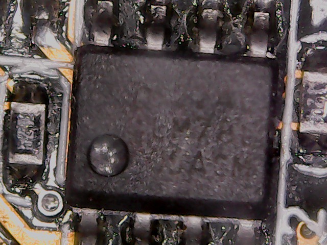

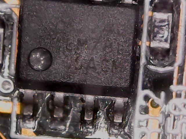

                  I've found 1 8 pins SOP chip, which can not be read its label...could it the issue for this board ?
                  This chip was burned, that's why I can't read the label anymore...
                  It's located near modem connector...pin 2 3 6 7 are all connected on continuity test...
                  but I got no clue what chip is it....label completely gone....trying to see it now...

                    #29

                      #30
                      Re: A7S333 1 long beep 3 short beep and shut down ?
                      pin 2 3 6 7 are shorted to the ground as well, is it possible ? or it's just broken ?
                      I can't see the label and datasheet from it ....

                        #31
                        You did take excellent pictures of it, though.
                        From what I can read on its label, I can make out a LM78L(?)05ACM.
                        So, I looked up a datasheet for a LM78L05 SOIC in Google, and got the following
                        Check it out - it's a standard 7805 5V linear regulator . As per the datasheet, pins 2, 3, 6, and 7 are all supposed to be ground... so that matches with what you measured..... So that's not the problem. That said, check what *resistance* you get on pin 8 (Vin) and pin 1 (Vout). Pins 4 and 5 are NC (i.e. Not Connected). Also, try measuring the voltage on pins 8 and 1 when you turn on the motherboard. I would guess that pin 8 is tied to the 12V PSU rail. You should see a stable 5V supply on pin 1 (Vout). If not, whatever that linear regulator is providing power to could be bad.
                        If this IC is near LAN connector like you said, perhaps the LAN chip went bad (often happens during a thunderstorm, since a lightning strike will create lots of EMI and RFI - enough to induce a substantial voltage on a long Ethernet cable sometimes).
                        That said, post a bigger picture of the overall of the board so we can see where this chip is located.

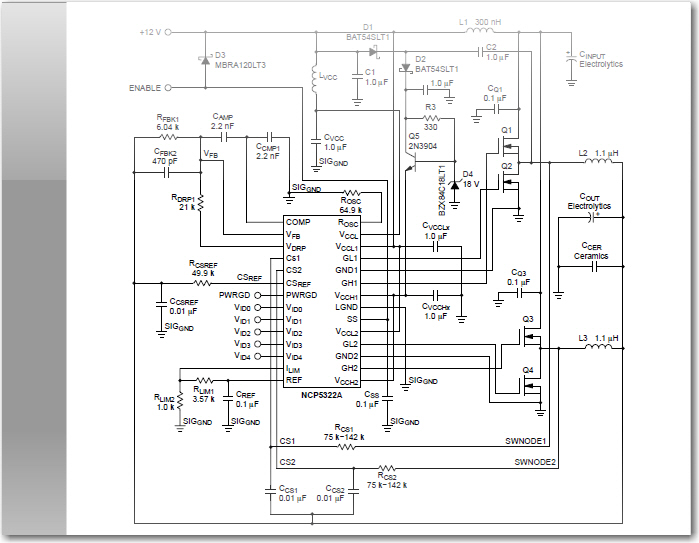

                            if this one is short, it will make NCP5322 shut down the whole board ?
                                    what's the normal voltage for Q1,Q3 and Q2,Q4....looks like they are 2 pairs for 5322
                                    and from the schematic in datasheet, source suppose to be 12V but I can't get 12V on it...could it be another FET controlling it and it failed ?
