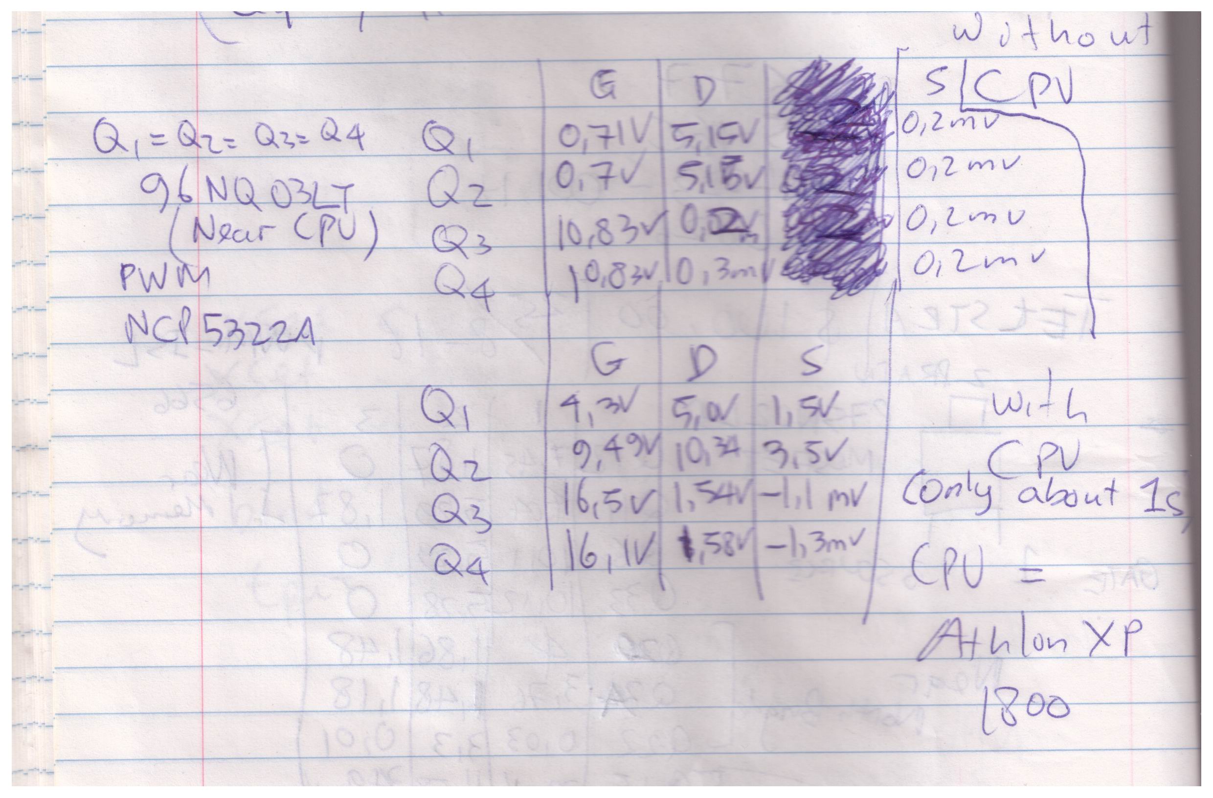

              Re: A7S333 1 long beep 3 short beep and shut down ?
              I check Q3 and Q4 = 0V on the drain, it could be a death FET and caps...
              3 caps are short...I will see if I remove them...what's the response on my DMM ??
              I keeo posted...
              • bianchi77
                • Jun 2016
                • 1121
                nothing wrong with those FET or caps, I reckon the CPU is not right...
                without CPU, fan can run ok, but after I put CPU...fan on for about 5 seconds voltage at 03 and Q4 is 1.7V which is CPU core and off....

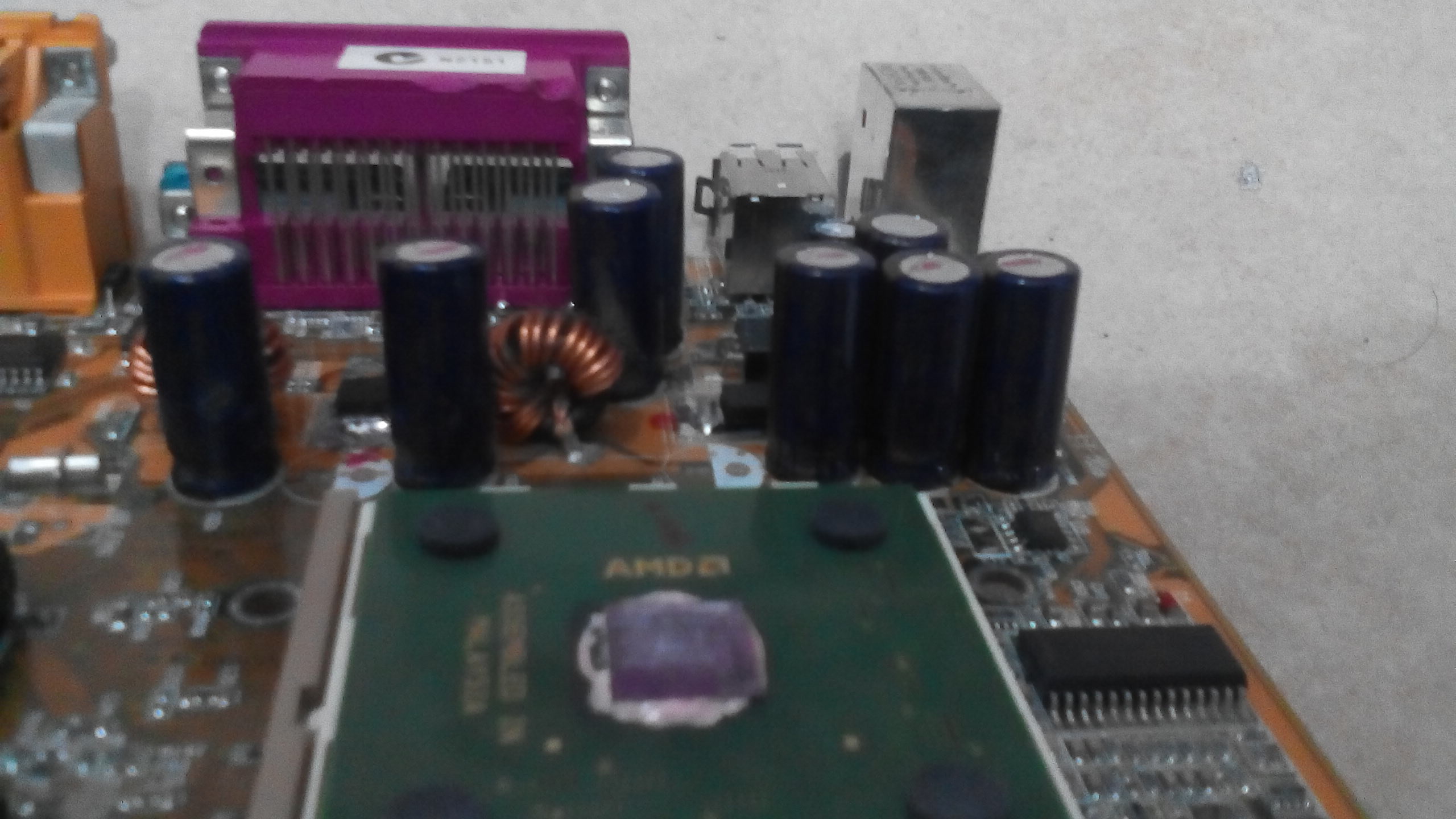

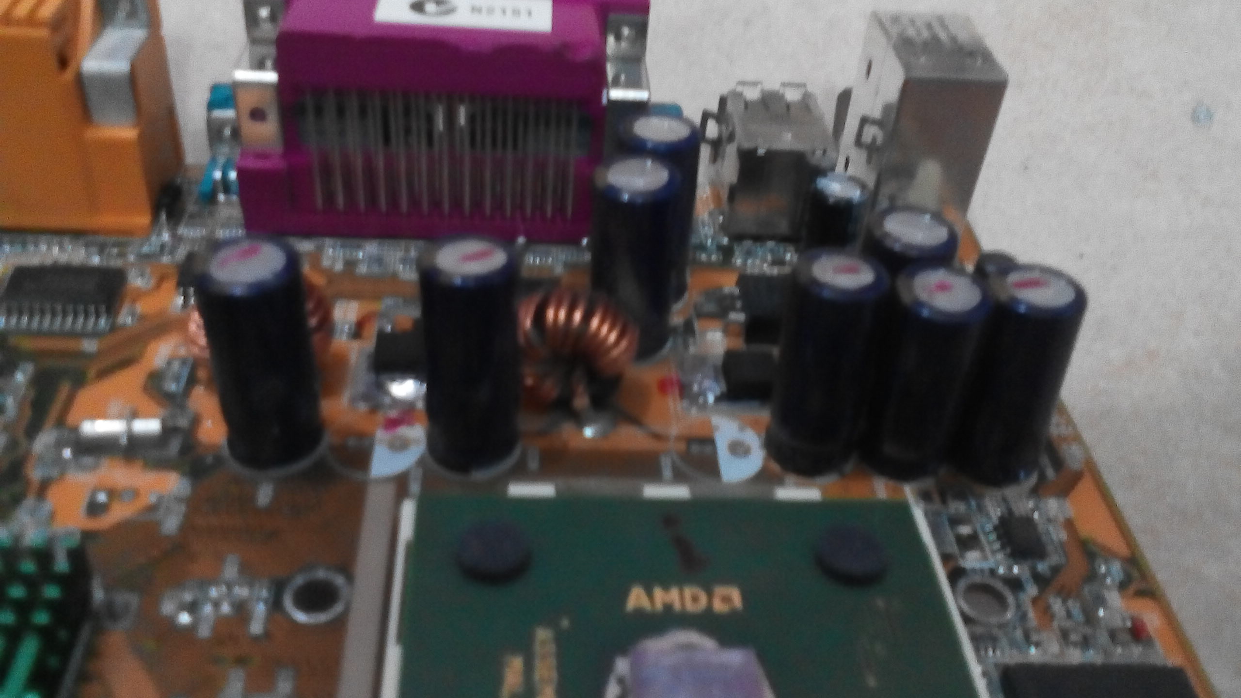

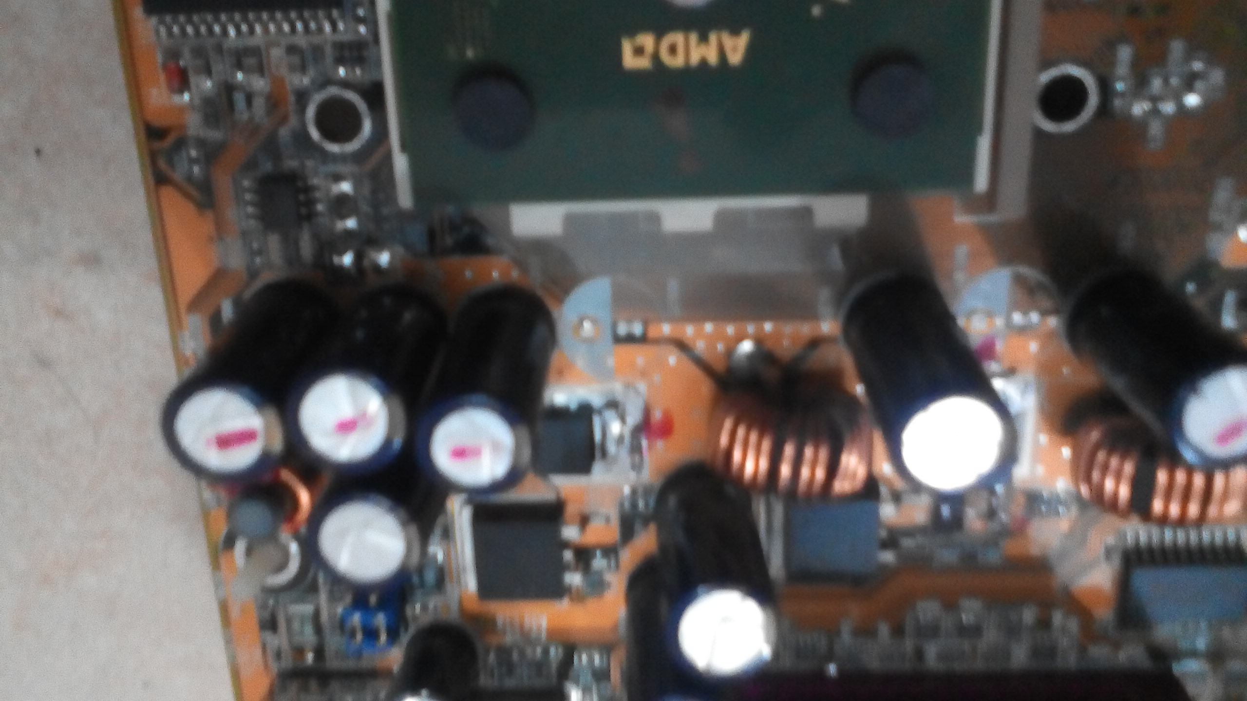

                              the caps with red line on top are failed on continuity test...
                              they're all beep very loud...
                              could it be the problem ?
                              but I can't see any bulge on top...
                              Have a look on the photos
                                it's 3300uF/6.3V

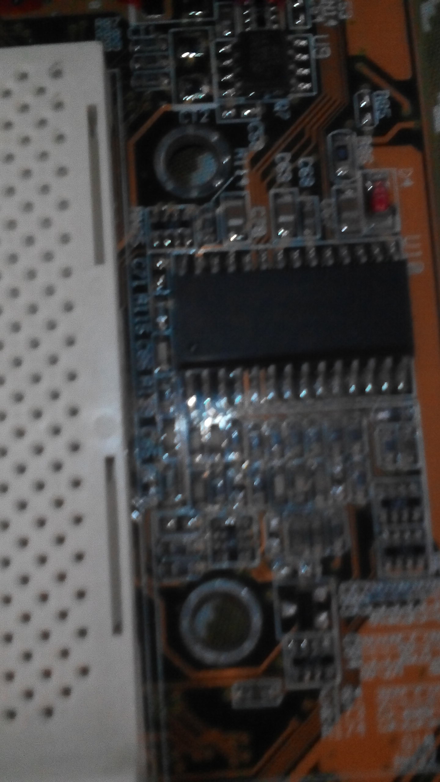

                                    Voltage measurement, PWM and zener photos...
                                    Could it the problem with PWM and zener ?
                                    Any clues ?
                                    Zener = LM431ACT
                                      Originally posted by bianchi77
                                      it's 3300uF/6.3V
                                      Are they KZGs? All 3300uF KZGs were visibly bad (bulged) on my Asus A7N8X-X! And that's when just sitting in the room of my former place!

                                      • bianchi77
                                        • Jun 2016
                                        • 1121
                                        Nope they are 5 dark purple Rubycon 3300 uF/6.3V capacitors...is it possible that my PWM is faulty ?
