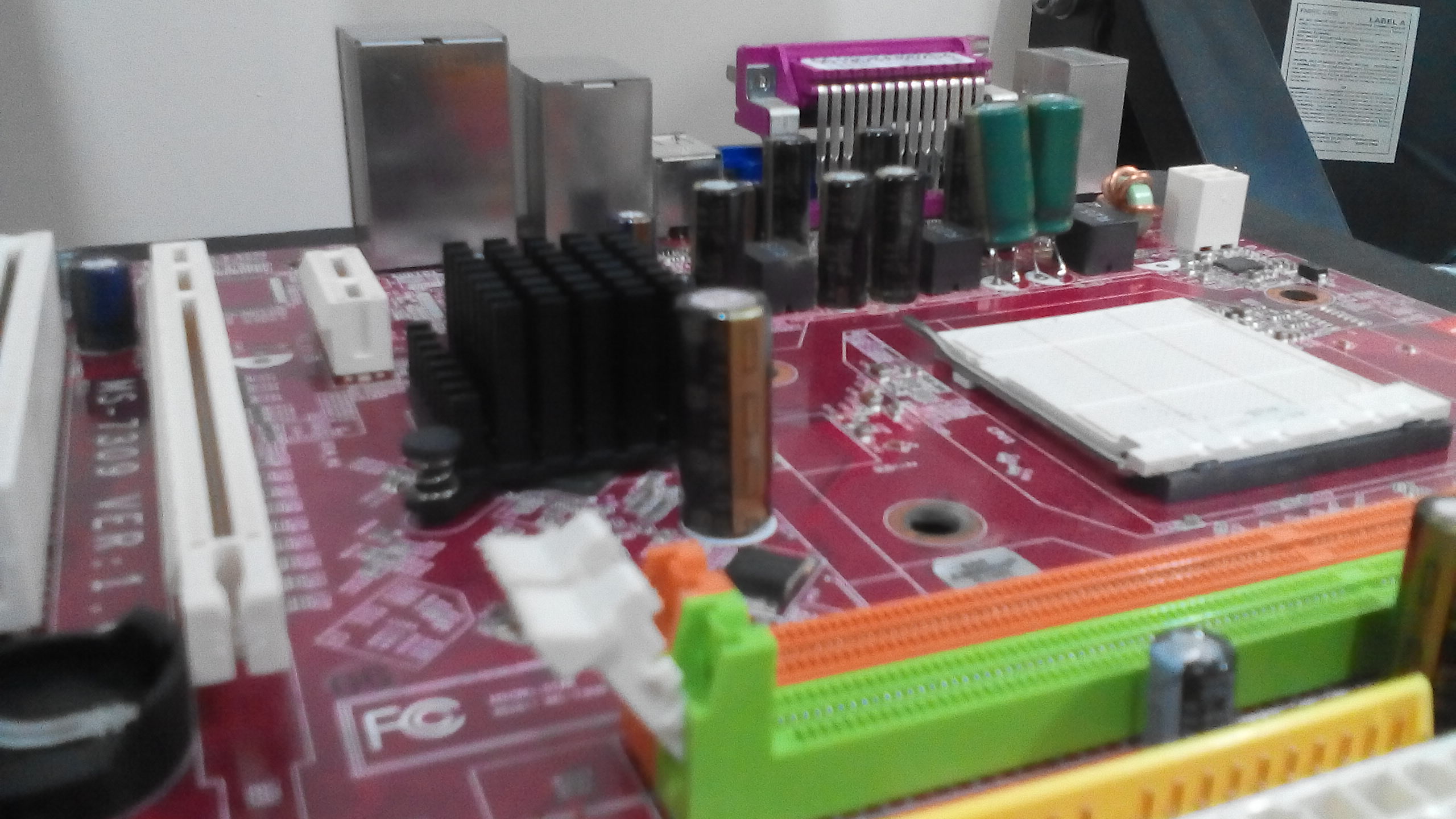

    Guys,
    I got motherboard with no display,
    And I got short on the capacitor shown in the photo...
    but when I take the capacitor out...
    The short is still there...
    Where can it be do you reckon ?

            Re: MSI K9N6SGM-V question ?
            Put back all of the capacitors you took out, turn ON the motherboard, and measure the voltage you see across them.
            DO NOT RUN THE BOARD WITH CAPACITORS REMOVED!
            can it be a shorted mosfet ?
            No. If the motherboard turns ON with no display, then you do NOT have a shorted MOSFET.
            A shorted MOSFET will typically cause the power supply to crowbar and latch into protection mode (usually, you will see the PC fans spin for a second and then stop).

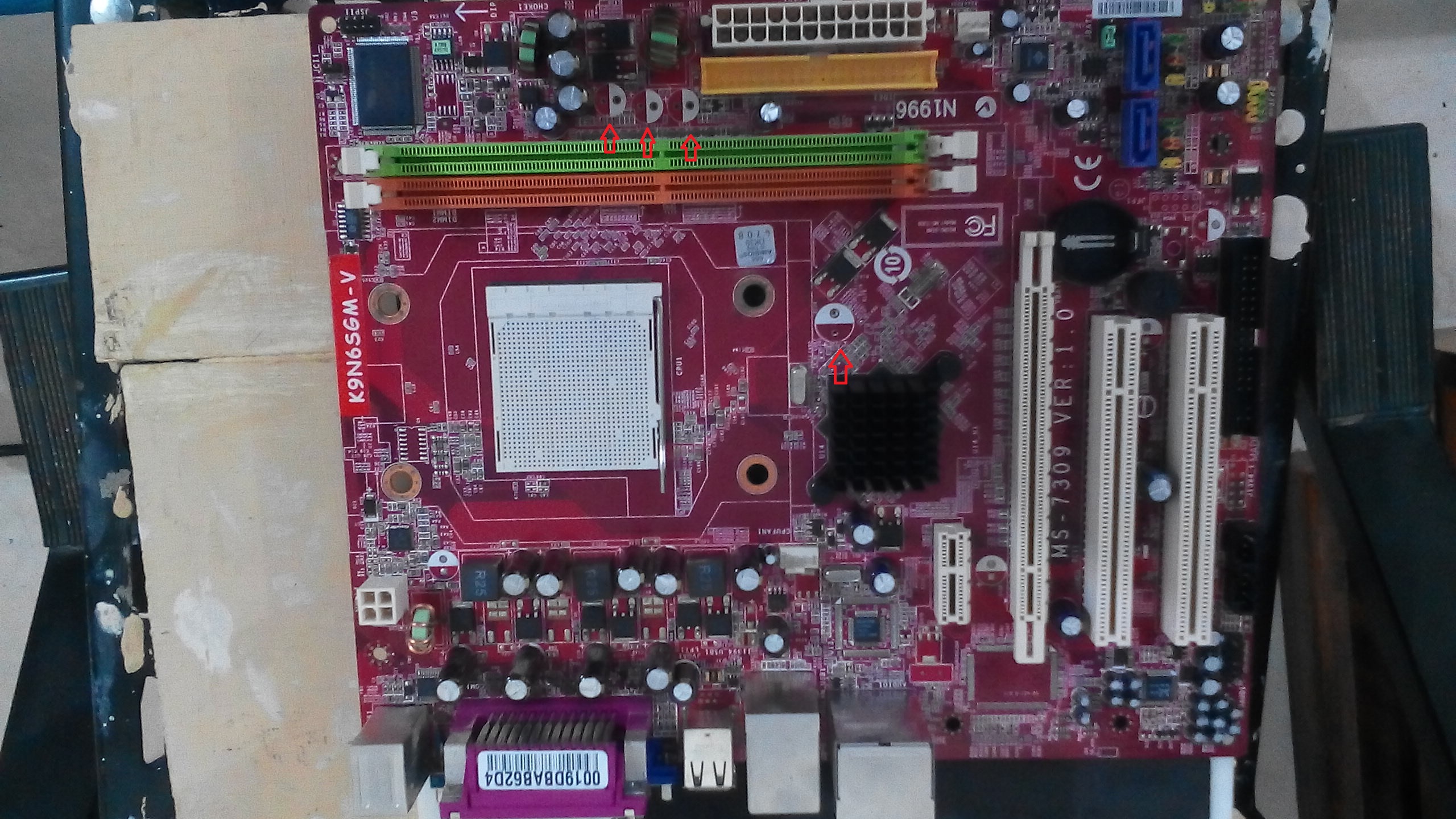

                          Some measurement I got on transistor
                          Q12 is unsoldered temporarily
                          PWM = ISL6566....is it possible if my PWM chip malfunction ?
                              I'm glad you posted that list with the voltages. Good info to help us help you.
                              Based on that...
                              Looks like Q11 and Q12 are for the RAM buck converter, producing RAM Vdd/Vddq voltage (which is typically 1.8 to 2 Volts for DDR2 memory). So the pair Q11 and Q12 are OKAY.
                              Next on that list: Q20. Looks like this MOSFET takes power from the DDR2 supply (RAM Vdd) and produces 1.5V on its Source. Not sure what that 1.5V rail is for, but probably a secondary Northbridge supply. Either way, 1.5V is a common voltage, so I think this is OKAY as well.
                              Then it looks like Q34 takes that 1.5V supply (via Drain) and further reduces it down to 1.2V (output from Source pin). 1.2 V is a very common voltage for Northbridge on AMD motherboards from the 939 and AM2 era. So again, I think this is OKAY.
                              Finally, MOSFETS Q15, Q14, Q10, Q9, Q7, Q3 near the CPU. These produce CPU V_core (a.k.a. CPU Vcc). For three of these MOSFETs (not sure which ones), you should have 12V on their Drain and CPU V_core on their Source (1.1 to 1.4 Volts). And for the other three that don't, they will have their Source pin connected to ground (your multimeter should show 2 Ohms or less to ground).
                              Now here is what I see wrong: from these MOSFETs near the CPU above, you don't have 12V on their Drains on any of them. When you were testing the motherboard, did you connect the 4-pin 12V CPU power connector? I know this seems like a stupid question, but those measurements certainly indicate that perhaps you forgot to.
                              is it another bad capacitor case here ? but I can't see the caps is broken...??
                              Capacitors don't have to be bulged to be bad.
                              I see two blue Teapo capacitors (SZ series?) near below the Northbridge on this picture:
                              https://www.badcaps.net/forum/attach...4&d=1470738633
                              If they are Teapo indeed, you need to replace them. Teapo on a motherboard is teapo-cally not a good idea .
                              As for the capacitors around the CPU, those look like Panasonic (Matsushita) with a "T" vent. Perhaps FL series. Can you confirm?
                              Lastly, the capacitors you removed seen in this picture:
                              What brand and series are they?
                              Maybe. Maybe not.
                              Check the above items I mentioned and report back.
                              Also, what brand power supply are you using?
                              And any history on the motherboard? Did you get it working or non-working? If the former, when did the problems appear?
                              The more information we have, the easier for us to help you.
