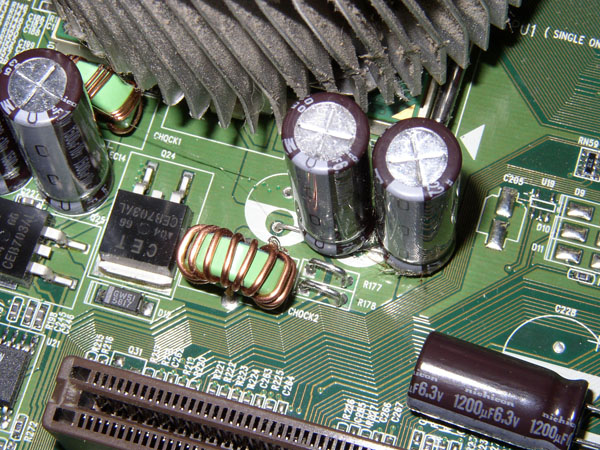

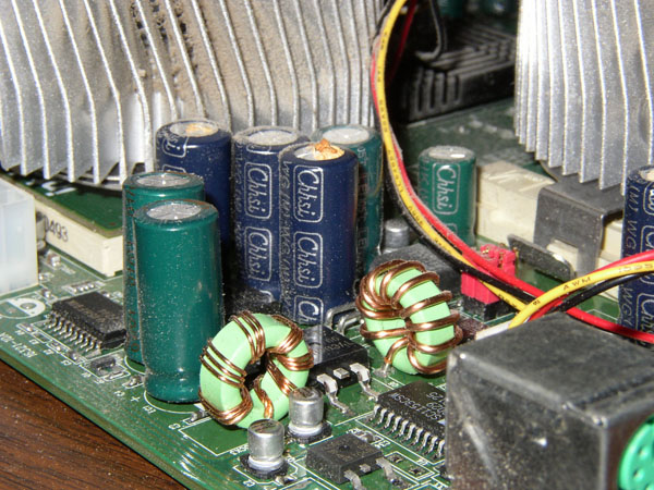

Symptoms:
4 vented caps, others swollen. still rock-solid though.
Board history:
Bought brand new in sealed antistatic bag. In late summer '04, put together my desktop system with it. Now, around 7-8 months later, half the caps are already toast... damn quick failure... Mild top-gunk was present after only a few months, along with buldging of the others, and has gotten progessively worse since.
Caps:
6 Chhsi 6.3v 2700uf. Four vented. Replaced with 2200uf 6.3v nichicons.
1 Tayeh 6.3v 1500uf. Looked OK. Replaced with 2200uf 6.3v nichicon.
4 Teapo 10v 1500uf. Looked OK. Replaced with 1500uf 10v nichicons.

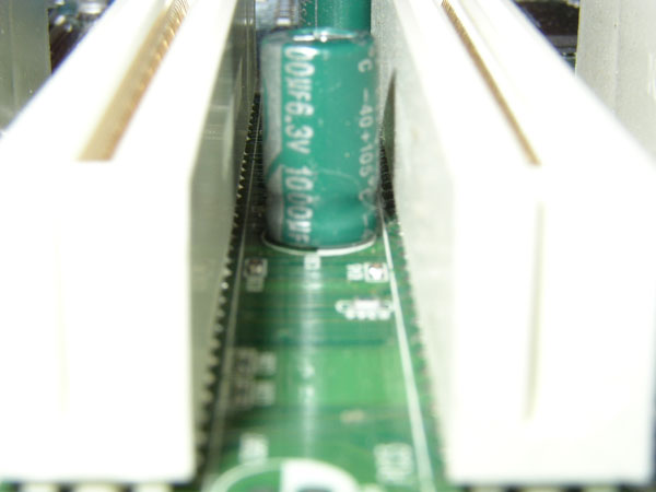

8 Chhsi 6.3v 1000uf. Several buldging. Replaced with 1200uf 6.3v nichicons.
3 Chhsi 16v 470uf. Looked OK. Replaced with 1200uf 6.3v nichicons. See previous 694d recap for notes.

http://www.bushytails.net/~randyg/694d2/p1010011.jpg vented large chhsi caps
http://www.bushytails.net/~randyg/694d2/p1010016.jpg buldging small chhsi caps
http://www.bushytails.net/~randyg/694d2/p1010024.jpg vented large chhsi caps with logo very clearly visible
http://www.bushytails.net/~randyg/694d2/p1010025.jpg another vented chhsi cap. Yes, the clip on the fansink really is a flat disc you have to bed.
http://www.bushytails.net/~randyg/694d2/p1010030.jpg more vented chhsi caps
http://www.bushytails.net/~randyg/694d2/p1010033.jpg out-of-focus c390. note the difference between the stripe and the masked semicircle.
http://www.bushytails.net/~randyg/694d2/p1010038.jpg another buldging chhsi cap
http://www.bushytails.net/~randyg/694d2/p1010061.jpg different angle of buldging chhsi cap. it's neighbor has already been replaced.

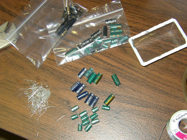

http://www.bushytails.net/~randyg/694d2/p1010089.jpg I stopped throwing my caps out when I found the forum. Some day I need to ship them back, one per envelope, to the motherboard manufacturers.
