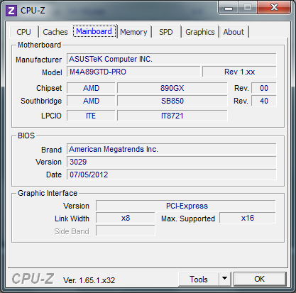

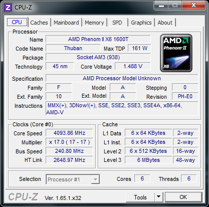

              The Deneb Phenom II's have 4 physical cores at the most, and your 965BE came OEM with all four of them operational, so activating core-unlock in your case could achieve nothing but trouble.
              For the record the M4A89GTD-Pro mobos are very good at core-unlocking (provided there are healthy cores to unlock onboard the CPU), mine successfully unlocked two extra cores from a 960T Thuban that has been running like a champ for half a decade @ 4.1GHz on 6 cores. I didn't fiddle with the mobo switches however, just unlocked from BIOS.
              • SuperDuty

                Re: Unstable Asus M4A89GTD PRO/USB3
                Intersting, I should grab one of those as a small upgrade. Worth a try if I find one cheap !
                I have no idea how I activated the Core Unlocker, maybe it was when I was fiddling with the power cables. But I haven't had a crash since I deactivated it !
