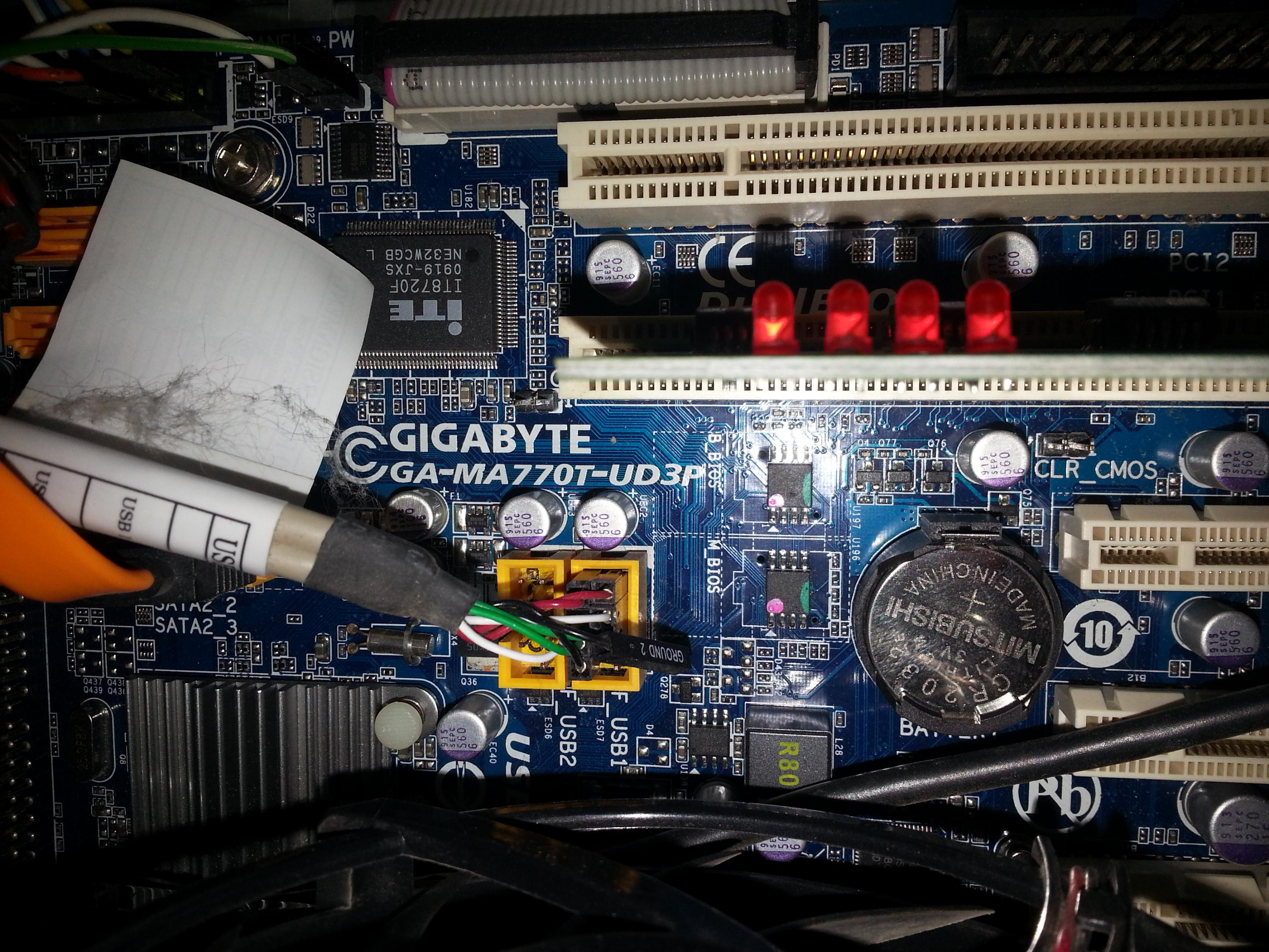

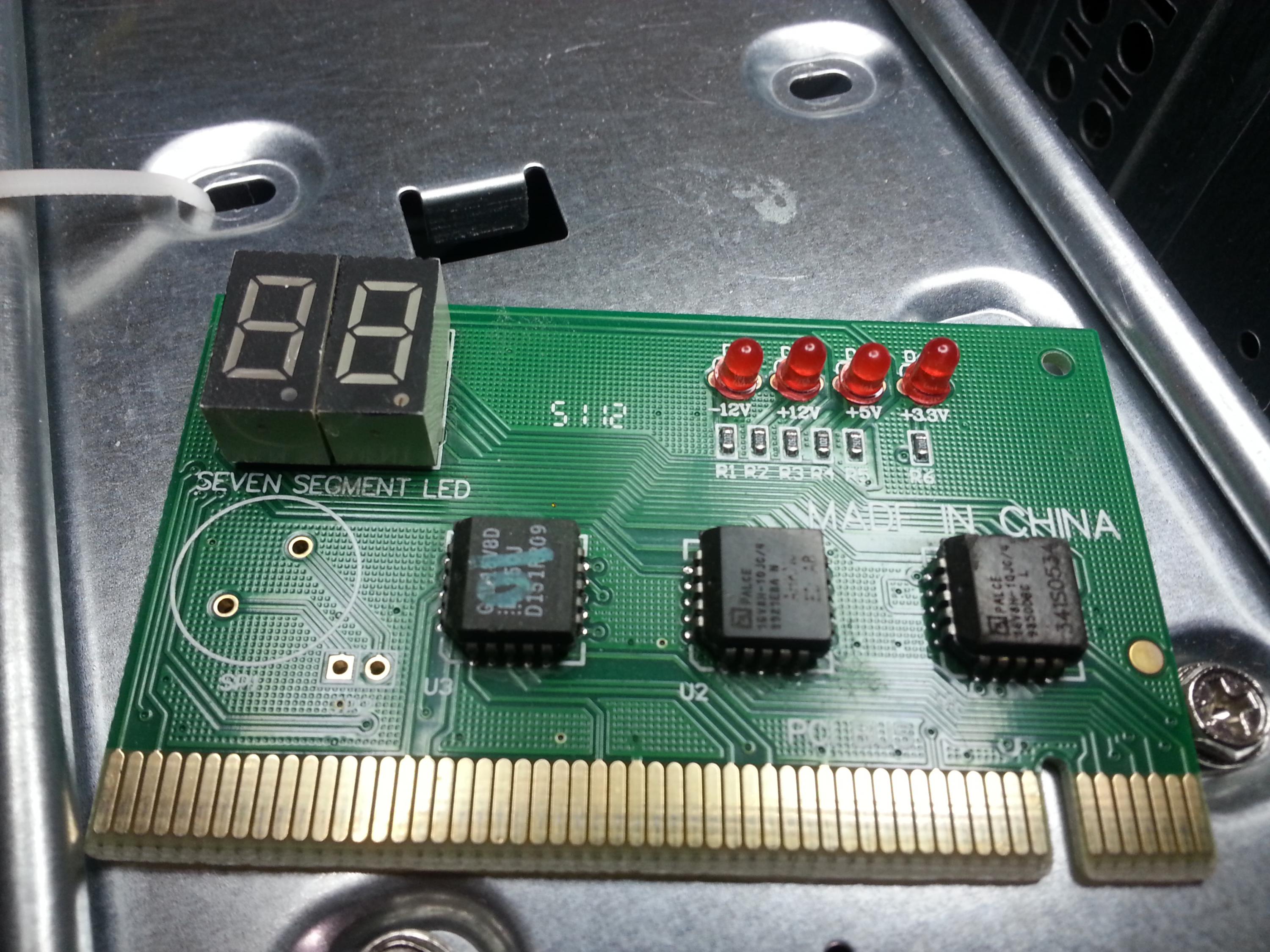

    This computer belongs to my dad and is used daily. It was turned off one night and the next morning it would not work.
    Symptoms:
    No display when powered on.
    No beeps.
    Fans and lights come on and stay on.
    I have swapped both video cards and monitors and still nothing.
    The board has all solid caps so I do not think that is the issue.
    I have a PCI PC analyzer card that I used (see attached picture) and the results have left me confused. If I turn on the power supply, then power the board on, I get all the power indicators lit up but nothing on the 8 segment displays. If I power the board off holding the power button for 5 seconds, then power it back on I once again get all the power indicators and this time the 8 segment displays start displaying information. They display "02" when they stop changing.
    This one really has me stumped so if anyone has a clue to where my problem is located I would appreciate some input.
    My initial thoughts are a faulty BIOS flash chip but this board has a dual bios setup so I do not know and I do not want to chase a red herrings all over the board.

    When I run into these no boot situations, I do the following:
    1) simply everything - use a known good PS, 1 stick of DRAM, CPU, keyboard and monitor.
    2) remove everything from the no boot computer except the above. Strip everything else out.
    3) The post card can help. Use it on a good system to see the sequence and then on the no boot system.

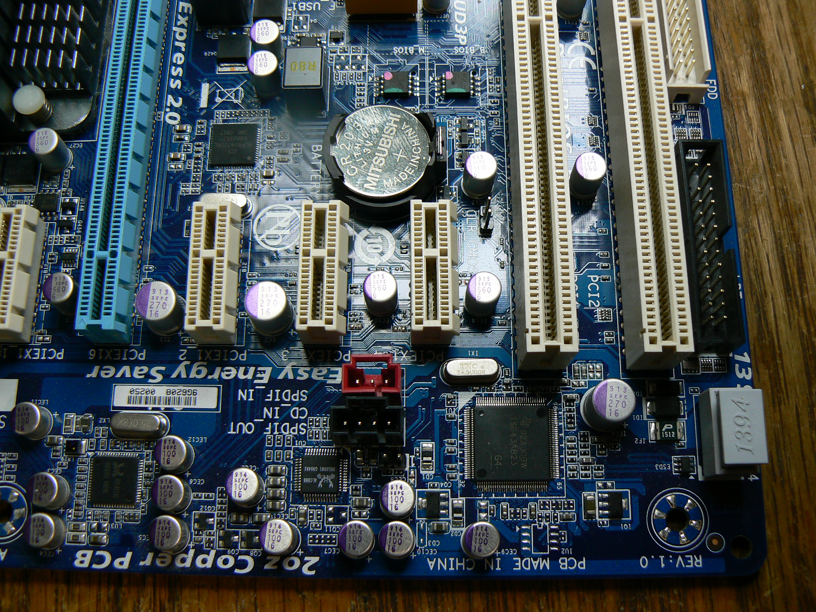

    4) Put in a fresh CR2032 battery that is > 3V.
    5) Reset/clear BIOS via jumper (if any).
    6) Take motherboard out of case so it is isolated. This eliminates any possible shorts between the bottom of the motherboard and the case.

      I did check the battery last night but it was 3.2V so I do not think that is an issue. It also dawned on me this morning that it is acting like a PC where the P4 connector was left disconnected.

        gigabyte board? so im guessing it uses award bios. hanging at 02 seems to mean there is some kind of error accessing or programming the cpu registers if i'm reading the post checkpoint code right.
        so this issue is either a problem with the cpu or the ram. i would try swapping ram and cpu with known working ones to see if that fixes the problem.

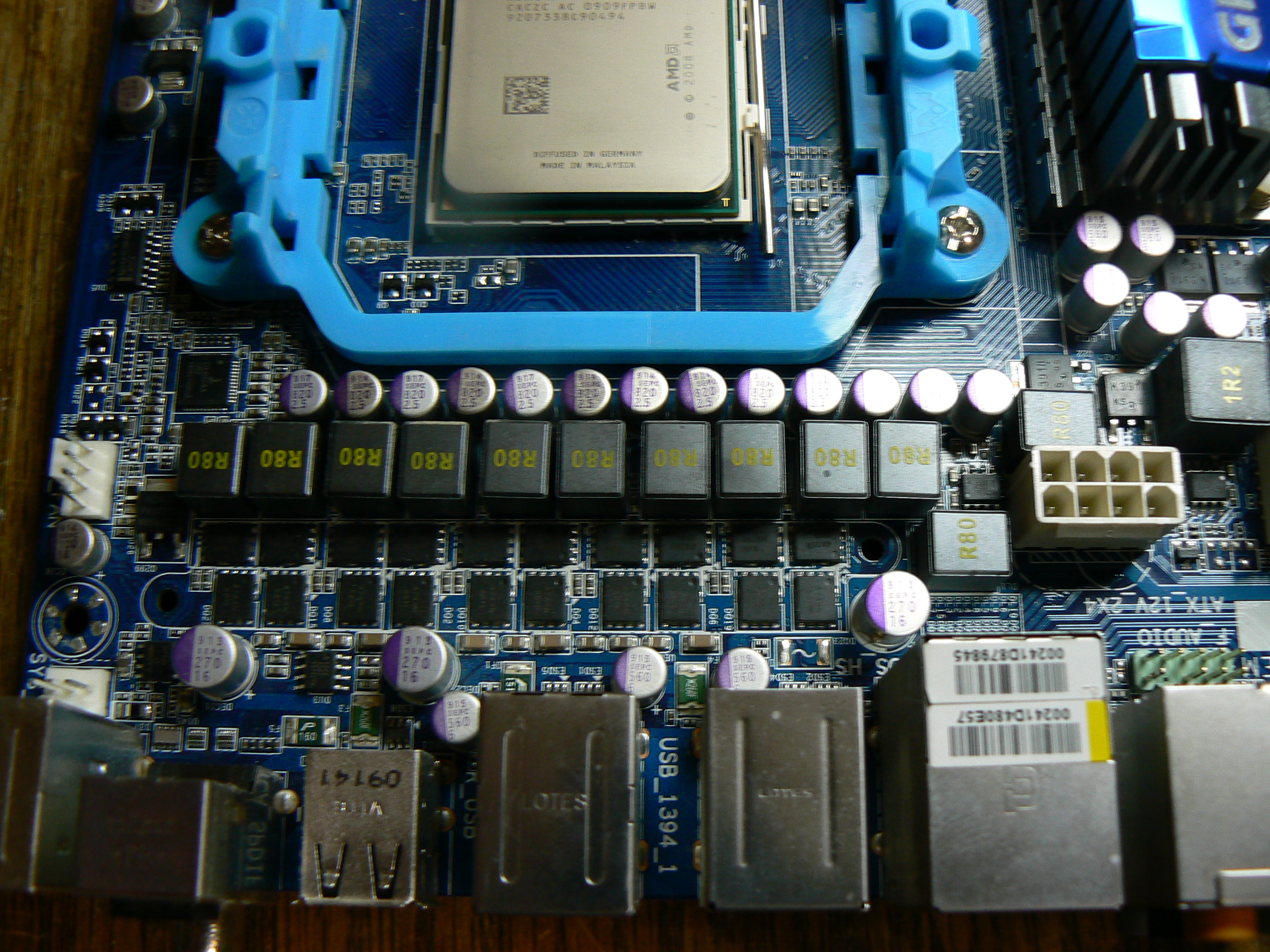

          I also measured the CPU VRM at the caps. There are 11 2.5V caps by the CPU. The first two caps closest to the edge of the board measured 1.148V, the other 9 measured 1.053. I am not sure why they would be different. The processor is a quad AMD Phenom II, and I have not yet pulled the heat sink to get the exact model.

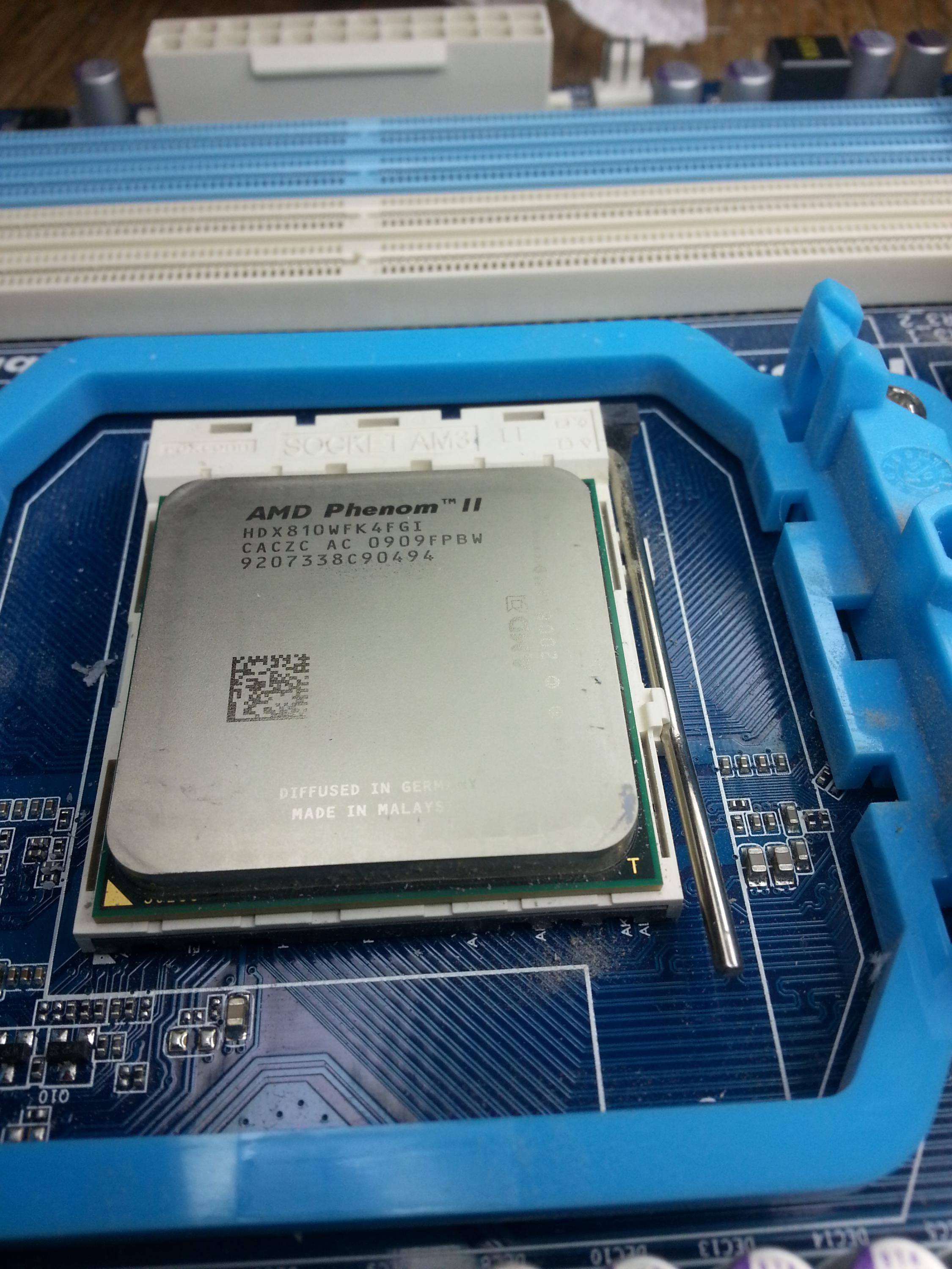

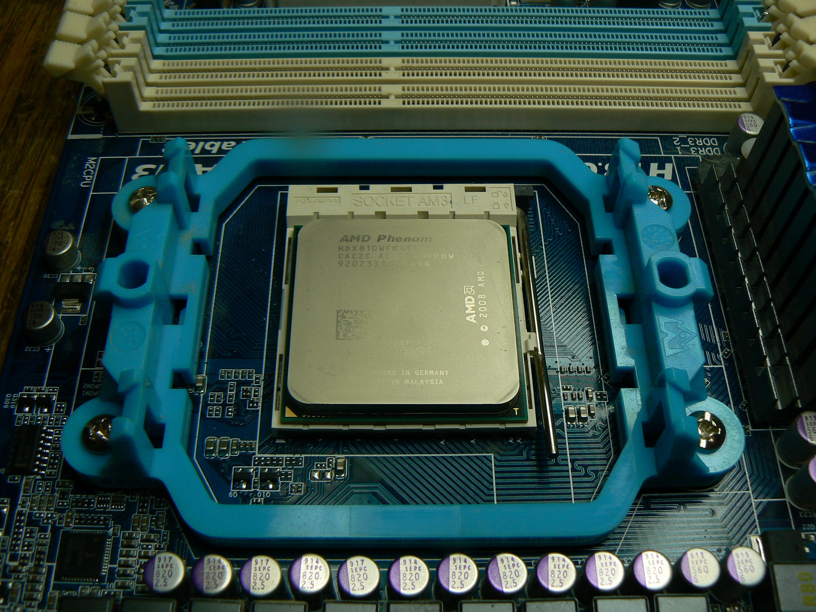

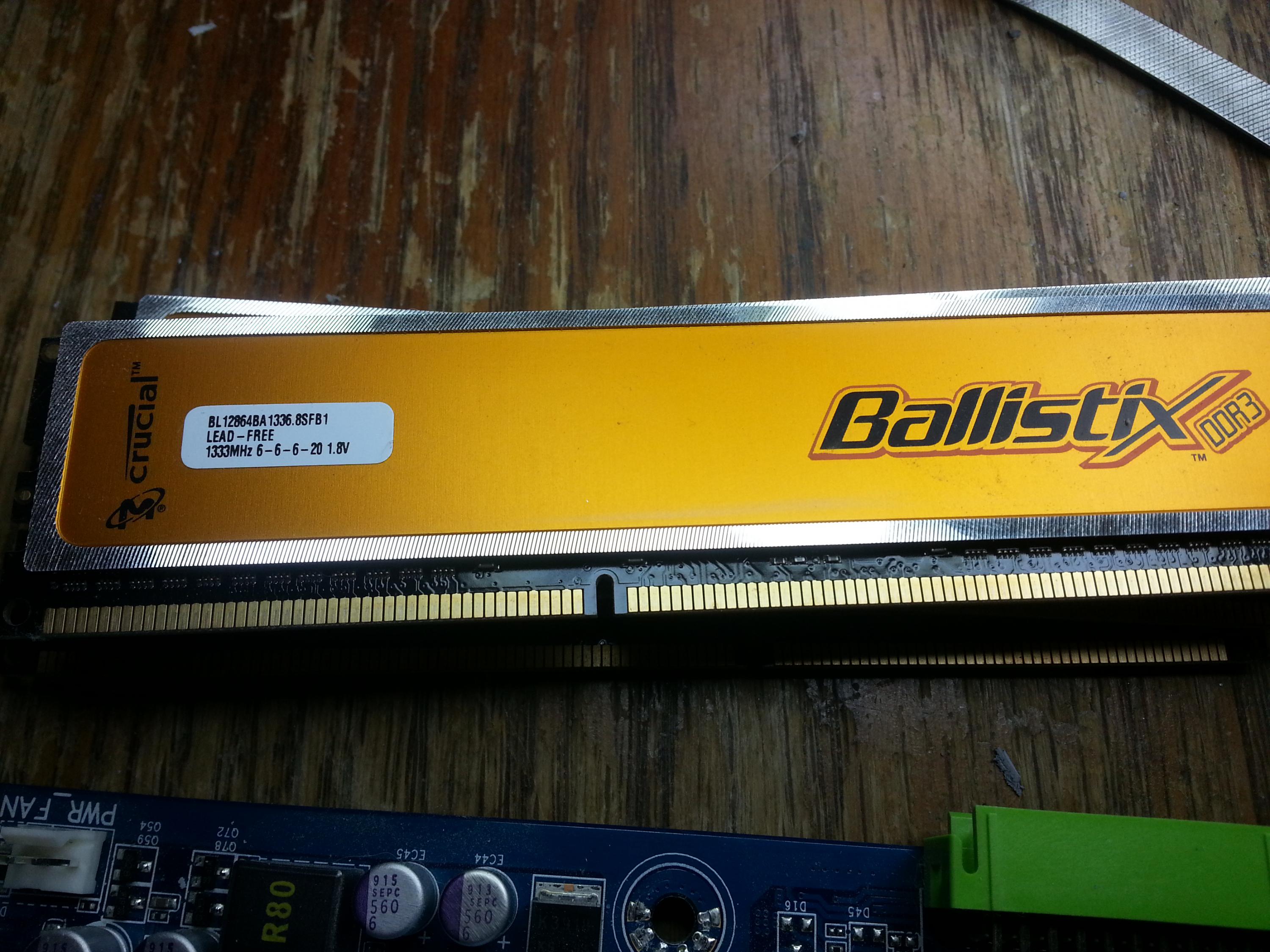

            I did not think the ram was a problem so I decided it was safest to test it first. I put all four sticks in another PC and it fired up with no problem. I also tested my POST card in that PC and it worked every time no matter if it was from a cold or warm power on, so I think the motherboard has a pre-post failure.
            I am still concerned about trying the processor in another board so I am going to print the compatible CPU list for this board and see what I can dig up.
            I have attached pictures of the CPU and RAM.

                  I lost my book to the POST card so I am having trouble deciphering the code meanings.
                  I have probably the same post adapter. I got mine from ebay for $2.50CDN 4 years ago?
                  I wouldn't trust the code to match the manual as I suspect the makers just copy the documentation from whatever they can find on the Internet.
                  I use the post card just to give me an idea roughly if the motherboard is doing anything. Voltages, as you can guess, are dead easy to measure, but I have no visibility into what the motherboard boot process is doing.

                    It sounds like you have done everything to narrow down the possibility to either the CPU or motherboard. Personally I have never seen a CPU failure. However, I have received dead motherboards in which I have fixed.
                    The only thing you have not done is to clear the CMOS via the jumper and/or remove the CR2032 so the system loses its BIOS settings.
                    You may have missed it but in post #3 I stated that I tested the battery and it was 3.2V. I did not say that I pulled it out to measure the voltage.

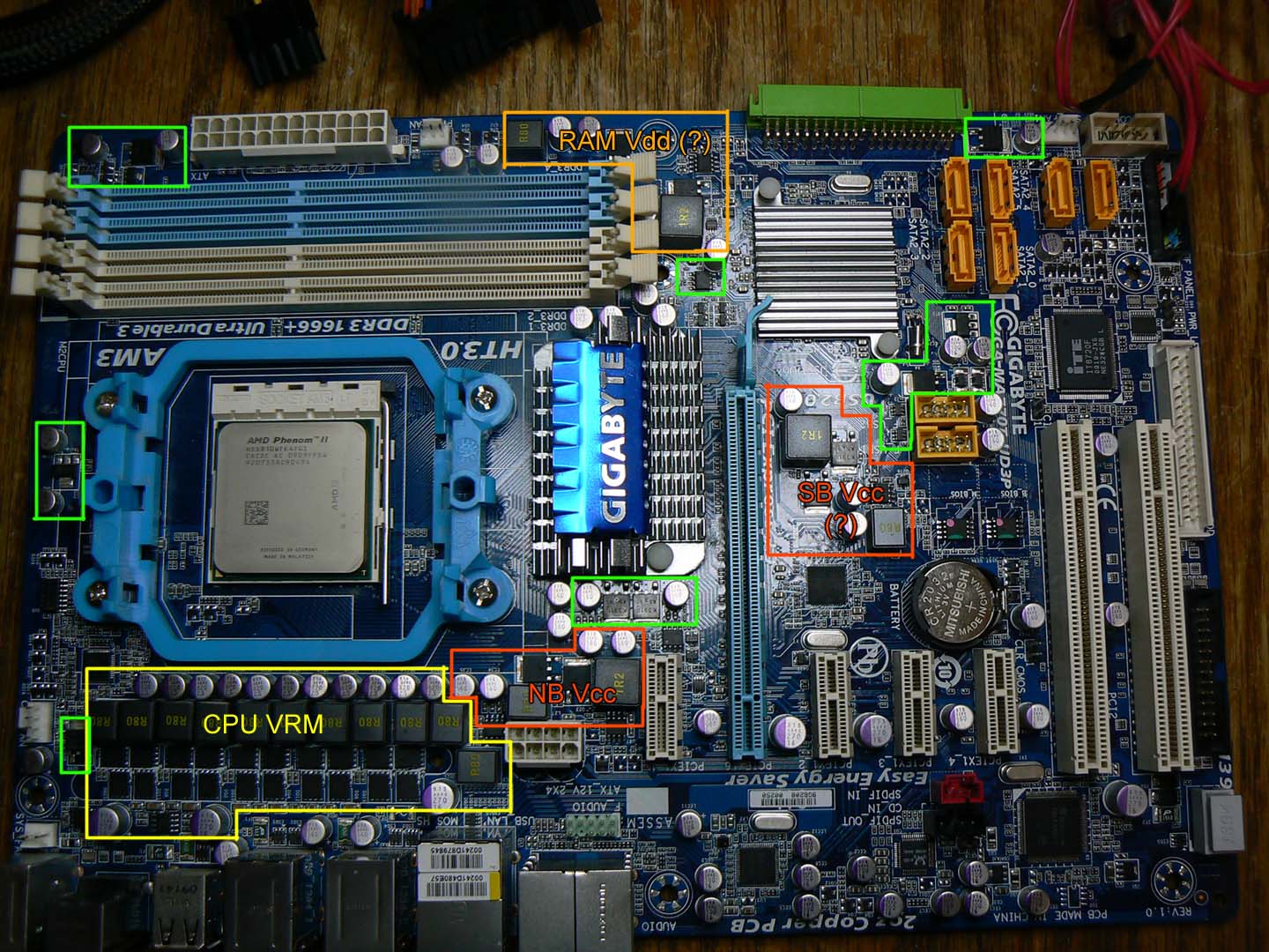

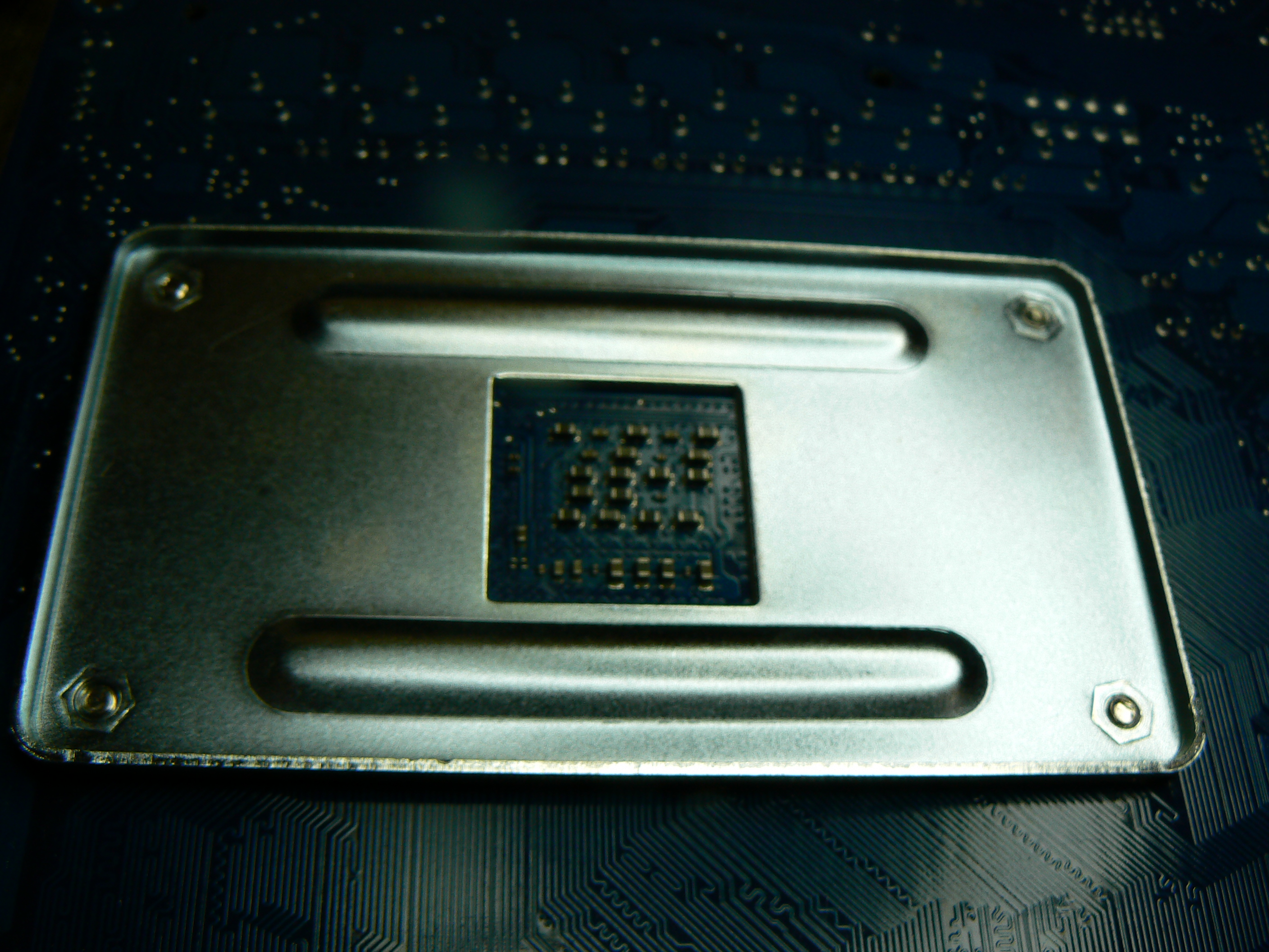

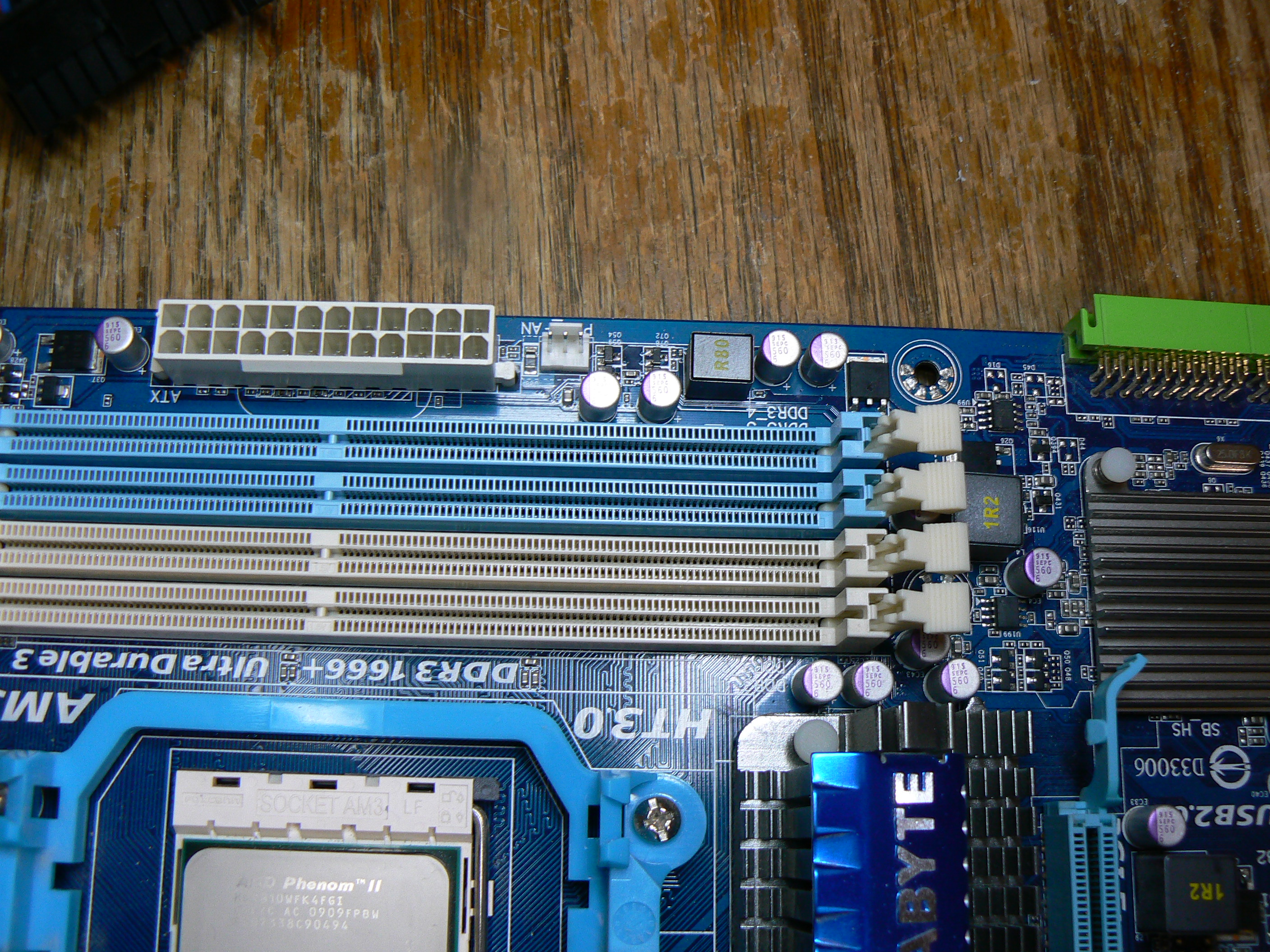

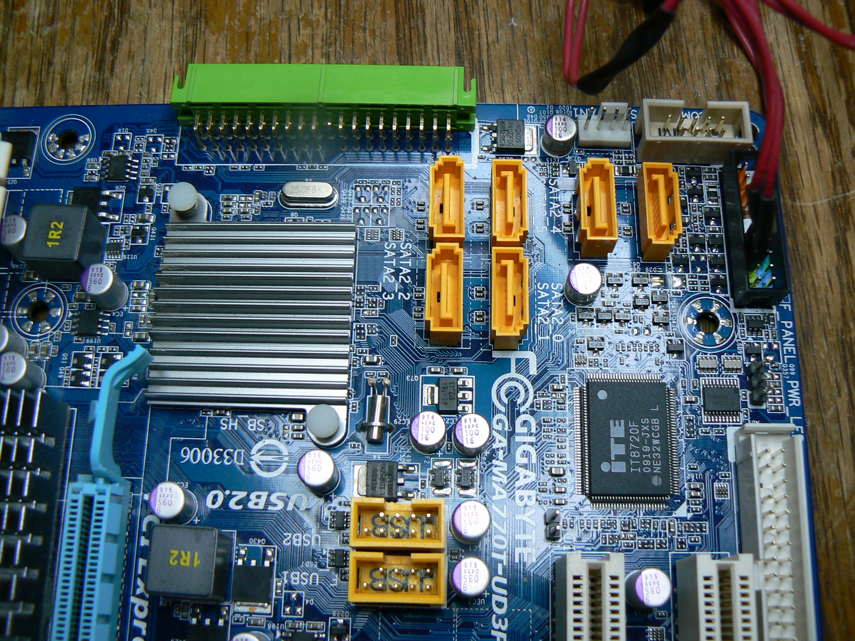

                        Does this motherboard use a stock AMD cooler? Do you see any warping under the CPU socket? It's rare for the CPU socket BGA to fail, but I know that many of the socket 939 and AM2 coolers bend the crap out of the motherboard. And where you have board flexing, you have potential for failure.

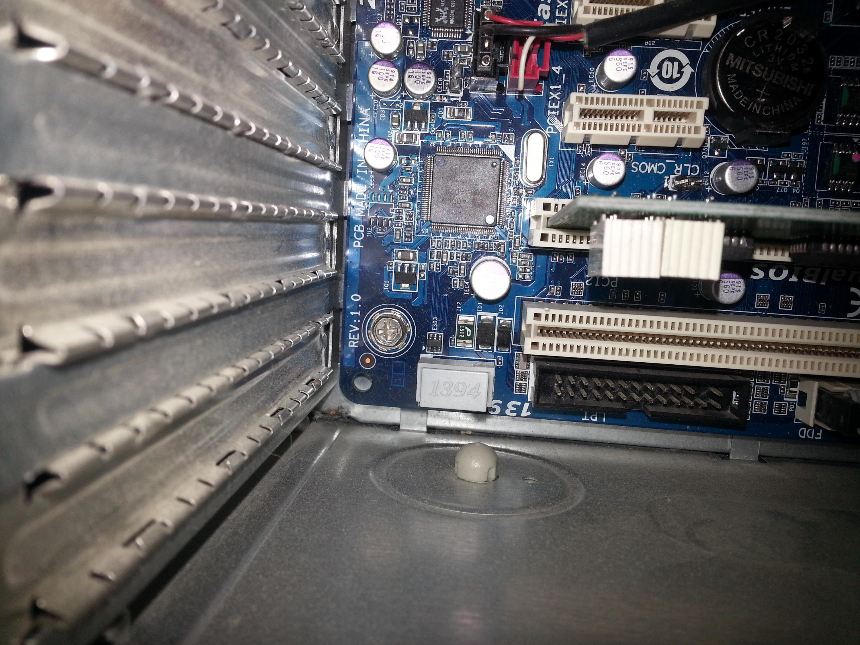

                          Flexing is not an issue on this board. It is well made as best as I can tell. I have attached pictures of the brackets plus some more shots of the board.

                              Check if the (+) terminals of the caps are connected physically. Do this *without* the CPU installed.

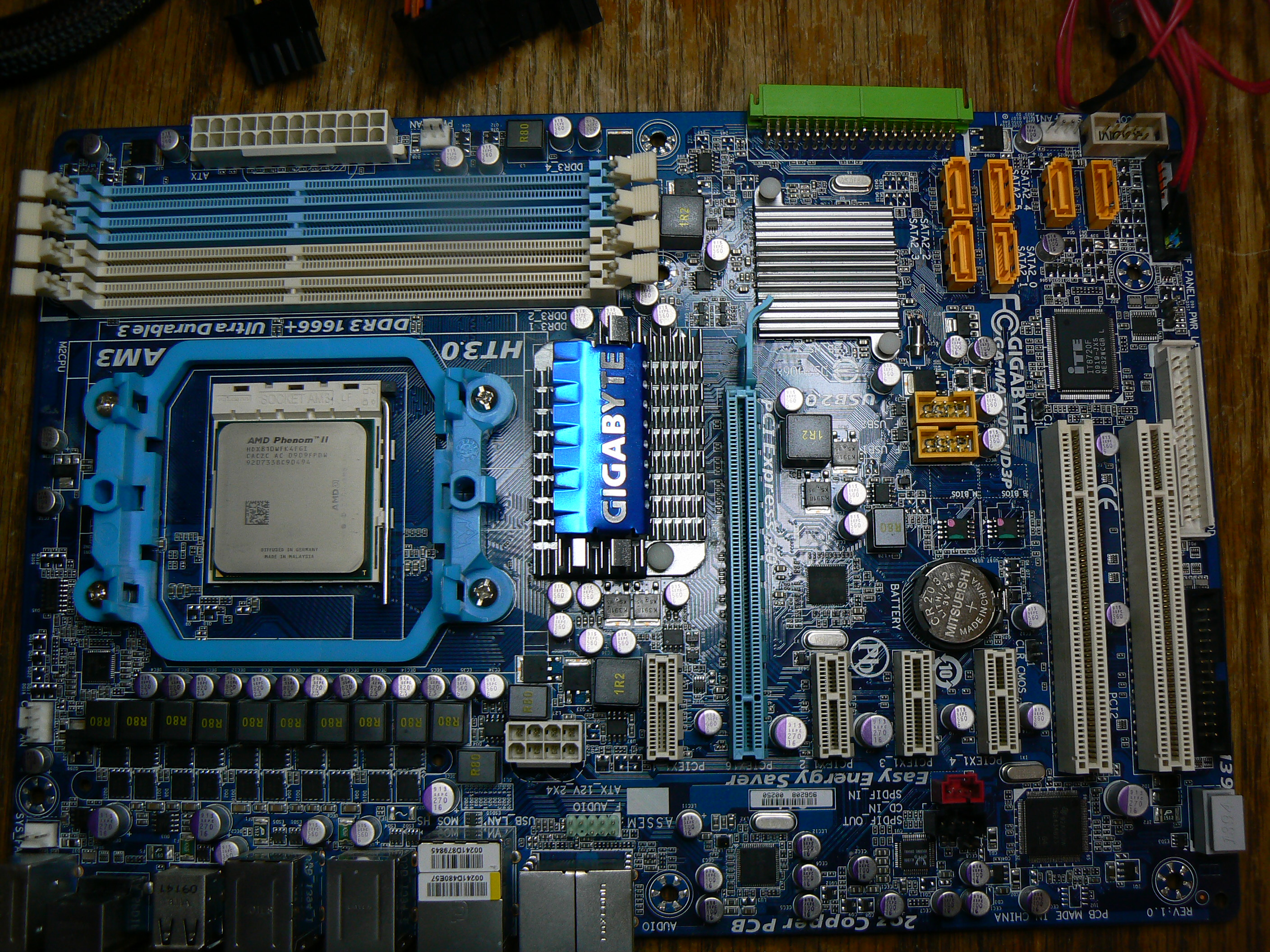

                              I made a map of all of the power rails on the board. See attached image. It looks like you already checked the CPU VRM. That said, check the Northbridge (NB), Southbridge (SB), and RAM VRMs that I outlined in red and orange - at least I think those should be it. Let me know what voltages you get.
                              Finally, there are the areas I circled in green. Those, I am a bit less sure what they power and what voltage they should have, as I haven't worked on motherboards with anything newer than socket AM2/775.
                              - I think the MOSFETs circled in green next to the NB should be for the NB as well. Not sure what voltage to expect there, though.
                              - As for the MOSFET and small SMD regulators between the SB and orange front panel USB connectors - my guess would be the TO-252 MOSFET is for standby power for the SB, the SOT-223 regulator/transistor is either for the SATA communication and/or LPC/Super IO controller, and the small SMD SOT-89(?) regulators/transistors are for switching power to front USB.
                              - Then there are the components next to the ATX connector and a 8-pin SOIC-8 IC below the RAM VRM. At least one of these should be for RAM Vtt. RAM Vtt = 1/2 of RAM Vdd usually. At least for DDR2 and DDR. I have no experience with DDR3.
                              - Lastly, there are two more regulators - one above the CPU socket and another near the CPU fan connector. I don't know what these are for.
                              Either way, measure the input and output voltages for all of the above stuff and report back what you get. I doubt it would be a shorted MOSFET, as that would usually overload the PSU and cause it to crowbar (or you will see some cooked components). But let's just see if all voltage rails are in order anyways.

                              It doesn't matter how well the board is made. The socket 754/939/AM2/AM3 heatsink retention mechanism relies on flexing the back side bracket to keep pressure on the heatsink. Unfortunately, these brackets are *not* raised in the middle, as they should be. Thus, the board always gets flexed with the bracket.
                              Whenever I get an AMD board, this is the first thing I mod. Anyways, that is besides the point. What I would suggest you do as another test is to put the board flat on your desk and put the heatsink on the CPU *without* locking the retention mechanism. Just make sure the heatsink is sitting on the CPU (with thermal compound, of course), that is all.
                              *edit* forgot to add attachment... will update in a minute...

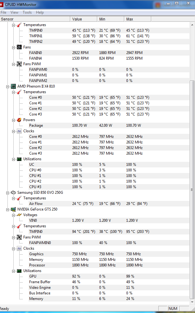

                                    The attached image is from Hardware monitor when I was stress testing my dads computer.

                                        wtf?! i noticed in the hwmonitor screenshot u posted that the video card was overheating to 94-95°C. that is much too hot to run a gts 250! i highly recommend u check to see if the cooler is clogged with dust and also to check if the tim has not dried up.
                                        that 38-95°C thermal cycle is going to kill that lead-free bga solder on that gpu really fast, i suggest u stop using that gts 250 until u can fix that overheating problem. the gts 250 is a mighty fine video card based on the much acclaimed g92 gpu core. u do NOT want to ruin such a groundbreaking gpu of its time like that!
