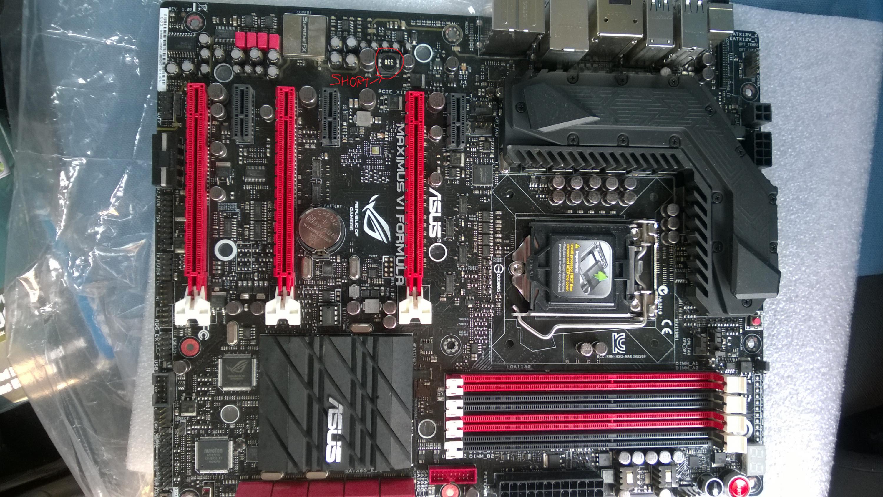

    asus maximus vi formula dead after socket replace.
    hi i got this motherboard with 1 bend pin on the cpu socket. ive replaced the whole socket with a new one and now pc power on showing code 00 that is a code u get also when pc is working fine, but unfortunately pc wont post. i checked almost all inductor and ive found that one inductor is shorted, but dunno what rail it is powering.
    any help would be good. i go in vacation these days, but would appreciate some tips so when i come back and can work on the mainboard i have already something to test.

        Re: asus maximus vi formula dead after socket replace.
        thí is -12v, i think problem with your socket replace!
        do it again maybe resolve .
        here is boardview, hope can help you.
