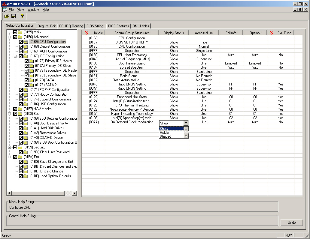

      Also I have progress on the bios thing - using AMIBCP v3.51 ( http://forums.mydigitallife.info/thr...-0-bios-unlock ) I opened the bios and - sadly - there is no hidden options:
      Damn.
