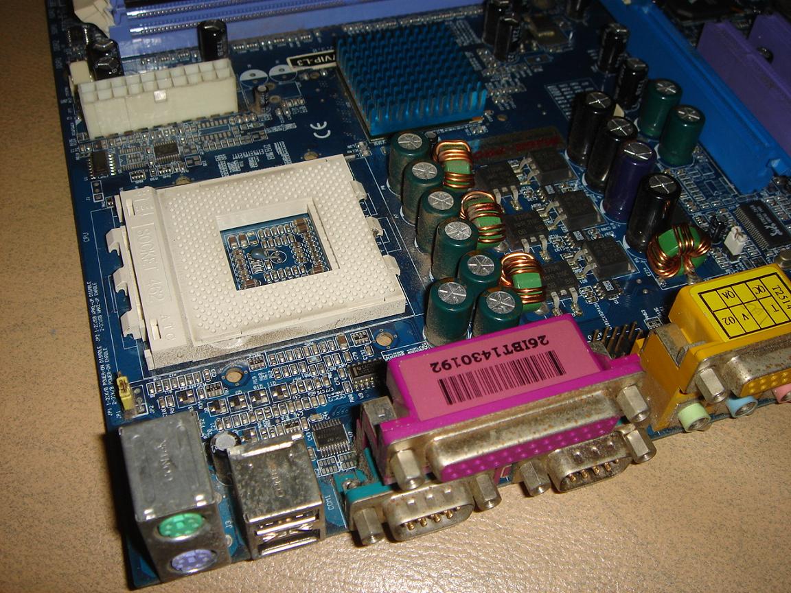

        Re: Jetway V266B still good??
        This is how i did it.
        The 16V caps can be exchanged by 6.3V though.
            Thanks for the very nice photo Phenos.
            Since its there I note not all positions are populated
            So stevo like my Gigabyte as you can see 4X 3300 uf is used instead of 7 1500uf
            (only I went the other way with the FM's , pulled 4 3300 uf Sanyo WG and used 9 2200 uf))
            The only thing I may have done a bit different there was put the centre one of the 3 (blue) caps in the P4 position to allow a little more air flow around them
            It might put it electrically closer to a fet pair (phase) too
            (balance it up a tad)
            Which may not be a bad idea
            Probably "neither here nor there really"
            but might just help a tad.
            Heat would be my main thought, thought
            Heat sink, well keeping thing cool is always a good idea I think
            If you can use 6V3 (red) then it must be a +5 volt VRM (I think)
            From what I can see looks like a HIP 6301 VRM controller
            You will find some pdf's HERE if your interested.

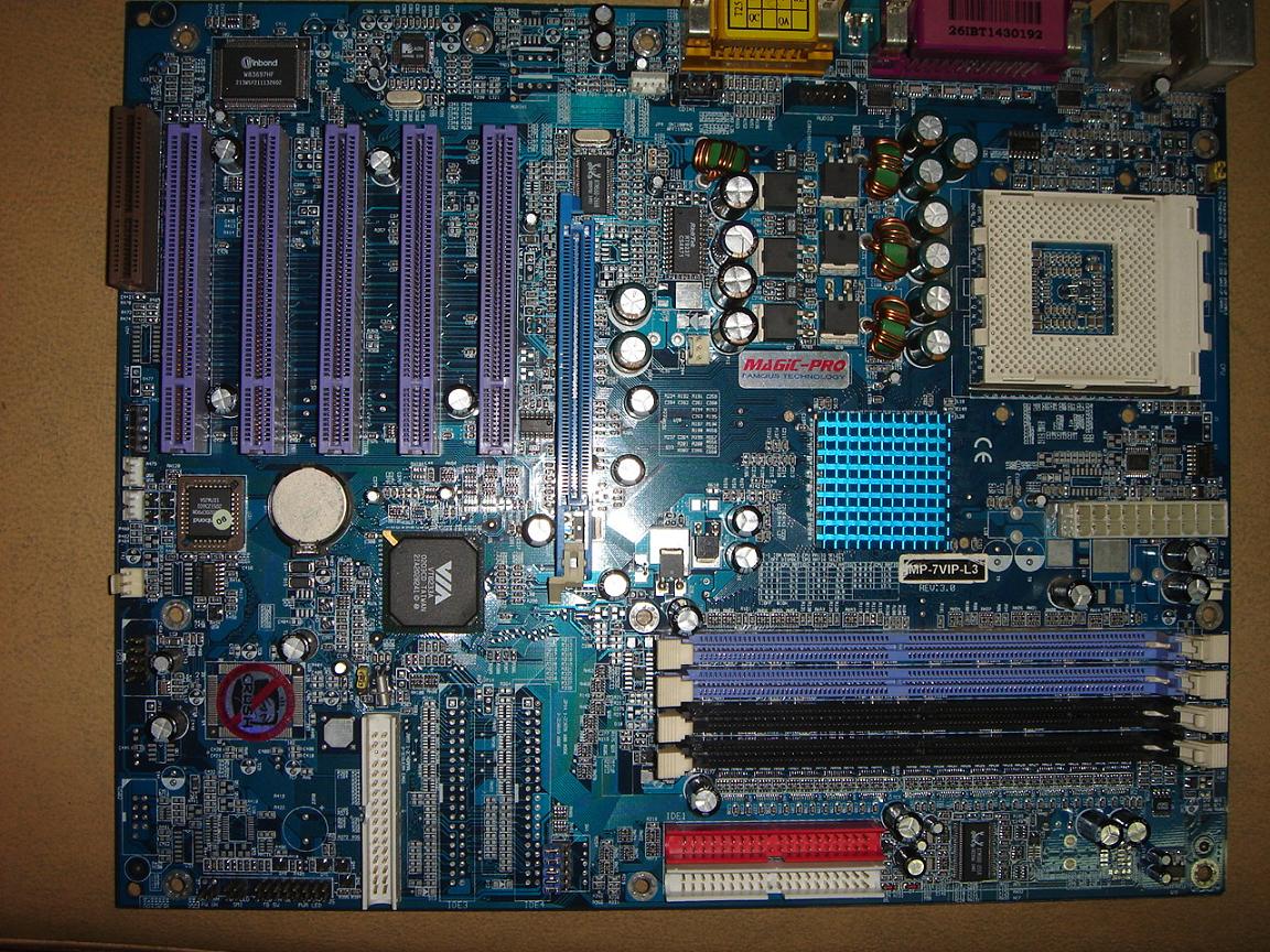

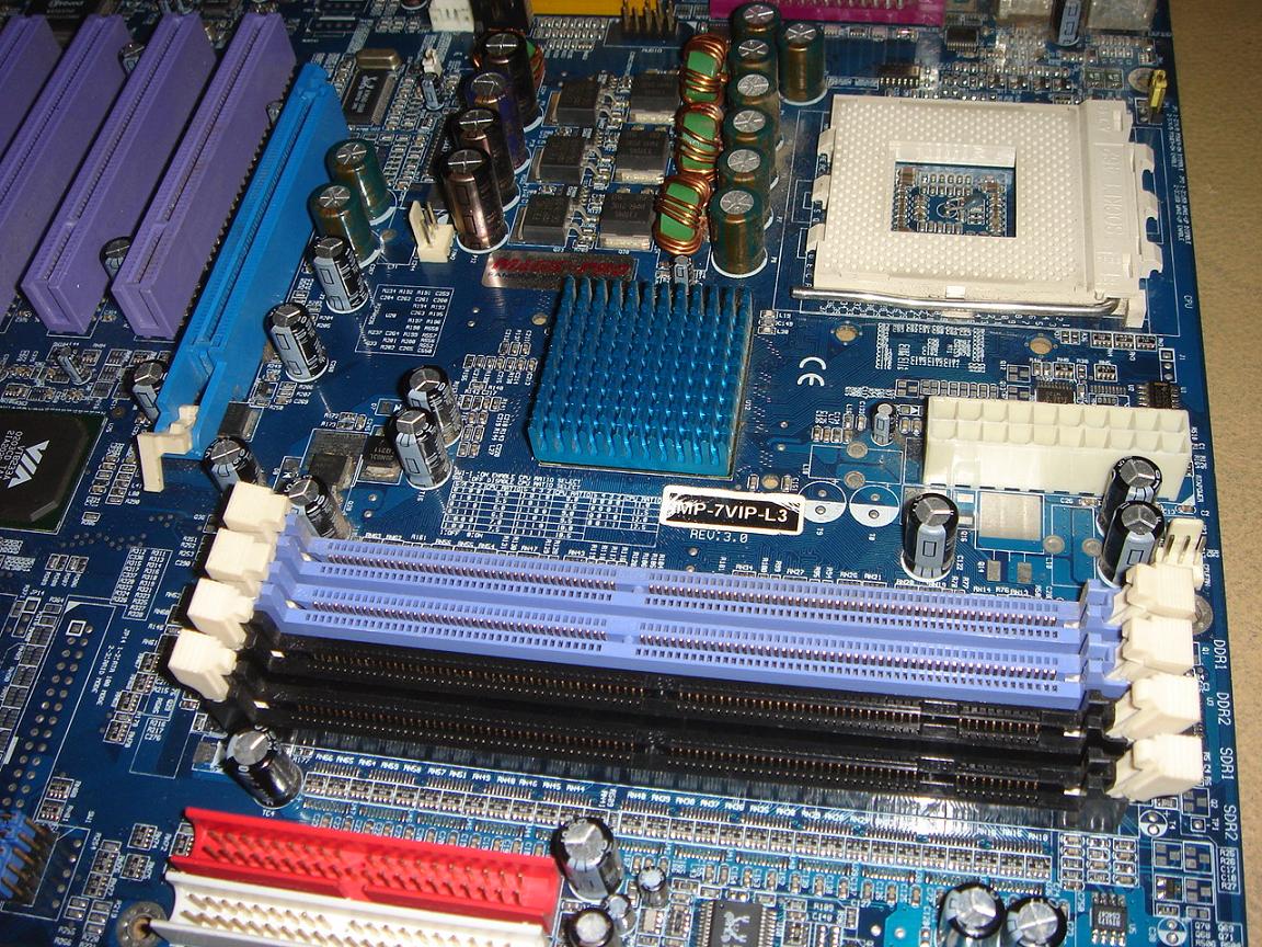

              Originally posted by starfury1
              Went looking fo a decent pic but didn't find one
              I forgot about the pic. I have some pics of the board that was previously posted in a different thread. The board still in the exact same condition as the picture I previously posted.... though it is a bit dusty now.
              The pics are about halfway down the page on the thread.
              https://www.badcaps.net/forum/showthread.php?t=3861
              [QUOTE=starfury1} If you can use 6V3 (red) then it must be a +5 volt VRM (I think)
              [/QUOTE]
              Starfury, you are definitely correct. The VRM is a 5V VRM because the board can be powered by an ordinary ATX PSU without the extra 12V CPU power cable.
              I can see in Phenos image that the board will be able to work with 2200uf caps on the VRM input. I will use the Panasonic FJ 2200uf caps I have left over from the PSU recap.
                Well if you got something better using them would be my preferred Idea.
                but as above They seem to be lasting in a P4 units VRM, which is mostly on
                you will just have to make sure you check them once in a while
                (keep the case well ventilated)
                Noticed on your pics the chip had a different number not that i've compared them
                (but considering they aren't going to revamp the MB design (unless they got no choice) its must be same dog different name)
                6301 20 pin......... 9237 28 pin device
                Here the PDF on the Richtek RT9237 Controller
                Grab it Stevo, have a read and keep it for reference.
